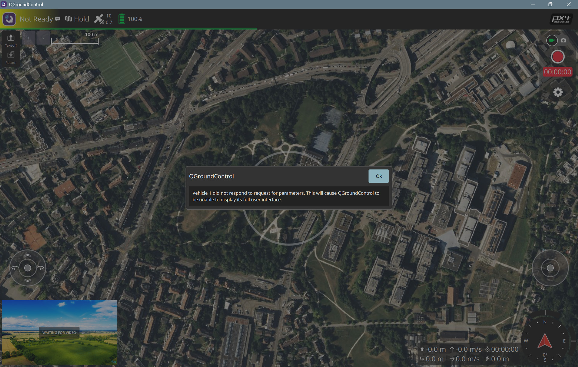

The problem appears in the reverse direction: QGroundControl replies to messages (e.g. PARAM_REQUEST_LIST) coming from PX4, but the bridge does not forward those messages back to PX4, so PX4 cannot reply correctly. I suspect there may be an issue related to UDP endpoints.
Has anyone implemented a MAVLink UDP proxy/bridge between PX4 and QGroundControl? Does PX4 require packets to come from a specific UDP endpoint or source port?
The following image shows what happens: QGroundControl initially displays vehicle information, but after a few seconds the message shown below appears.

m_udp is the socket used by the MOOS application to communicate with PX4, while m_udp_QGC is the UDP socket used to communicate with QGroundControl.
