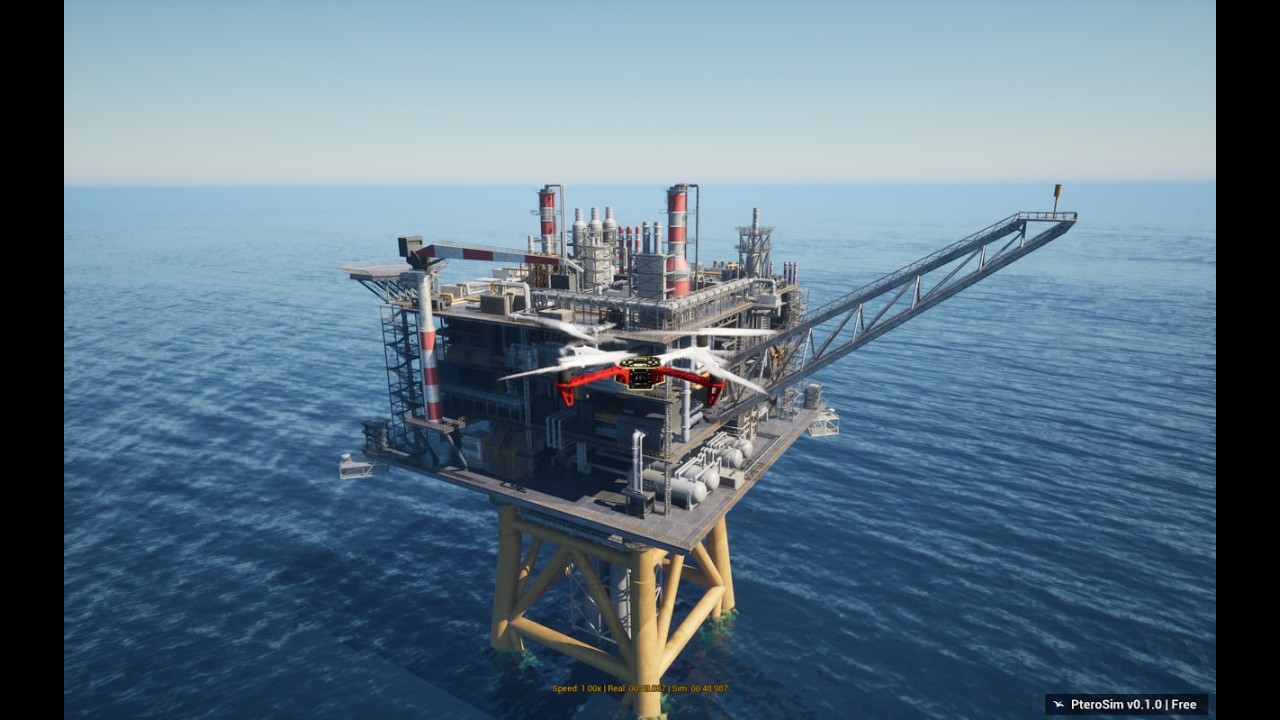

Lockstep engages once PX4 connects, so a run is repeatable instead of depending on how loaded the machine is. Here is what that looks like running:
