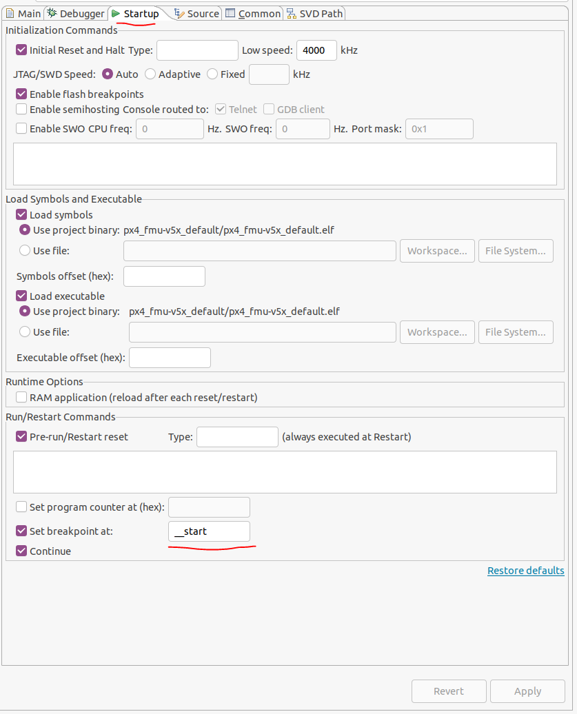

I have an idea of what it might be depending on tools and version. In the debug tabs; Change the breakpoint from main to __start .
Thanks @david_s5 for the fast answer! I have tried to find this option but couldn’t. The debug tab is the one on the left with the debugger shown it if I know correctly, but I cannot see option like this there. I also tried in the configuration of the debugger and the properties of the breakpoints.
I guess I missed something obvious, but can you give some detail how (in which menu) can I find it? For reference I upload here the screenshot of what I see in Eclipse (currently there is no breakpoint set).
Thanks a lot.
Sorry…there are a lot of settings in eclipse.
Thanks, I could find it now (I just started using Eclipse for this debugging purpose, so I am a beginner in handling it.). That actually helped, but it is still behaving strangely. On the second image you can see the breakpoints set, the debugger stops at the first, then I can step over to the second, but when I step over again it goes to and stops at line 1516. After that the program just start to run (with step over and step in, too) and does not stop at the third breakpoint.
I tried choosing “Resume”, and delete “run” command in the configurator, but it didn’t help.
I only use a segger jlink. Are you using a Jlink? Perhaps you need to configure it as such?
I am using Dronecode probe, that has some tutorial here, that is stating to choose the “GDB Hardware Debugging” configuration.
