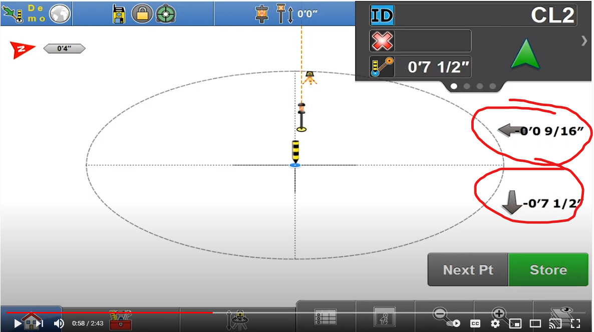

As the video progresses, at around 30secs into the video you will see a screen which is getting information from the fixed point of where the prism (drone) needs to be. This data I am looking to convert into code that a drone can use to locate the position. See also attached a pic of the screen where I have circled the directional data.
This data is all sent wirelessly, so I am hoping the same wireless hardware can be used for the drone…???
