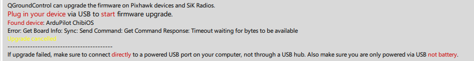

When trying to connect my ARK-FPV-FC to QGCto flash ArduPilot on I am getting this error, It is currently running Betaflight , What can i do to fix it? The USB cable is fine as I can view Betalflight and AM32 config , The drone is not powered with the battery and I tried messing with the COM ports and disabling all auto connect settings. Any help or suggestions would be great please

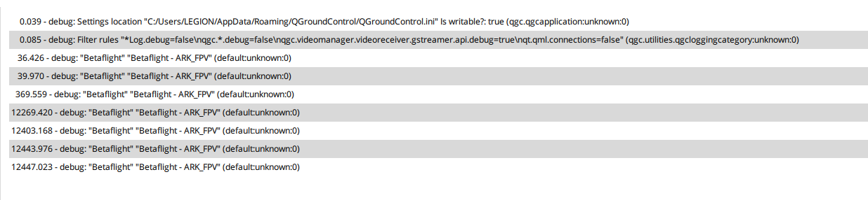

This is the console
We need more details.
  • Version of QgroundControl ?
  • On what system ? ,…Windows, Linux, Android,…
  • What version of the system? I.e. Windows 11, Ubuntu 24.04,…
