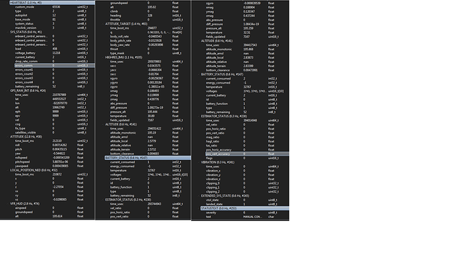

I’m interested in using a joystick connected to QGC as my primary means of control. It works fairly well except that it suffers from from some pretty bad latency. After further investigation I have found that this is due to collision avoidance in the 802.15.4 protocol that the radios use. Basically, only one of the two radios can be transmitting at once, so if the ground station detects that the drone is transmitting then it will wait for a moment of silence before sending its Manual Control packet. This would be fine if each of the two radios only intermittently transmitted, but it seems that the pixracer is constantly transmitting. I’ve managed to reduce this problem by tweaking the settings on the radio but I still occasionally get gaps in the Manual Control packets that last ~720ms. There are many ways that this problem could be solved but most of them would involve significant modifications to the way that MAVLink transmissions are handled by the firmware. I think the simplest solution would be to just reduce the amount of the information that the pixracer is broadcasting. From looking at the MAVLink inspector (image attached) it looks to me like at least half of the information being broadcasted is not necessary for normal operation.
Does anyone know what can be done to configure the pixracer for more “lean” transmissions? It seems, for logging purposes, like QGC should have the ability to request/unrequest certain types of information from the FMU.
