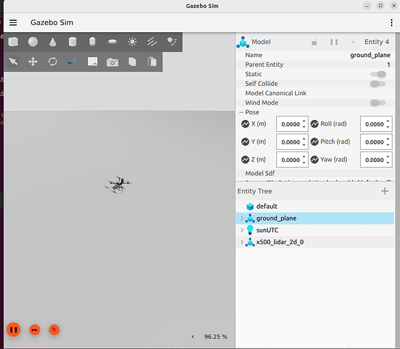

I am running
jetson@ubuntu:~/git/PX4-Autopilot$ make px4_sitl gz_x500_lidar_2d
I am trying to zoom in and out in Gazebo GUI. I am not able to do that. Would you please help me how I would do that?
Mustafa
I am running
Mustafa

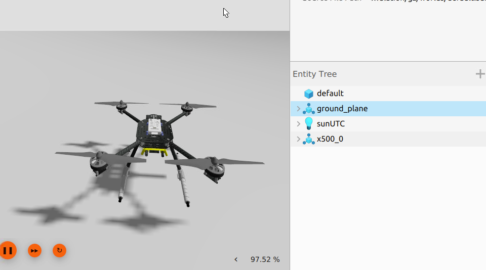

You have to hit ESC and kinda click around. It’s because the camera is configured to follow the drone.
Hi @dakejahl Thank you. ESC worked. I was able to pan and zoom around.
Thanks for your help.
