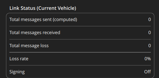

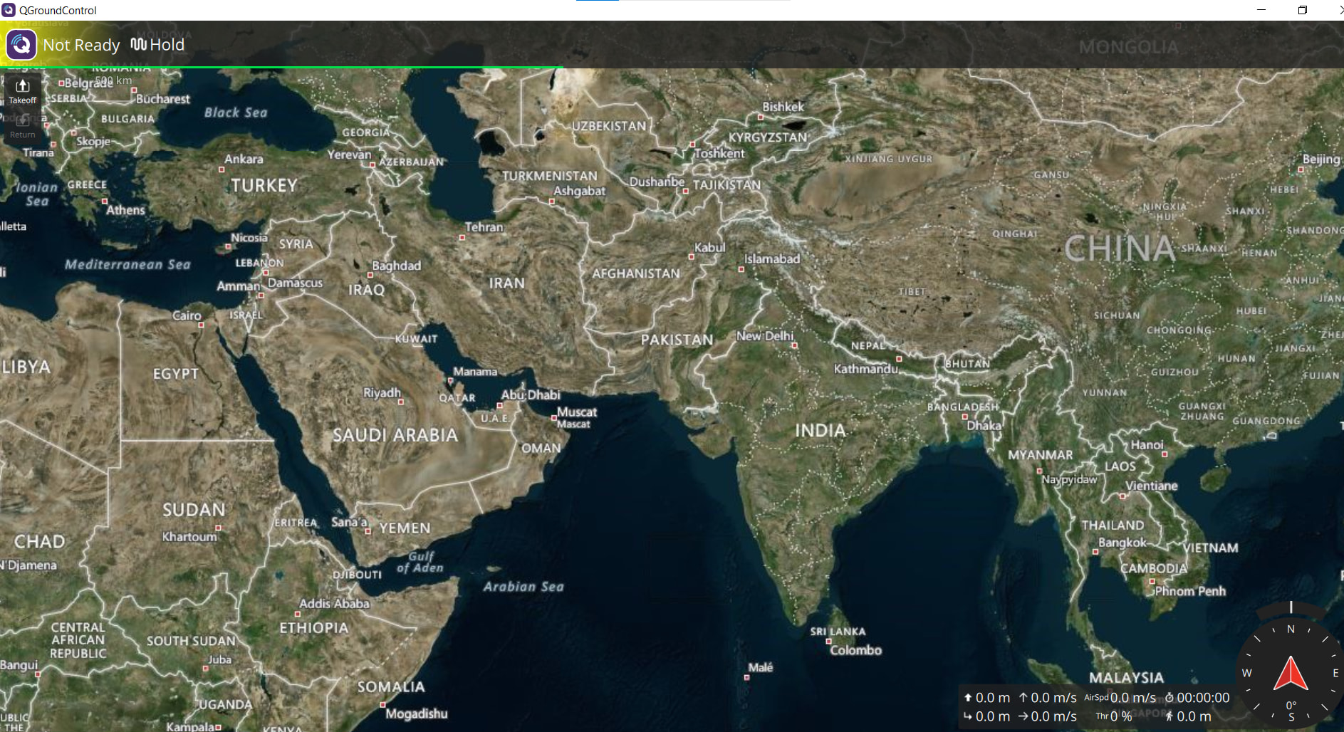

![image](https://discuss.px4.io/uploads/default/original/3X/1/2/128d6245dd278ac34e49776932e2690fd0d7d7bf.png)
 ![image](https://discuss.px4.io/uploads/default/original/3X/e/5/e5f2f994d9590efea4e5985f511881147890da78.jpeg)
As you can see in this picture, the loading are just stucked. The 93% loss is now gone as you can see there is no packet send or received.

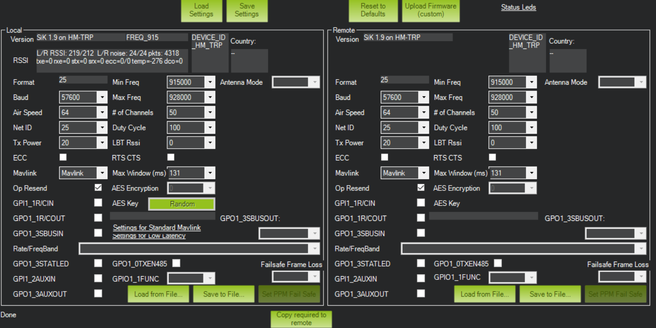

here is my radio setup viewed from MP
 ![image](https://discuss.px4.io/uploads/default/original/3X/6/d/6da4808b355ec09501fc111e67e9dc2e54e36342.png)
Originally I had cts and rts wiring connected to each other but now I removed them completely. That’s the only change I’ve done as my yrrc air module has only 4 pins (RX,TX,VCC,GND) but pixhawk has 6 pins for telem1

Thanks for the additional screenshots and wiring details. The CTS/RTS information is particularly important.
The QGroundControl status now showing zero messages sent, zero received and 0% loss does not demonstrate a healthy connection. It means no message loss is being counted in that view, so we first need to establish whether MAVLink communication is actually taking place.
Your SiK configuration screenshots also appear to show RTS/CTS disabled on both radios.

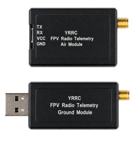

Since your air radio exposes only RX, TX, VCC and GND, I would focus on the serial interface before replacing hardware.

This is my radio
 ![image](https://discuss.px4.io/uploads/default/original/3X/4/8/482bf70cbc69edde21948c80e66711856264a632.jpeg)
“One additional point: please check the PX4 serial hardware flow-control setting for the MAVLink instance assigned to TELEM1, if that setting is available in your build. A radio without CTS/RTS support should not be paired with a UART configuration that requires hardware flow control.”
How to do this?
The physical wiring is correct I guess as the orientation is changing in QGC when I move the pixhawk.

**2. Inspect radio-link diagnostics**
Check whether the SiK radios expose packet error counters, RSSI, noise levels or retransmission statistics.
A successful radio pairing does not necessarily mean the data link is reliable.

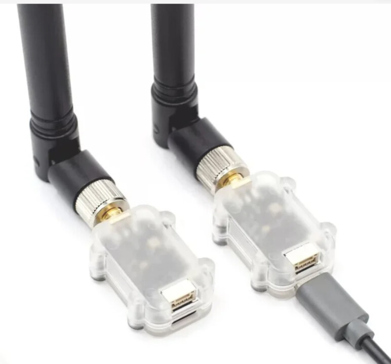

On second note, I tested another telemetry called **MicoAir LR900-P 890-915MHz 1000mW 30dBm Data Transmit Module**
 ![image](https://discuss.px4.io/uploads/default/original/3X/c/5/c52f4a132512747114e6a6085c7bc2573f2efb62.jpeg)
I am facing the same issue in this telemetry also which was running good few weeks back.

Hi Samim,
Thanks for sharing the photo.
Since you have experienced the same issue with both the YRRC and MicoAir telemetry systems, I think we should first isolate the common hardware and configuration elements before proceeding with serial traffic capture.
Could you please confirm three things?
1. Did you use the same Pixhawk TELEM1 cable with both telemetry systems, or did each radio have its own cable?
2. Were both air modules powered directly from the Pixhawk TELEM1 connector?
3. Could you share a clear photo of the Pixhawk-side connector and the air-module wiring, showing the pin assignments for TX, RX, VCC and GND?
Please do not change the wiring or connect the USB-to-UART adapter yet. We should verify the connector pinout and voltage compatibility first.
Once these details are confirmed, we can establish a safe, receive-only serial capture procedure and investigate the communication failure systematically.
Best regards,
Yiğitcan Öztürk
PAMILANGA LTD
