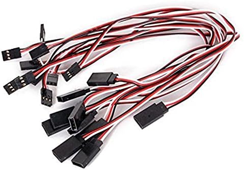

I used these and cut off one end.
> **[Amazon.com: HONBAY 10Pcs 300mm Remote Control Servo Extension Cord Cable Male to...](https://www.amazon.com/HONBAY-Remote-Control-Extension-Airplanes/dp/B01LA9YDEI/ref=sr_1_3?dchild=1&keywords=30%2BPieces%2B3-Pin%2BExtension%2BCable%2BCord%2BMale%2Bto%2BFemale%2BLead%2BWire%2BConnectors%2Bfor%2BServo%2BExtensio&qid=1607541886&sr=8-3)**
> Buy HONBAY 10Pcs 300mm Remote Control Servo Extension Cord Cable Male to Female Servo Extension Lead Wire Cable for RC JR Futaba RC Car or Airplanes: Servo Plugs & Wires - Amazon.com ✓ FREE DELIVERY possible on eligible purchases
As I said solder servo plugs so that ‘1’ on the ESC goes to the signal pin of the servo plug and then plugs into the servo connector on the mini. Same for 2,3,4. On the first servo plug connect the ground to the Ground pin on the ESC, then you can just connect the signal wire on the reset of them.
