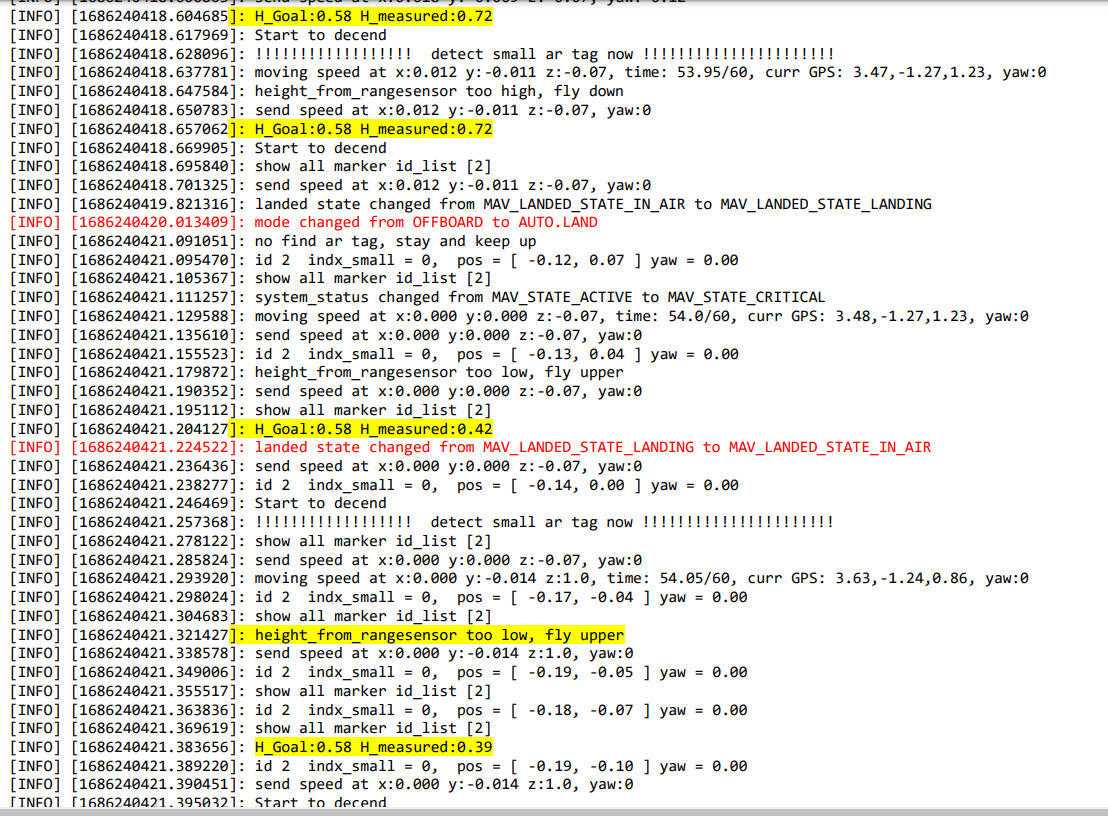

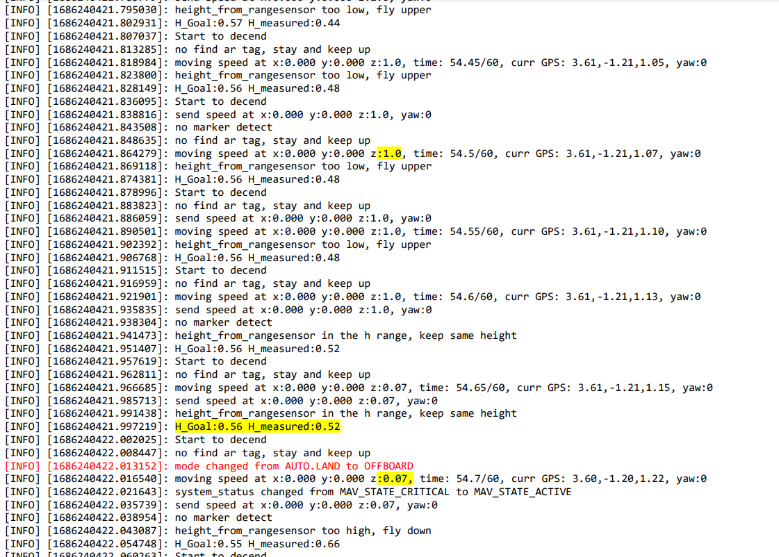

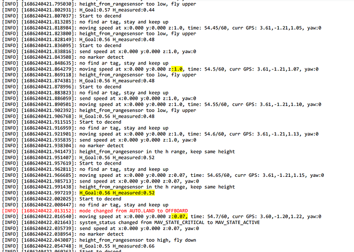

At the time stamp: from **1686240419** to **1686240422**
the unexpected switch mode behavior makes the drone fall suddenly, when it was from offboard mode to AUTO.LAND mode.
When it resumes from AUTO.LAND mode to offboard mode, the drone spikes suddenly.
In the **python** script terminal,
 ![image](https://discuss.px4.io/uploads/default/original/2X/7/7a9ed9f6839af2a867b753b2ccd2c86db8875437.png)
 ![image](https://discuss.px4.io/uploads/default/original/2X/d/d9d858c4a448c8c0a09cf908b63adaaa61c5db79.png)

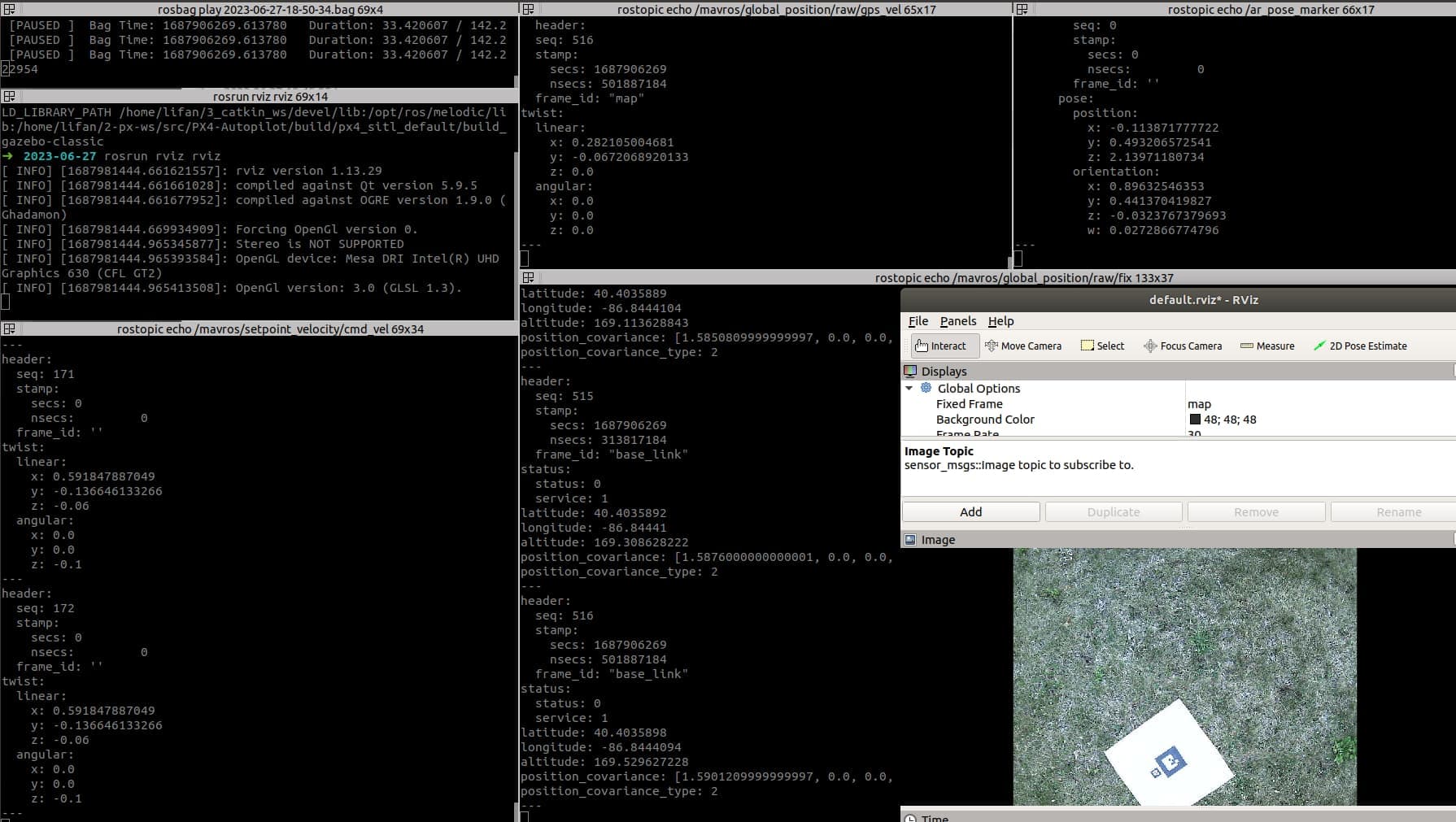

In the [rosbag](https://purdue0-my.sharepoint.com/:u:/g/personal/wu1714_purdue_edu/Eas8ArBvphtAmf_GklN0ZtgBmvDMYRjDZoSYEwMyQG-SVA?e=yGjRtb) record:
 ![image](https://discuss.px4.io/uploads/default/original/2X/3/3b308354f601ca3b94fb91a7f46dbcd09f9669cc.jpeg)

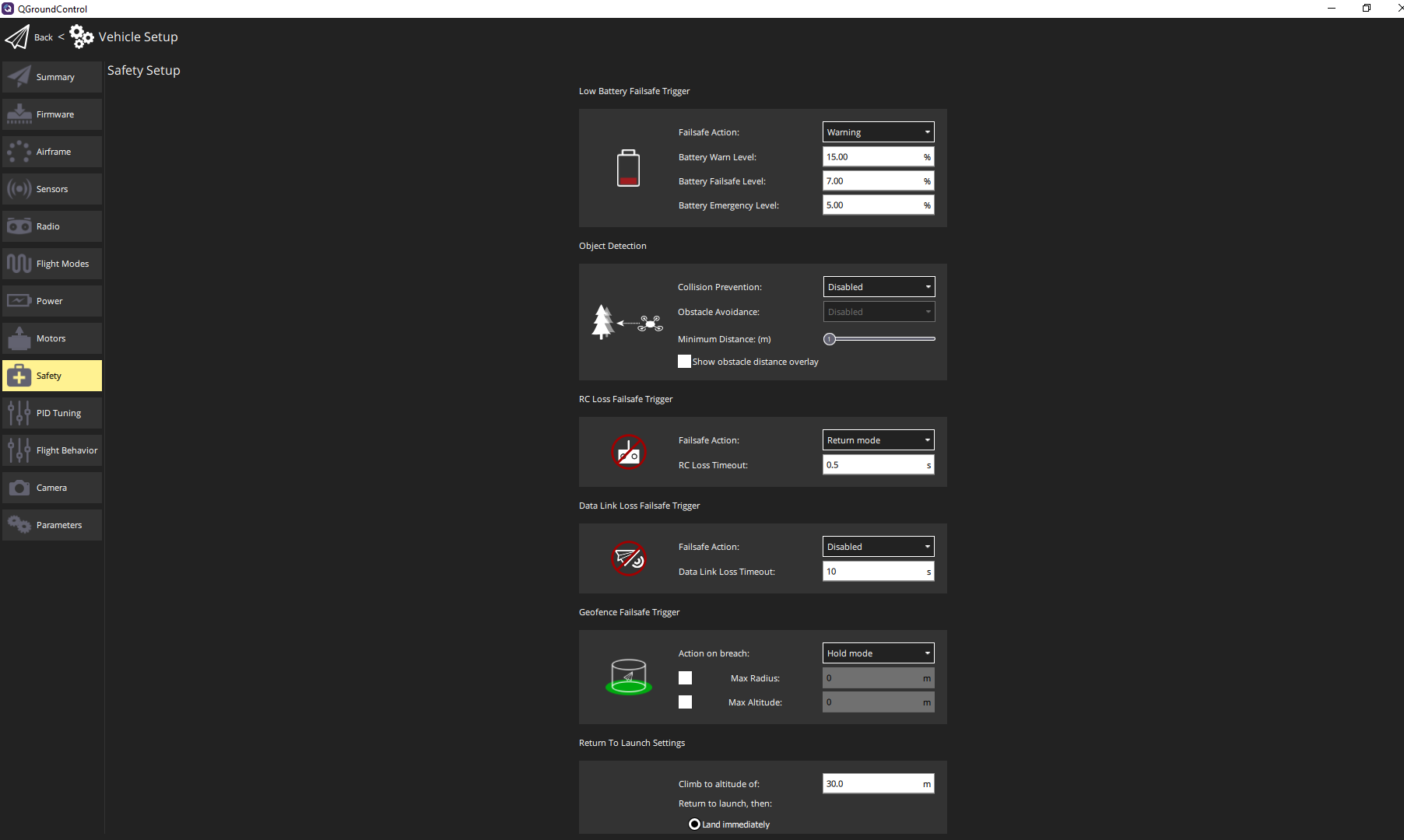

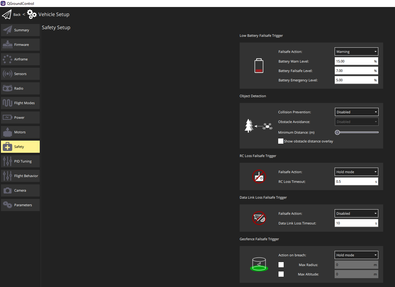

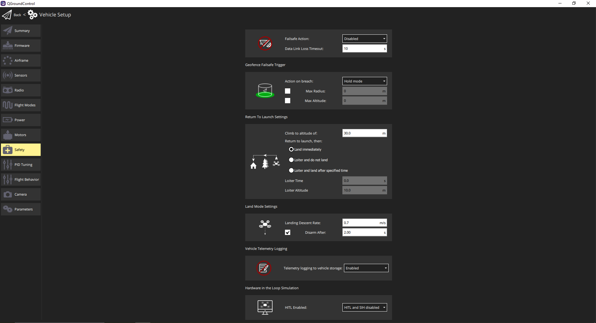

I also suspect my fail safe setting is like this
 ![image](https://discuss.px4.io/uploads/default/original/2X/5/59d4a44e5a5a5d47efc75e540e94c615fe766c27.png)
 ![image](https://discuss.px4.io/uploads/default/original/2X/a/adfb97f773136d9fec69c04bc7332db99f0fe819.png)

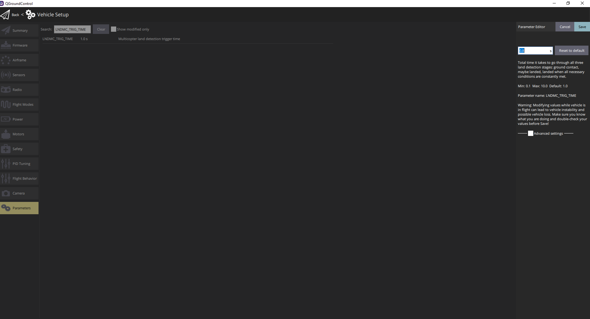

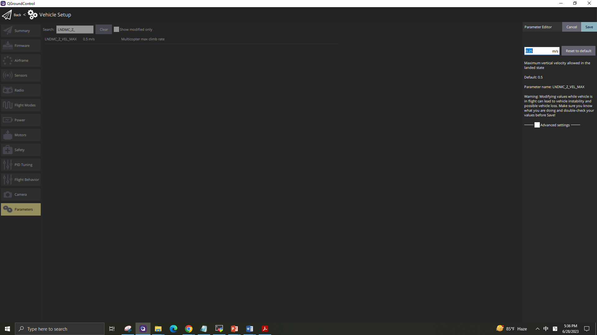

There are two parameters which determine the landing scenario - LNDMC\_XY-VEL\_MAX and LNDMC\_Z\_VEL\_MAX …Kindly try adjusting this to a lower value and report here … Also LNDMC\_TRIG\_TIME . …
**Author:** ![AlexWUrobot](https://discuss.px4.io/user_avatar/discuss.px4.io/alexwurobot/32/11387_2.png) [@AlexWUrobot](https://discuss.px4.io/u/AlexWUrobot)\
**Post date:** [June 28, 2023, 7:51pm UTC](https://discuss.px4.io/t/why-does-drone-suddenly-switch-auto-land-mode-from-offboard-mode-when-descending-failsafe-enabled-no-offboard/32639/4 "2023-06-28T19:51:59Z")
Thank you very much for the information.
It is very helpful.
 ![image](https://discuss.px4.io/uploads/default/original/2X/2/2786ed22738861b94a962d7ed27a2c50116d1d14.png)
According to the document, `LNDMC_XY_VEL_MAX` and` LNDMC_Z_VEL_MAX` are to set the max velocity allowed landed state.
Thus, if decrease the value, maybe the drone may never land, because the drone flies at the speed over the `VEL_MAX`?

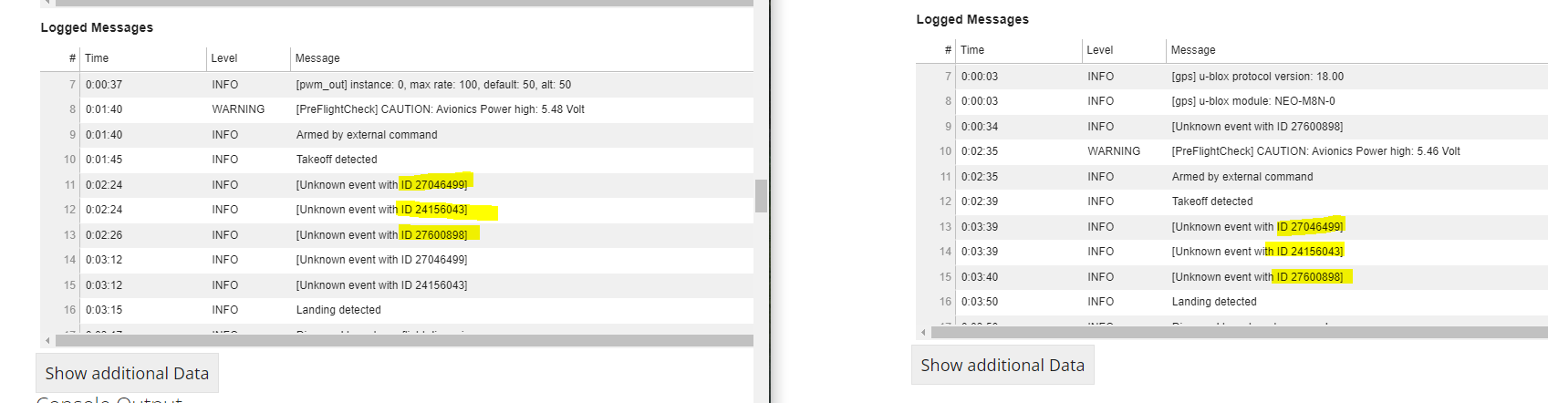

I found the
```auto
Unknown event ID 27046499
Unknown event ID 24156043
Unknown event ID 27600898
may be the cause.

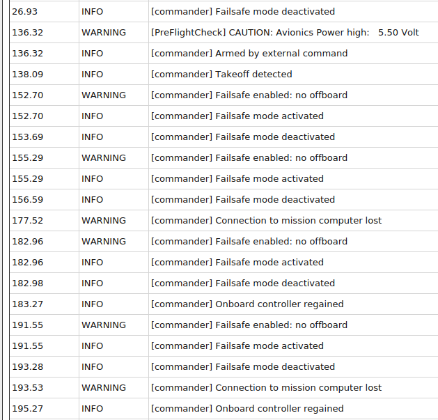

The error is Failsafe enabled: no offboard
 ![GPS Reinforcement Learning for Drone Landing _ for future paper](https://discuss.px4.io/uploads/default/original/2X/a/a6193673e46496834c82c637fce7d36f191b2c82.png)

hi @AlexWUrobot
The `Failsafe enabled: no offboard` is triggered when you loose offboard control, it could be caused by some delay on your ROS 2 side or some bottleneck on the serial communication,… or something else.
You are landing because that is the failsafe behaviour imposed by `COM_OBL_ACT `.
Now you have to debug why you loose connection.

A snapshot of your descent flight is this:
 ![image](https://discuss.px4.io/uploads/default/original/2X/7/772785361150a5abdcb215c4804ed865129f2081.png)
The offboard control is running on MAVLINK 1, Telem2, and you have a ttl2USB adapter.
I see two possibilities:
1- your code is running correctly, but there is an issue on the serial link
2- the serial link is ok but for some reason your code does not send the commands with correct timing.
As there is also `[commander] Connection to mission computer lost` which means that even the telemetry is not coming… a mavros issue then.
But if you are hovering… no issues! 🤷‍♂️

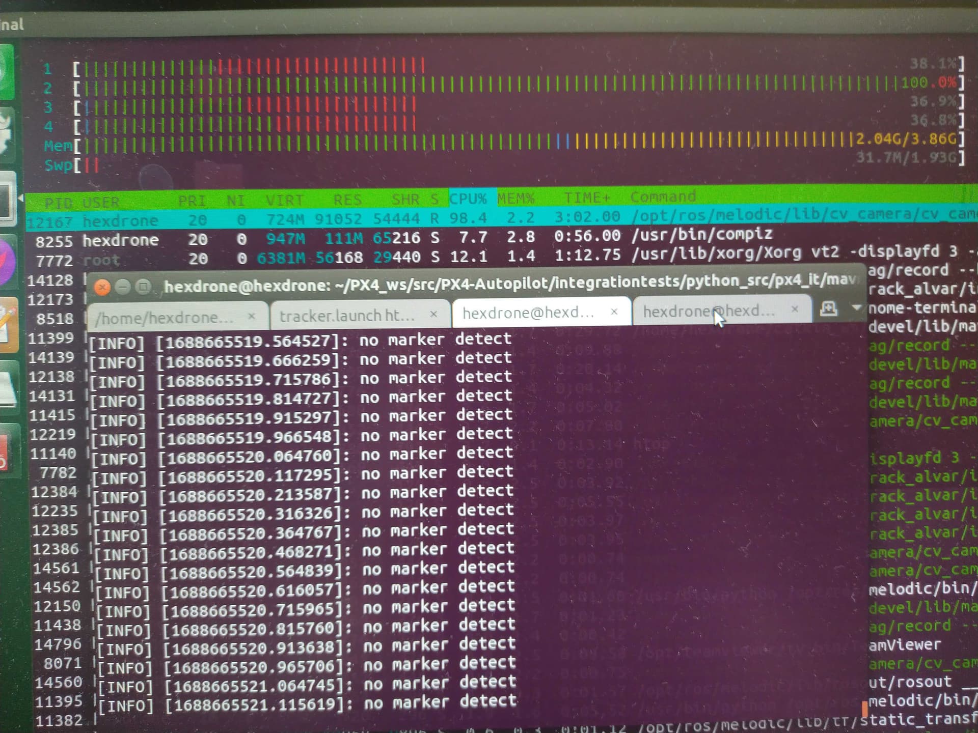

Are you overloading your companion computer in the descending phase?
**Post date:** [June 30, 2023, 7:32pm UTC](https://discuss.px4.io/t/why-does-drone-suddenly-switch-auto-land-mode-from-offboard-mode-when-descending-failsafe-enabled-no-offboard/32639/9 "2023-06-30T19:32:26Z")
Dear Benja:
Thank you very much for the detailed explanation.
There is my system overview. Yes, I connect Pixhawk to Jetson Tx1 through the TTL-232R-USB cable.
 ![GPS Reinforcement Learning for Drone Landing _ for future paper](https://discuss.px4.io/uploads/default/original/2X/8/8d08bf685f5342144f71983eaeb3147fd02732cc.jpeg)
 ![image](https://discuss.px4.io/uploads/default/original/2X/c/c4fc5a163d3707fa597d30c884037dd4ec7235e5.jpeg)
I have the rosbag record and a camera running on the Jetson TX1.
Besides the [log](https://logs.px4.io/plot_app?log=5dd13282-f036-4b2c-b369-5b9360487865) and [code](https://github.com/AlexWUrobot/drone_landing_strategy/blob/1b13f57c6a1a040914dca2303e4fc466a7c19e3a/June_8_20hz_land.py) for descending, I also run the **rosbag record** and **python script** in terminals.
The python script running in the terminal shows the “unexpectedly **mode changed from offboard to AUTO.LAND** ”, at the timestamp 1687906269.
There is the full [terminal record](https://purdue0-my.sharepoint.com/:f:/g/personal/wu1714_purdue_edu/EhW0Ta-LVuBKseRJfjDxJ2UBaj90CsU0a9UIoukKb2jjXA?e=LvKSlg)
 ![image](https://discuss.px4.io/uploads/default/original/2X/a/a790093cb9a24ec4a219e731e4fefd1204e3539e.png)
However, the rosbag also looks ok, at the timestamp 1687906269.
There is the full [log video](https://youtu.be/EPPMH336Edk) and [rosbag file](https://purdue0-my.sharepoint.com/:u:/g/personal/wu1714_purdue_edu/EdNTyJ4qZXNGuWRdpkW-yFIBmybOKTpjWjt9QoTP6qslhg?e=r5ktKQ).

And the issue started to happen on
[log\_178\_2023-5-21-21-37-46](https://logs.px4.io/plot_app?log=2c4a1437-c11b-4b55-80ae-908cfe534a4d)
 ![image](https://discuss.px4.io/uploads/default/original/2X/8/830070fa23cdbd4f171980e8eaafebe297b02298.png)
Compared to the setting,
I suspect the value of baud rate may affect the connection of the companion computer.
 ![image](https://discuss.px4.io/uploads/default/original/2X/e/e4ad75eb70d5288eee7a88e9d94105fcd575d0d4.png)

I further completed eight flights.
log323~326, set (SER\_TEL2\_BAUD: 921600)
[log323](https://logs.px4.io/plot_app?log=a1a4f8c2-0507-4845-b164-26a387509d61), manual (RC control)
[log324](https://logs.px4.io/plot_app?log=27cb9b22-b612-46cf-96f7-611e1eca1119), Feb\_12\_twoTag (timestamp = 1688593134.568808) (MAV\_1\_RATE:115200) (issue happens)
[log325](https://logs.px4.io/plot_app?log=b4aa9e44-695d-49a6-af05-312b99ff495c), Feb\_12\_twoTag (timestamp = 1688593848.701527) (MAV\_1\_RATE:60000)
[log326](https://logs.px4.io/plot_app?log=92a83226-156d-4f72-a2ba-06cbc7a770cc), Feb\_12\_long.py (timestamp = 1688594073.086129) (MAV\_1\_RATE:60000) (issue happens)
Suddenly, I met an issue “[TM : RTT too high for timesync](https://discuss.ardupilot.org/t/rtt-too-high-for-timesync-with-sitl-mavros/38224/2): 0.0”
solved it by set timesync\_rate to 0.0 in the file `/catkin_ws/src/mavros/mavros/launch/px4_config.yaml`
and then keep testing the issue (Failsafe enabled: no offboard)
log327~330, set (SER\_TEL2\_BAUD:115200) (MAV\_1\_RATE: default 0)
[log327](https://logs.px4.io/plot_app?log=81e637f5-3ef2-46fc-8e71-b5d265c14058), Feb\_12\_twoTag (timestamp = 1688597156.887726)
[log328](https://logs.px4.io/plot_app?log=49f9ca27-be03-495b-ba05-c9cea8399c6d), Feb\_12\_long.py (timestamp = 1688598109.500374)
[log329](https://logs.px4.io/plot_app?log=73da0101-cb68-41ae-b441-8561b548ac66), June\_8\_20Hz\_land.py (‘date and time=’, ‘05/07/2023 19:06:38’) (issue happens)
[log330](https://logs.px4.io/plot_app?log=71de2646-405c-41ea-a15b-d23f97084d9b), June\_8\_20hz\_land.py (‘date and time=’, ‘05/07/2023 19:16:45’)
I suspect the rosbag record may overload the Jetson TX1 and sometimes causes the connection unstable?
There is the screenshot of the htop.
The 2nd CPU threads is 100%.
 ![image](https://discuss.px4.io/uploads/default/original/2X/2/2ee538216ac979e9fa77a2b0260801a331bbdc67.jpeg)
**Post date:** [September 13, 2023, 9:37pm UTC](https://discuss.px4.io/t/why-does-drone-suddenly-switch-auto-land-mode-from-offboard-mode-when-descending-failsafe-enabled-no-offboard/32639/12 "2023-09-13T21:37:54Z")
I guess the reason is that rosbag record the camera video put too much pressure on Jetson TX1.
After I do not record the rosbag. the issue seems less happening.
