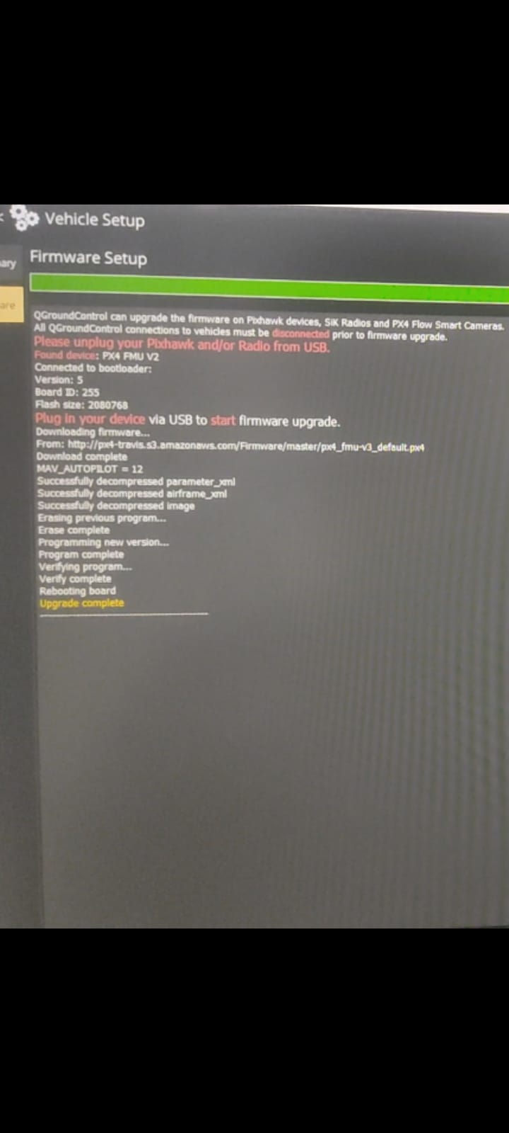

Hello, I have a **Pixhawk 2.4.8** and I’m experiencing some issues. My board frequently shows _ **sensor errors** _ , and I believe I need to upload a different firmware version to fix these problems.
Currently, the firmware version shown in **QGroundControl** is **1.15.4** , and the board is detected as **FMUv2**. However, when I attempt to update the firmware—similar to what is described in this discussion:
> **[Pixhawk 2.4.8 Firmware?](https://discuss.ardupilot.org/t/pixhawk-2-4-8-firmware/53185/10)**
> Hello, Thanks to all the contributors, their help proved extremely useful! I found this thread searching for a solution to upgrade two boards that refused to be recognized by the mission planner firmware update tool. I have no tools to know why...
—it still installs **FMUv3** , even though my hardware is **FMUv2**. After flashing, the **vehicle version** still shows **FMUv2** , not FMUv3, even though FMUv3 was supposedly uploaded.Like screenshoot below.
When I try to follow the suggestion from the link to update the **bootloader** using the **SYS\_BL\_UPDATE** parameter, I cannot find this parameter in my system. It simply doesn’t appear in QGroundControl.
So my questions are:
1. Are **v1.15.4** and **FMUv3-FMUv2** just different labels for the same firmware, or are they **truly different firmware targets**?
2. How can I ensure that the **correct firmware** is flashed to my **Pixhawk 2.4.8**?
3. What is the **most stable and reliable PX4 firmware version** for Pixhawk 2.4.8, especially for use in **fixed wing vehicles**?
If there is a **custom or legacy firmware** specifically built for boards like Pixhawk 2.4.8, I’d appreciate it if someone could share a **direct link** or explain how to compile or download it manually.

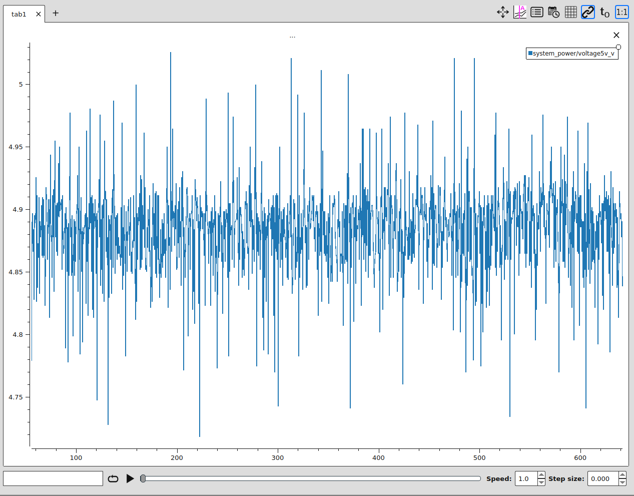

**Author:** ![dakejahl](https://discuss.px4.io/user_avatar/discuss.px4.io/dakejahl/32/20420_2.png) [@dakejahl](https://discuss.px4.io/u/dakejahl)\
**Post date:** [May 20, 2025, 9:50pm UTC](https://discuss.px4.io/t/what-is-the-updated-and-stable-px4-release-for-pixhawk-2-4-8/45659/6 "2025-05-20T21:50:40Z")
It looks like your 5V input voltage is unstable. Which power module are you using? Since 1.15 the low voltage check has been reduced from 4.8V to 4.7V, however your 5V input is very noisy.

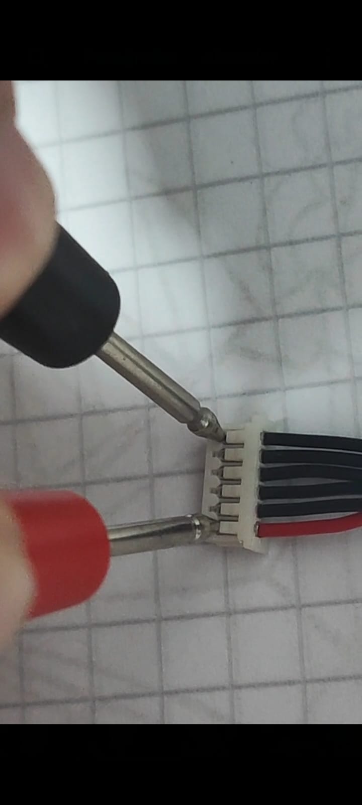

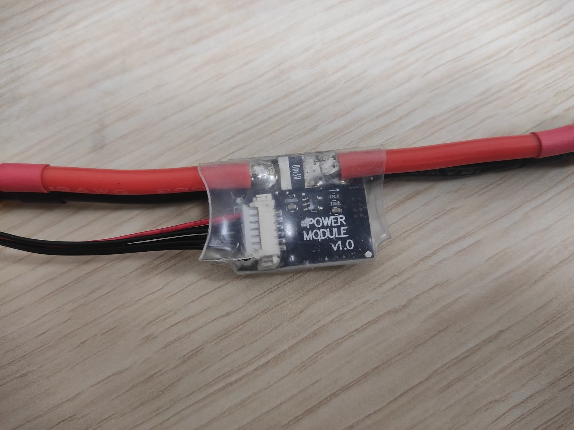

**Post date:** [May 22, 2025, 3:20pm UTC](https://discuss.px4.io/t/what-is-the-updated-and-stable-px4-release-for-pixhawk-2-4-8/45659/9 "2025-05-22T15:20:28Z")
I’m using a **Pixhawk 2.4.8** with a **Power Module v1.0**.
I measured the **voltage at the Pixhawk power input** using the multimeter shown in **Photo 2** , and I got a reading of **5.26V**.
The battery I’m using is a **4S1P 22000mAh LiPo** , nominal voltage **14.8V**. During the measurement, the battery voltage was **16.36V**.

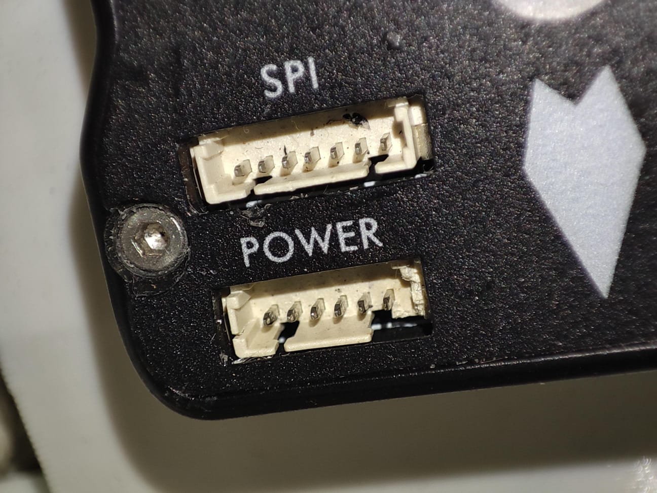

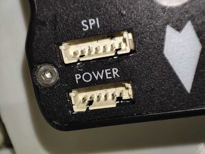

Additionally, I want to note that the **power socket on my Pixhawk** is **physically damaged** , as shown in the attached photo.
I’m wondering if that could also be contributing to the issue.
**Post date:** [May 22, 2025, 6:21pm UTC](https://discuss.px4.io/t/what-is-the-updated-and-stable-px4-release-for-pixhawk-2-4-8/45659/10 "2025-05-22T18:21:40Z")
The power monitor is analog, the noisy voltage is likely just noise. Although it’s possible the 5V output has ripple that a DC measurement on your multi-meter isn’t going to see. You can bypass the power errors by setting CBRK\_SUPPLY\_CHK.
The compass inconsistent usually indicates a poor/missing calibration or an incorrect rotation between the internal and external magnetometer.
The height estimate not stable would indicate noisy sensor data from either your baro or GPS or both.
To be completely honest this hardware is cheap and of very low quality and I would recommend using higher quality components if your budget allows. It will save you a lot of headache.
