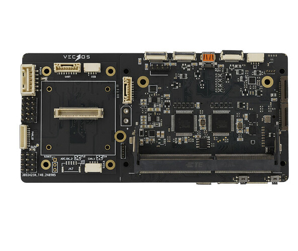

JETCORE FC is a single board that combines the AI processing power of a Jetson carrier board with the flight and sensor interfacing of a Cube Autopilot compatible flight controller. One PCB. One mounting footprint. 55 grams. The companion computer and the flight controller are the same board.

 ![JETCORE_FC](https://discuss.px4.io/uploads/default/original/3X/2/9/292716b1a06851d86ce1fe50029391e743997b68.jpeg)

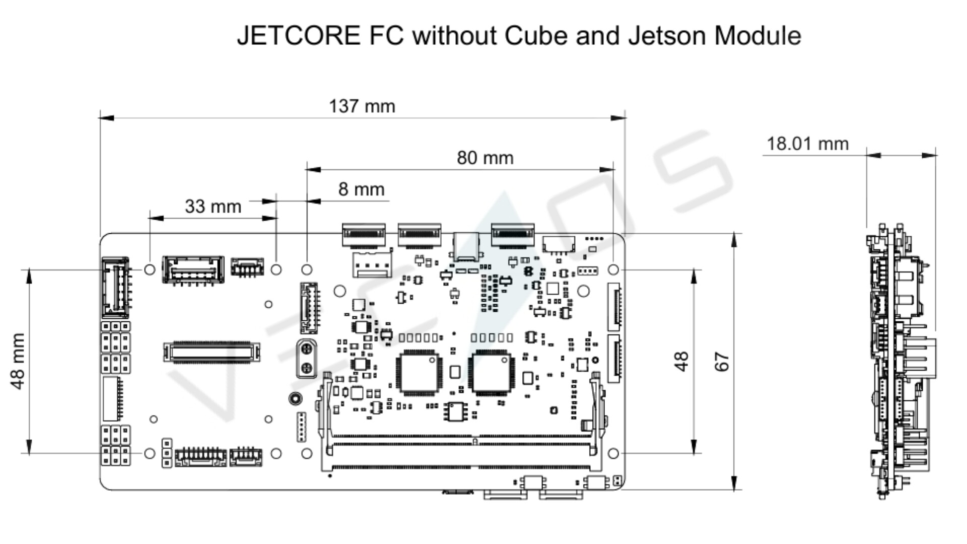

| Dimensions | 136mm × 66mm × 16mm |
| Weight | 55 grams |

 ![Jetcore_FC_Dimension_2_Watermark](https://discuss.px4.io/uploads/default/original/3X/f/7/f701a2386724fce00a65006f5ac940c229f84f1c.jpeg)
