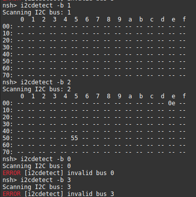

**Author:** ![ning](https://discuss.px4.io/letter_avatar_proxy/v4/letter/n/b5e925/32.png) [@ning](https://discuss.px4.io/u/ning)\
**Post date:** [July 15, 2023, 9:40am UTC](https://discuss.px4.io/t/vl53l1x-cannot-connect-to-pixhawk/33262/5 "2023-07-15T09:40:39Z")
I have scanned all I2C buses, but since the I2C expansion board I purchased has not yet arrived, I can only insert one device at a time. When inserting GPS with a magnetometer, the scanning results are as follows:
 ![图片](https://discuss.px4.io/uploads/default/original/2X/f/f05785806ae4673e9178611c98cdebfc197262af.png)
When inserting vl53l1x, the scanning results are as follows:
 ![图片](https://discuss.px4.io/uploads/default/original/2X/9/96ee9b9825829df878fe97ae2726a8b88eccccfd.png)
So I think there may be some issues with my vl53l1x sensor, or there may be a problem with the circuit, and I will check it.
If you have any other ideas, I hope you can provide them to me. Thank you for your help.
**Author:** ![Igor\_Misic](https://discuss.px4.io/user_avatar/discuss.px4.io/igor_misic/32/13536_2.png) [@Igor\_Misic](https://discuss.px4.io/u/Igor_Misic)\
**Post date:** [July 15, 2023, 9:53am UTC](https://discuss.px4.io/t/vl53l1x-cannot-connect-to-pixhawk/33262/6 "2023-07-15T09:53:14Z")
Yes, definitely it doesn’t communicate with the flight controller and this is basic I2C communication (it doesn’t have to do anything with drivers or other software that is needed).
This is the first thing to solve, later you will maybe have an issue with the drivers, but first, take care of this.
