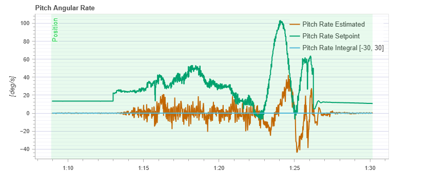

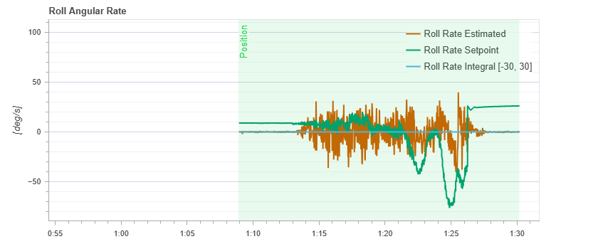

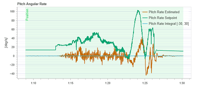

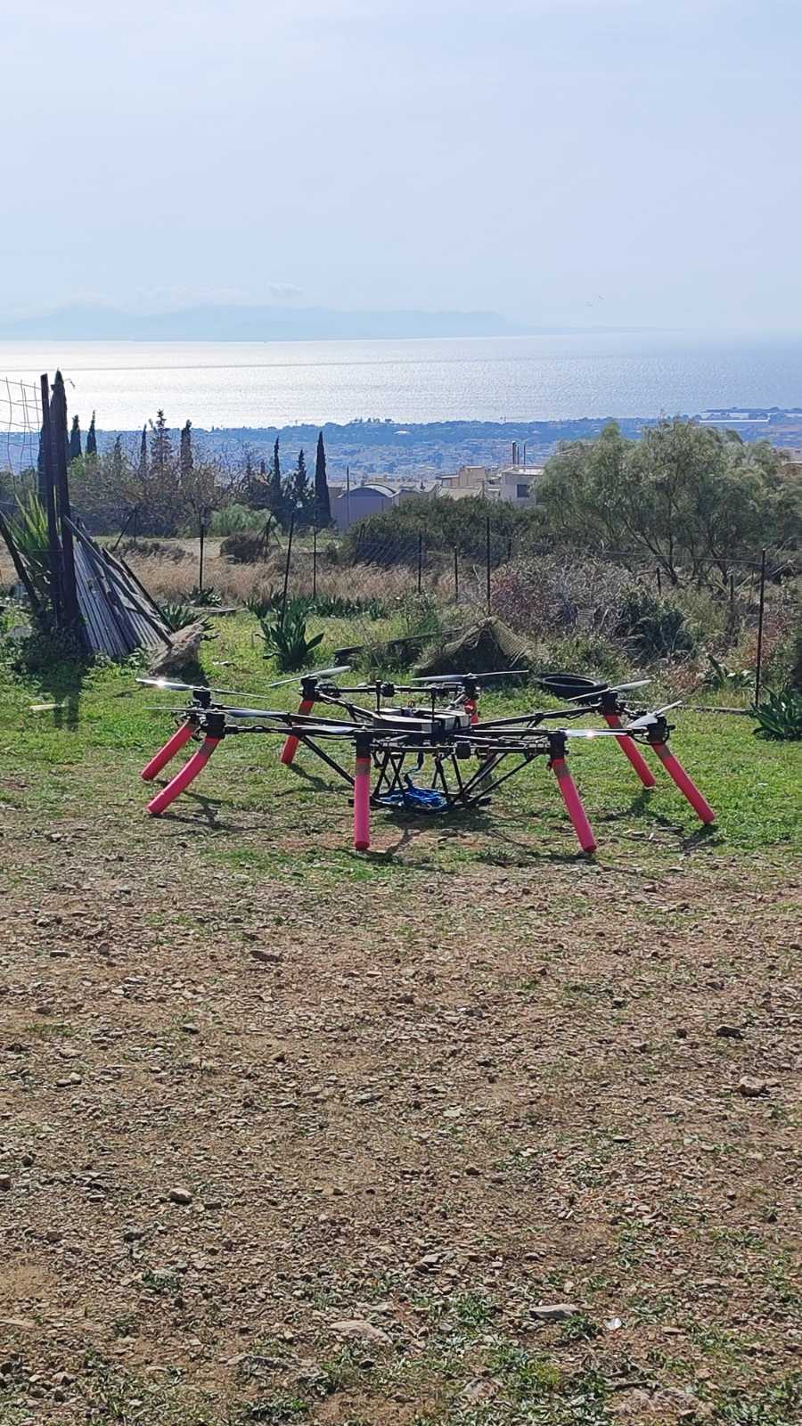

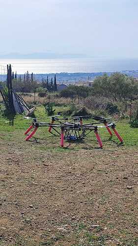

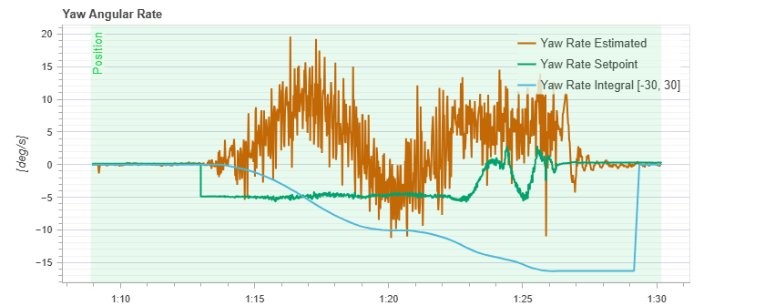

Hey guys, our team haw recently built a large (2000mm diameter) octacopter UAV with a 40 kg Payload capability.
Unfortunately, the drone becomes unstable almost immediately after takeoff. The stock PID tuning seems completely off. There are no mechanical issues with the frame, arms, motors (we have enhanced all the connections and made it super rigid). The Pixhawk 6X FMU sits on vibration dampeners (is this correct or should we hard mount the Pixhawk to the frame ?)
The drone appear to do a wobble and increasing oscillations in both pitch and roll axes begin to appear as soon as you move the sticks during the tuning phase.
We have tried zeroing the I term, and reducing the P and G gains of the rate in both pitch and roll. Also, we reduced the attitude P gainsand the behaviour of the drone got better but it is still not flyable.
Are there any other parameters that we should be aware of (maybe harmonic notch filters etc). Does anyone have experience with massive drones and PID on PX4 ?
I will provide some photos and flight logs for reference.
MC\_ROLL\_P and MC\_PITCH\_P for the attitued controller were reduced from 6.5 to 4.0.
MC\_PITCHRATE\_D was reduced from 0.003 (default value) to 0.001.
MC\_ROLLRATE\_D the same reduction as pitch.
MC\_ROLLRATE\_P was reduced from 0.15 default to 0.05
The I term was set to 0, in an attempt to reduce the low frequency oscillations of the UAV.
The throttle curve was set to 0.3
Any advice on how to continue from this point ?
Thanks in advance,
George Katevatis

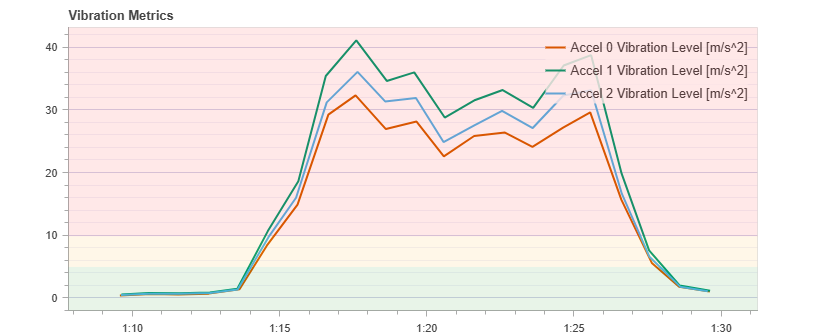

There seems to be high accelerations on z axis, a 80-90 Hz resonance frequency and quite a lost of vibrations. Also the magnetometer seems to have noise and some unwanted yaw rotations were seen without any input from the pilot.
Should we hard mount the pixhawk 6x to the frame ? Also, a notch filter will be applied around the resonance frequency and gyro\_cutoff frequency will be adjusted accordingly.

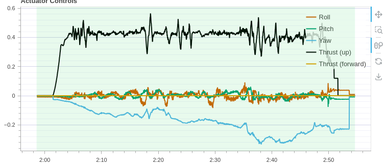

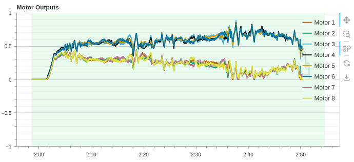

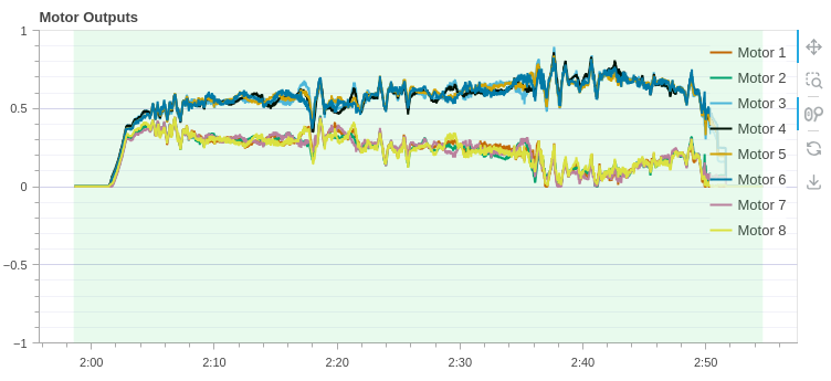

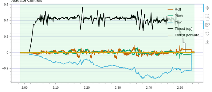

@George_Katevatis
The main issue is that the drone seems to struggle to produce yaw torque. The rotors are then running at highly different operating points and this creates coupling between the roll and pitch axes (e.g.: due to nonlinearities, roll torque creates an undesired pitch torque)
 ![image](https://discuss.px4.io/uploads/default/original/3X/c/6/c6954b48b048745e4be195308234f824a4cffd18.png)
 ![image](https://discuss.px4.io/uploads/default/original/3X/2/f/2f2fec8f236777b9d622bc0f0abf0f0a65615f3f.png)
This is not a tuning issue but a hardware problem and can be addressed by tilting the rotors (by 2-3 degrees) to increase the yaw effectiveness of the drone.

Thanks for the response @bresch. Each two arms are mechanically coupled which seems to have resulted in a weird angle of the motors (in the tangent to the circle of the arms direction) in a way which counteracts the yaw authority of the UAV.
I have a questions about the actuator controls diagram : Can an actuator control be negative (like yaw counterclockwise is negative on the y axis, and vice versa ?) How did you deduce that the drone doesnt have enough yaw authority ? The pilot didnt input any yaw command but the drone seems to have an actuator yaw control input. Is this because of the misaligned motors ?
**Author:** ![bresch](https://discuss.px4.io/user_avatar/discuss.px4.io/bresch/32/2343_2.png) [@bresch](https://discuss.px4.io/u/bresch)\
**Post date:** [March 24, 2025, 1:50pm UTC](https://discuss.px4.io/t/very-large-uav-drone-stability-issues/44324/13 "2025-03-24T13:50:22Z")
The non-zero yaw control value is generated by the yaw/yaw-rate controllers. If all rotors are perfectly aligned, this value should be zero, but in your case, the drone produces a positive yaw torque when all rotors are spinning at the same speed. To counteract this, the controller generates a negative yaw torque.
I said that it doesn’t have enough yaw authority because it needs about 20% of its maximum yaw torque just to stay in place. With higher yaw authority (by tilting the rotors), the yaw controllers will have to work much less and all rotors will be operating at a similar RPM, making the whole system more linear and stable.
