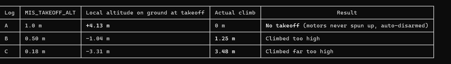

Holybro S500, Pixhawk 6X, PX4 v1.14.3. Indoors, no GPS fix, baro height (EKF2\_HGT\_REF = 0), Holybro H-Flow over DroneCAN (EKF2\_OF\_CTRL = 1, EKF2\_RNG\_CTRL = 1, EKF2\_RNG\_A\_HMAX = 1.0). Armed by RC switch, then switched to Takeoff mode.
Takeoff mode behaves inconsistently. The climb seems to depend on the baro altitude at the moment of takeoff, not on MIS\_TAKEOFF\_ALT:
Log A: [https://logs.px4.io/plot\_app?log=f391d795-a2be-4c0d-b547-93456d4f7cf5](https://logs.px4.io/plot_app?log=f391d795-a2be-4c0d-b547-93456d4f7cf5)
Log B: [https://logs.px4.io/plot\_app?log=bc72cb2b-e861-494a-9e06-0534ee803ba6](https://logs.px4.io/plot_app?log=bc72cb2b-e861-494a-9e06-0534ee803ba6)
Log C:[https://logs.px4.io/plot\_app?log=be21f60a-10e4-4ed2-a00d-298c53df1aa3](https://logs.px4.io/plot_app?log=be21f60a-10e4-4ed2-a00d-298c53df1aa3)
 ![image](https://discuss.px4.io/uploads/default/original/3X/1/1/11a53c167ae4e1c97e1330d3410bd9cb838acb64.png)
Across 24 attempts the same pattern repeats:
- When the local altitude had drifted above MIS\_TAKEOFF\_ALT on the ground, the vehicle did not take off.
- When it had drifted below 0, the vehicle climbed by MIS\_TAKEOFF\_ALT plus the drift.
Every attempt logs [navigator] Using minimum takeoff altitude: X m.

**Post date:** [October 18, 2026, 8:23pm UTC](https://discuss.px4.io/t/v1-14-3-takeoff-mode-without-gps-sometimes-no-takeoff-sometimes-climbs-far-above-mis-takeoff-alt/49611/2 "2026-10-18T20:23:53Z")
This is a useful controlled dataset, especially with 24 attempts and three representative ULogs.
The numbers suggest a possible altitude-reference mismatch rather than simply a controller tuning issue.
For example, in Log C:
MIS\_TAKEOFF\_ALT = 0.18 m
Local altitude on ground = -3.31 m
Observed climb = 3.48 m
The difference, 0.18 - (-3.31) = 3.49 m, is remarkably close to the observed climb.
I would investigate whether the takeoff altitude setpoint is being constructed in a local/global reference that is inconsistent with the vehicle’s current estimated altitude.
Before concluding this is a v1.14.3 bug or fixed in v1.15+, I would compare the exact takeoff implementation across release tags and inspect the three ULogs around mode activation:

Hi, thanks for sharing this issue.
I have been investigating the PX4 v1.14.3 GPS-denied Takeoff behaviour using the three available ULog recordings and the corresponding PX4 source code.
One potentially relevant finding is an altitude-reference mismatch between Navigator and FlightTaskAuto when a valid global altitude reference is unavailable.
In all three recordings, `vehicle_local_position.z_global` was false near Takeoff activation. In PX4 v1.14.3, `FlightTaskAuto::_evaluateGlobalReference()` sets `_reference_altitude` to zero when `z_global` is false. The target altitude is subsequently converted using:
```auto
tmp_target(2) = -(current.alt - _reference_altitude);
The recordings show different initial local Z offsets:
- Log 1: approximately +1.04 m — upward movement
- Log 2: approximately −4.13 m — no successful ascent
- Log 3: approximately +3.31 m — substantial upward movement
The resulting target directions appear consistent with the observed differences in Takeoff behaviour.
This suggests that the interaction between the Navigator takeoff altitude and the local altitude reference may be worth investigating, particularly when operating with optical flow and a rangefinder without GPS.
I want to emphasize that this is a **source-code-supported hypothesis, not yet a confirmed root cause**. The offline analysis is complete, but a controlled PX4 v1.14.3 SITL reproduction is still pending.
Could the PX4 maintainers clarify whether this altitude-reference behaviour is expected in GPS-denied Takeoff mode, and whether any related fixes have been introduced in later versions?

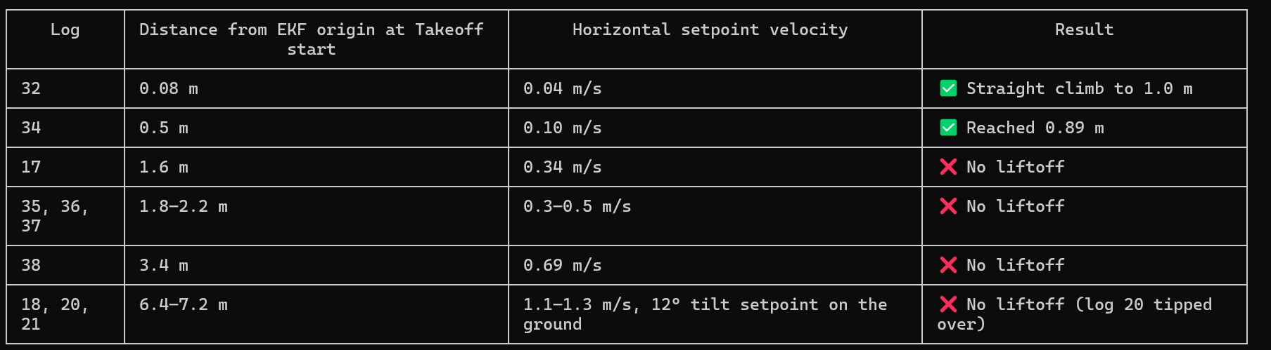

Problem 1: Takeoff moves sideways towards the EKF origin
Whether the takeoff worked depended only on how far the drone was from where it was powered on:
 ![image](https://discuss.px4.io/uploads/default/original/3X/7/b/7bd005cc3a52f58431db33fdb74122b3321961c3.png)
In every failed attempt, the trajectory setpoint headed towards local (0, 0), within 1°, from the first sample of Takeoff, while the drone was still on the ground.
- Home was set correctly at the arming spot (log 38: home x −0.94, y +3.27), so the target is the EKF origin, not home.
- position\_setpoint\_triplet.current shows lat = 0.0, lon = 0.0. vehicle\_local\_position shows xy\_global = false and ref\_lat/lon = NaN.

1. MissionBlock::set\_takeoff\_item() sets item-\>lat/lon = get\_global\_position()-\>lat/lon, which is 0/0 with no global position.
2. With xy\_global = false, FlightTaskAuto::\_evaluateGlobalReference() sets ref\_lat/lon = 0, so lat/lon 0/0 is projected to local (0, 0).
This seems to match issue #21524 ([Local Position only Takeoff Problems for Multicopter · Issue #21524 · PX4/PX4-Autopilot · GitHub](https://github.com/PX4/PX4-Autopilot/issues/21524)). PR #23845 fixed the same behaviour for Land by sending NaN lat/lon when the global position is invalid.

Problem 1, sideways pull towards the EKF origin:
- Log 32, 0.08 m from origin, straight climb to 1.0 m ✅: [https://logs.px4.io/plot\_app?log=a71388c7-1c5f-410a-86d8-a76dba6951a7](https://logs.px4.io/plot_app?log=a71388c7-1c5f-410a-86d8-a76dba6951a7)
- Log 34, 0.5 m from origin, reached 0.89 m ✅: [https://logs.px4.io/plot\_app?log=26b0f33a-9652-4012-a6ab-d5cdb4a7a25d](https://logs.px4.io/plot_app?log=26b0f33a-9652-4012-a6ab-d5cdb4a7a25d)
- Log 17, 1.6 m from origin, no liftoff ❌: [https://logs.px4.io/plot\_app?log=492cf813-73ac-4931-9a27-b76b90156aff](https://logs.px4.io/plot_app?log=492cf813-73ac-4931-9a27-b76b90156aff)
- Log 35, 1.8 m from origin, no liftoff ❌: [https://logs.px4.io/plot\_app?log=a6dfd7ff-c917-417d-b714-e2fd5d9ac09d](https://logs.px4.io/plot_app?log=a6dfd7ff-c917-417d-b714-e2fd5d9ac09d)
- Log 38, 3.4 m from origin, no liftoff ❌: [https://logs.px4.io/plot\_app?log=6081e73b-e216-4035-800c-2e9c2b59f004](https://logs.px4.io/plot_app?log=6081e73b-e216-4035-800c-2e9c2b59f004)
- Log 18, 6.8 m from origin, no liftoff, 12° tilt setpoint on the ground ❌: [https://logs.px4.io/plot\_app?log=ca346d3a-4328-425f-8da4-9c26b495fb41](https://logs.px4.io/plot_app?log=ca346d3a-4328-425f-8da4-9c26b495fb41)

**1. Takeoff targeting the local origin**
Your analysis is strongly supported by the source code.
In v1.17.0, `MissionBlock::set_takeoff_item()` still assigns latitude and longitude directly from the global position, without checking `xy_global`.
Meanwhile, `FlightTaskAuto::_evaluateGlobalReference()` substitutes a zero-valued geographic reference when global XY is unavailable.
This makes your reported unintended projection toward local (0, 0) a credible explanation for the observed behaviour.
**2. Proposed Takeoff correction**
Your proposed NaN approach is consistent with the existing Land correction in PR #23845.
Importantly, `FlightTaskAuto::_evaluateTriplets()` already contains logic to lock the current local XY position when the incoming latitude or longitude is non-finite.
I would therefore consider adding an `xy_global` validity check in the Takeoff path a reasonable candidate fix, subject to SITL regression testing.
