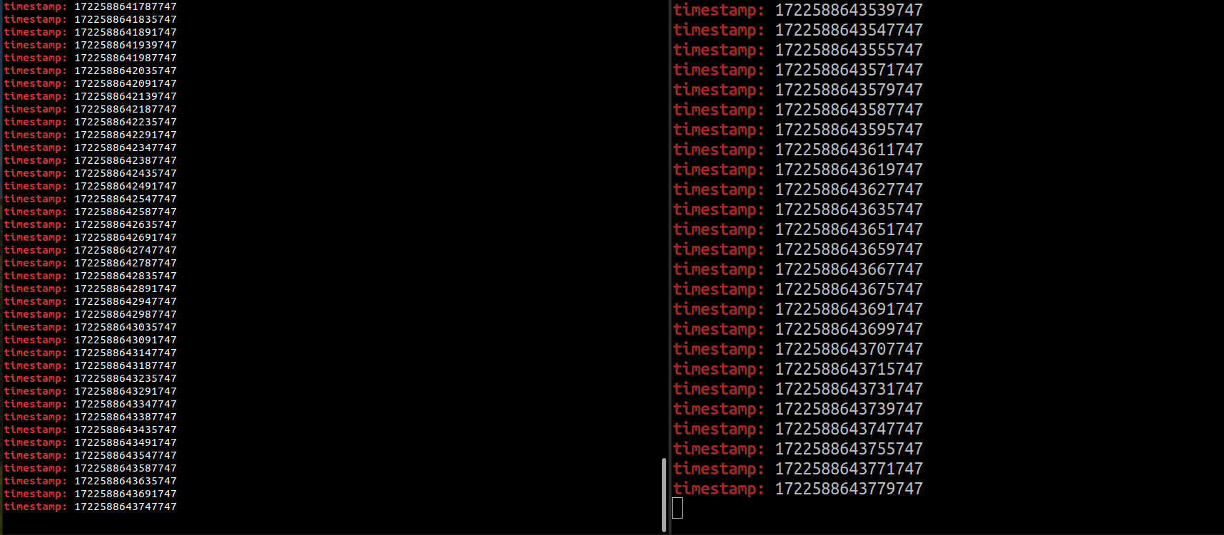

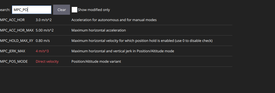

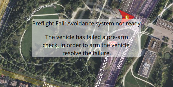

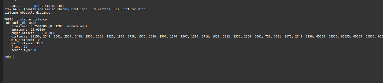

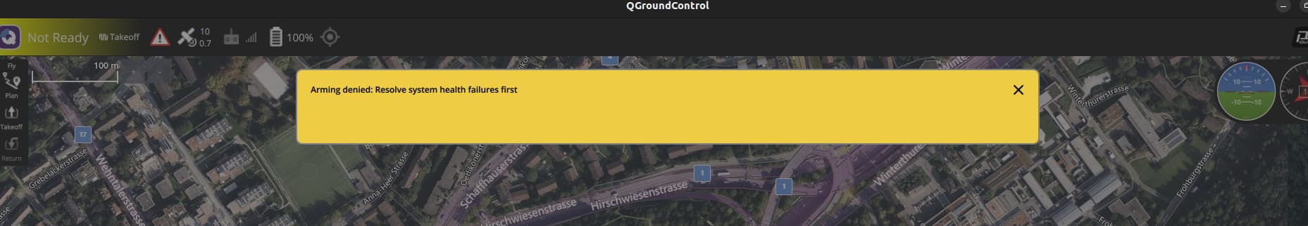

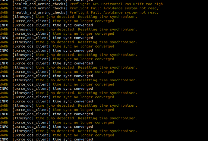

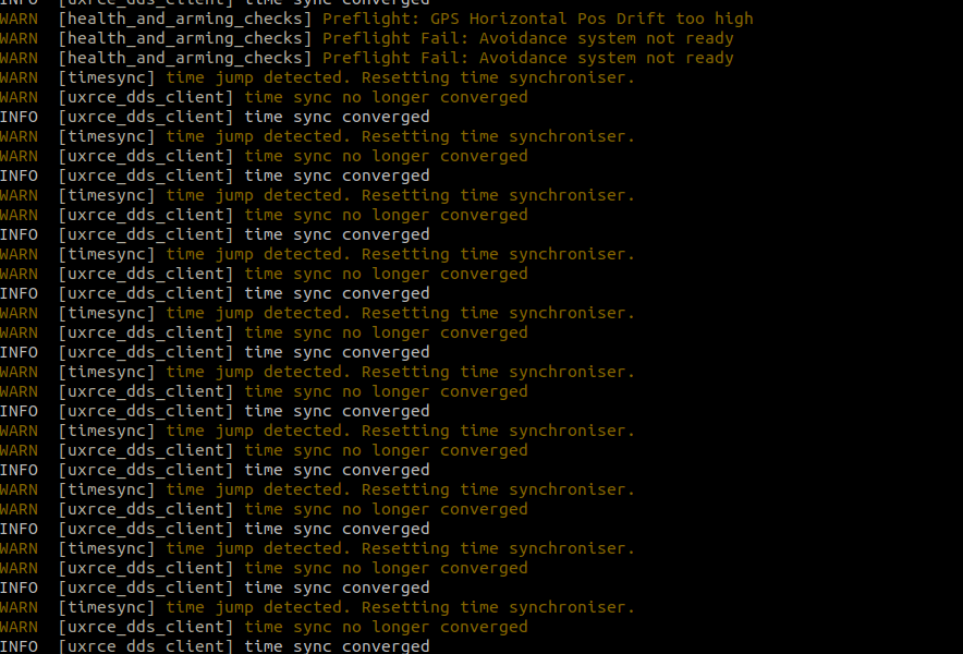

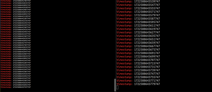

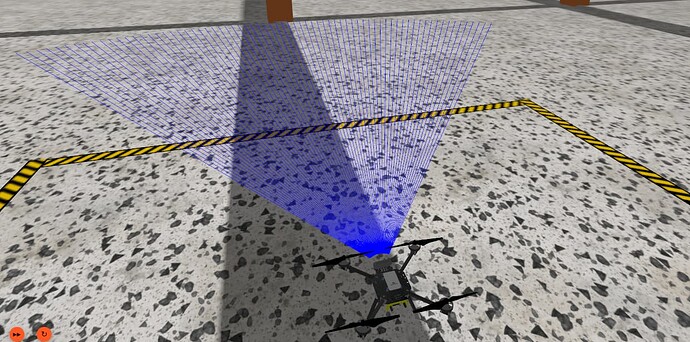

I want to test the PX4 Collision Prevention feature in a simulation environment. For this, I added a lidar to the drone and ensured a specific angle is covered. I populated the data into a variable I created from the px4\_msgs::msg::ObstacleDistance message in ROS2 and publish it at certain intervals. However, the vehicle does not arm on the PX4 side. I am sharing the error I received and the parameters I changed via QGC in the images below. (The steps I followed are on [this page](https://docs.px4.io/main/en/computer_vision/collision_prevention.html#angle_change_tuning)).
PX4 Output
 ![image](https://discuss.px4.io/uploads/default/original/3X/5/0/50e3590d0465dea2bfe7086e767dc53fa8e33b32.jpeg)
 ![image](https://discuss.px4.io/uploads/default/original/3X/7/e/7effc8bd15d684278792cc36134b58dc1cac1596.png)
![image](https://discuss.px4.io/uploads/default/original/3X/5/f/5f83c17c5642c76b3c28cbe7c8522cff726361da.jpeg)
PX4 Parameter

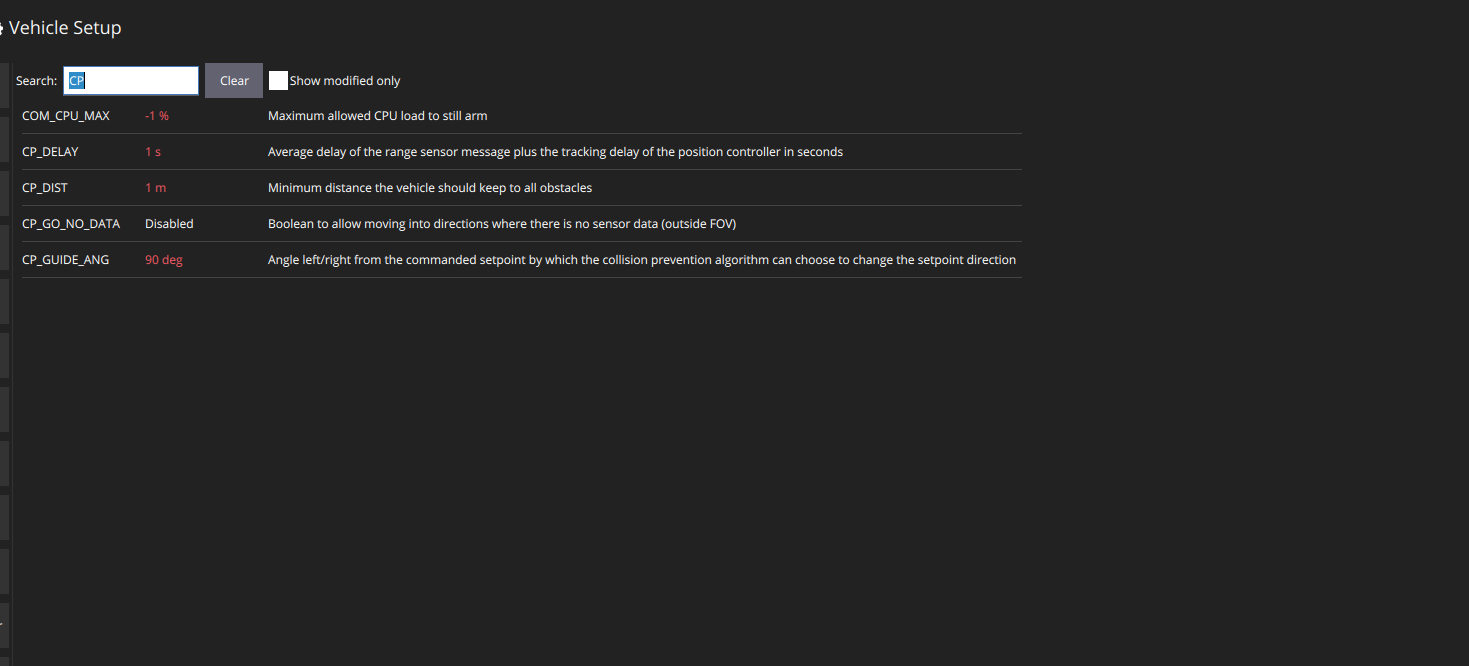

 ![image](https://discuss.px4.io/uploads/default/original/3X/8/d/8d87efcaf9bcda97c7a6ace6cac218f962324b49.png)

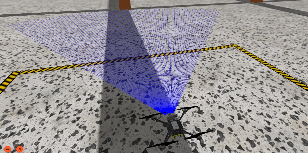

Gz Sim Lidar Data:
 ![image](https://discuss.px4.io/uploads/default/original/3X/a/f/afc10bc03c8906ab18d4afd556d50d54415408f8.jpeg)
code:
```cpp
using obstacleDistanceMsg = px4_msgs::msg::ObstacleDistance;
obstacleDistanceMsg obs_distance;
obs_distance.frame = obs_distance.MAV_FRAME_BODY_FRD;
obs_distance.sensor_type = obs_distance.MAV_DISTANCE_SENSOR_LASER;
obs_distance.increment = 1;
obs_distance.min_distance = 8;
obs_distance.max_distance = 600;
obs_distance.angle_offset = -36;
```cpp
void SensorListener::lidarCallabck(const laserScanMsg::SharedPtr msg)
    for(int i = 0; i < msg->ranges.size(); i++)
        obs_distance.distances[i] = std::min(std::max(static_cast<int>(msg->ranges[i] * 1e2), static_cast<int>(obs_distance.min_distance)), static_cast<int>(obs_distance.max_distance));
    obs_distance.timestamp = px4_time;
    obstacle_distance->publish(obs_distance);

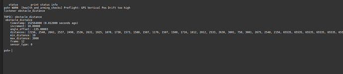

- The right side is the system’s timestamp value, and the left side is the timestamp value I published.
 ![image](https://discuss.px4.io/uploads/default/original/3X/8/7/87f9e7b6cfdebd4021b3232f5c68fed2b7bf9c86.png)
@hamishwillee , have you done any work related to this?

@serkan I subedited / wrote some of the docs you point to working with the engineers who wrote this code. Unfortunately I’m an author - I haven’t actually tried this myself.
You’re not the only person to have had this problem [[Bug] Avoidance system not ready · Issue #22994 · PX4/PX4-Autopilot · GitHub](https://github.com/PX4/PX4-Autopilot/issues/22994)
It may be that there is some additional check for a companion computer. Have asked @Jaeyoung-Lim for advice on that issue - or a pointer to anyone who might know more.

if you just want e SITL envoirement for testing CP, download px4 Main, or a commit where this PR is present: [[gz-sim] x500\_lidar for testing CollisionPrevention by dakejahl · Pull Request #22418 · PX4/PX4-Autopilot · GitHub](https://github.com/PX4/PX4-Autopilot/pull/22418)
with that you should be able to call ` make px4_sitl gz_x500_lidar`

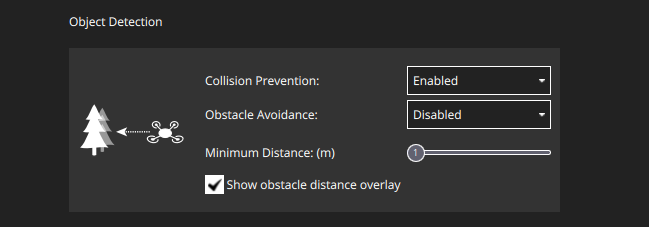

then you can enable CP in the Settings, but make sure to change [MPC\_POS\_MODE](https://docs.px4.io/main/en/advanced_config/parameter_reference.html#MPC_POS_MODE) to 0 or 3
**Author:** ![serkan](https://discuss.px4.io/user_avatar/discuss.px4.io/serkan/32/15385_2.png) [@serkan](https://discuss.px4.io/u/serkan)\
**Post date:** [August 7, 2024, 10:49am UTC](https://discuss.px4.io/t/using-collision-prevention/40013/5 "2024-08-07T10:49:52Z")

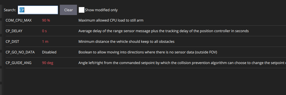

I tried it, but it didn’t work very well. The drone is crashing into all the obstacles in front of it.

try with a higher cp\_delay, as it scales the possible commanded velocities. and no delay is not realistic. and set mpc\_jerk\_max to the default value, if your halfing the jerk, your also increasing the delay related to velocity change, as your limiting the rate of change of acceleration.
