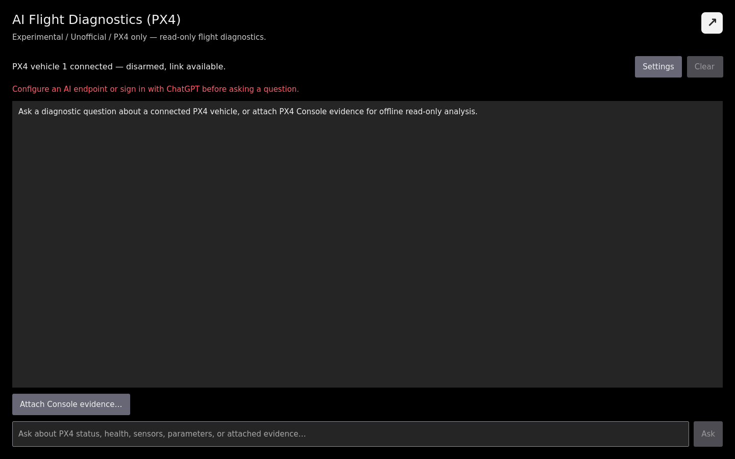

## New Analyze experience
 ![AI Flight Diagnostics Analyze page](https://discuss.px4.io/uploads/default/original/3X/0/6/067abc2c3de177c5b3f5d2f9155b7da0663ed131.png)
The new page presents the connected firmware, armed/flight state, link state, and available diagnostic data. It contains the conversation, question input, Ask, Cancel, Clear, Settings, and a local approval card for gated MAVLink data requests.
PX4 Console text is now optional evidence, not an implicit data source. A collapsed attachment area accepts text only when the user deliberately pastes it. The page explains that the attachment will be sent to the selected AI service, sends only the final 12,000 characters, and clears the attachment when the session is cleared or the active Vehicle changes.
The request boundary is explicit for each connection state:
| State | Can ask? | Local Vehicle tools |
| Supported PX4 Vehicle connected | Yes, when an AI service is configured | Available under the local safety policy |
| Non-PX4 Vehicle connected | No; rejected before any AI request | Disabled |
| No Vehicle, no attachment | No | Disabled |
| No Vehicle, explicit attachment | Yes, for attachment-only analysis | Disabled |

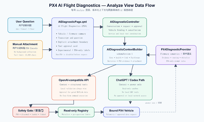

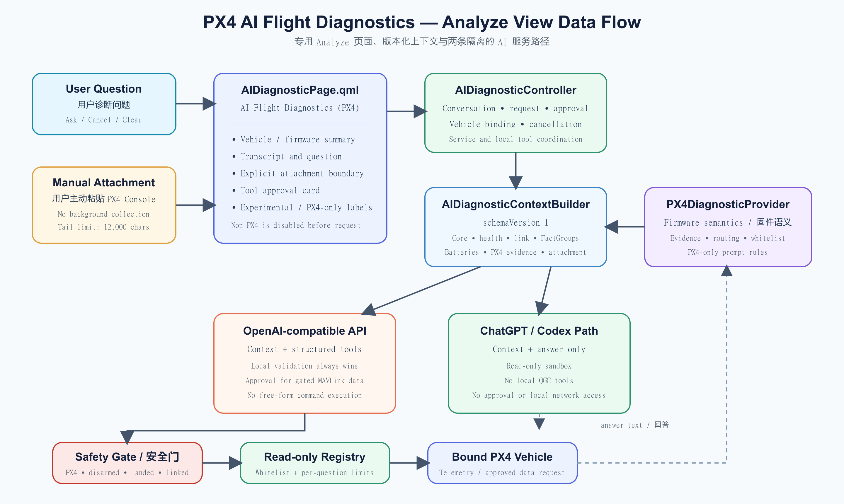

## Refactored architecture and context contract
 ![Updated QGroundControl AI diagnostic data flow](https://discuss.px4.io/uploads/default/original/3X/5/f/5fbc7aab1c9cb07526ecd39920bb864d58106aa7.png)
The original Console-oriented controller has been split into four responsibilities:
- **AIDiagnosticController** coordinates the QML conversation, request lifecycle, cancellation, approval, service selection, and local tool execution.
- **AIDiagnosticContextBuilder** creates a versioned QGroundControl snapshot containing core Vehicle state, sensor summaries, health and arming checks, link state, FactGroups, batteries, provider evidence, and the explicit Console attachment.
- **AIDiagnosticProvider** defines the firmware-diagnostic extension boundary.
- **PX4DiagnosticProvider** implements PX4 eligibility, external-vision evidence, parameter and Console policies, question routing, the MAVLink data-message whitelist, and PX4-specific prompt semantics.
The context contract starts at `schemaVersion: 1`. Missing evidence is represented as unavailable or unknown instead of being turned into a guessed fault. Future context changes can therefore be reviewed as changes to an explicit interface rather than as untracked prompt text.

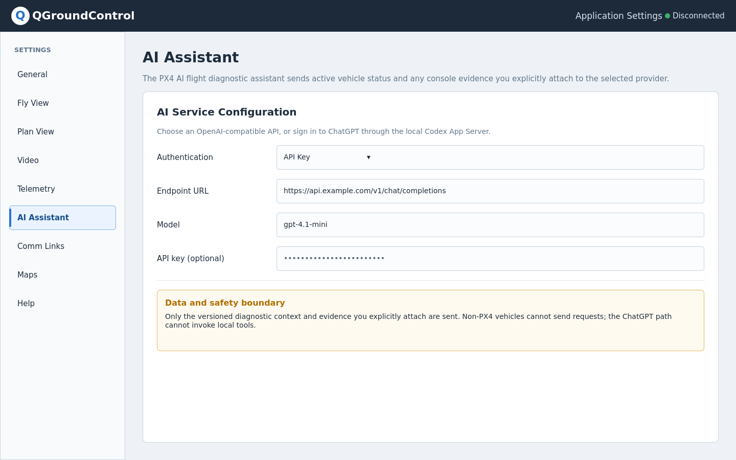

## Two AI service paths and the data boundary
 ![AI Assistant settings](https://discuss.px4.io/uploads/default/original/3X/8/d/8d83522d748626de79bb54616d3552936e2e13e1.png)
The two service paths remain intentionally different:
1. **OpenAI-compatible Chat Completions:** QGroundControl sends the versioned context and a fixed structured-tool registry. A model may propose a tool call, but QGroundControl validates the tool name, arguments, bound Vehicle, state, whitelist, and call limits locally.
2. **ChatGPT through the local Codex App Server:** QGroundControl sends the supplied context and receives answer text. This path is started read-only and does not expose QGroundControl local tools or approval actions.
Depending on availability, the versioned context may contain Vehicle identity and firmware, armed and flight state, mode and readiness, position, sensor and battery summaries, health/arming checks, link counters, FactGroups, relevant loaded PX4 parameters, provider-generated evidence, limited conversation history, and Console text explicitly attached by the user.
This does not remove the remote service’s own data-handling terms. Users should still remove secrets, identifiers, internal addresses, and unrelated Console output before sending a request.

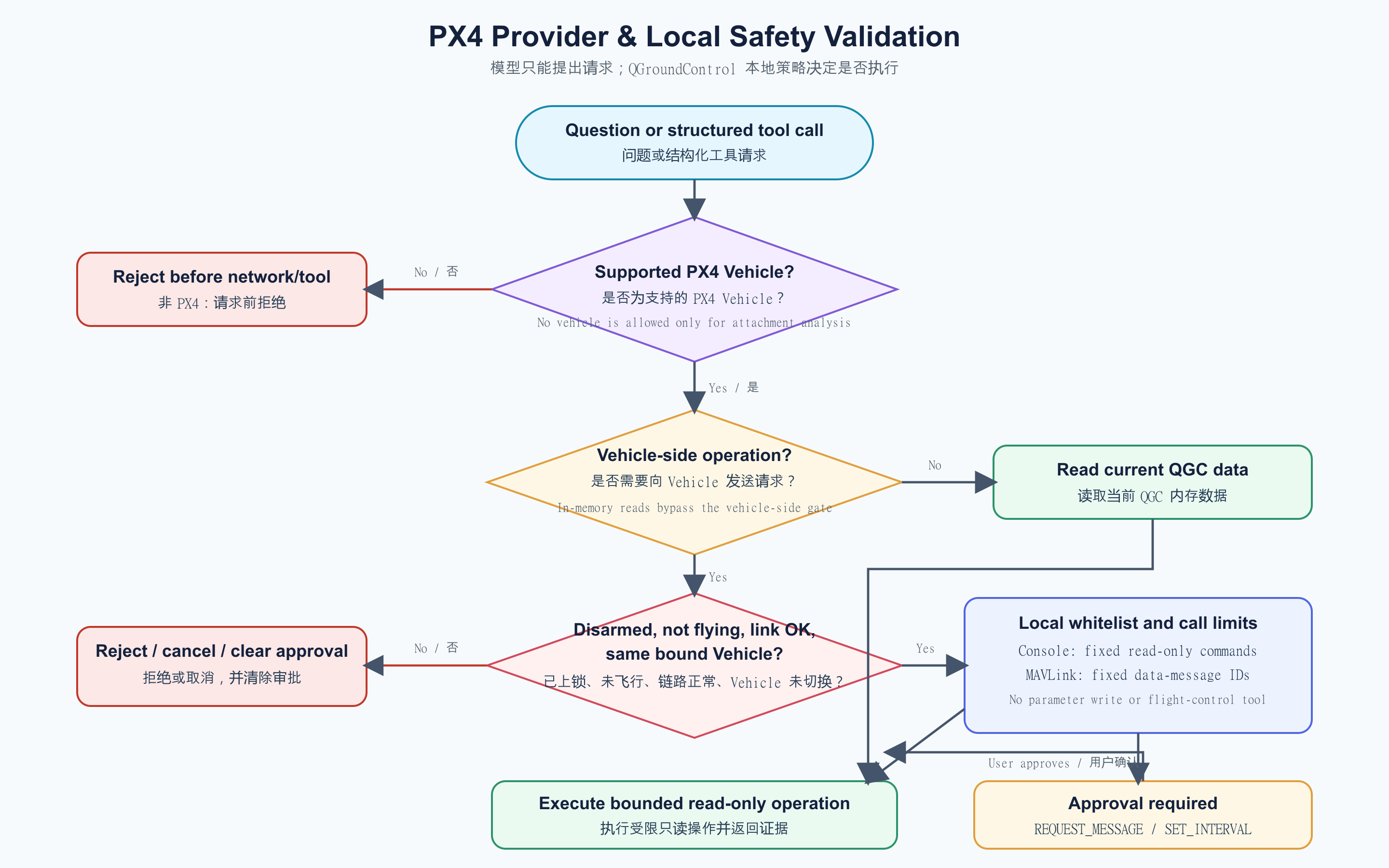

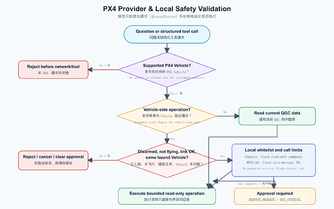

## Safety boundary retained and tightened
 ![PX4 provider and local safety checks](https://discuss.px4.io/uploads/default/original/3X/f/0/f0ec8833144e11f13db9455472f1bb80655dae36.png)
The assistant cannot arm, disarm, move, take off, land, change modes, write or reset parameters, calibrate, reboot, run actuator tests, edit missions, or execute arbitrary shell or MAVLink commands.
The OpenAI-compatible path exposes only a fixed diagnostic registry:
- Current QGroundControl state, FactGroups, health, link status, and loaded-parameter reads are in-memory and read-only.
- Restricted PX4 Console diagnostics use a command whitelist and a per-question call limit.
- `MAV_CMD_REQUEST_MESSAGE` and temporary `MAV_CMD_SET_MESSAGE_INTERVAL` are limited to whitelisted telemetry messages and always require explicit user approval.
Vehicle-side Console and MAVLink requests are rejected when the PX4 Vehicle is armed, flying, or communication is lost. Each request is bound to the Vehicle that was active when it started. Switching, disconnecting, or destroying that Vehicle cancels the request and clears pending approval, preventing a delayed result or approval from being applied to another Vehicle.
