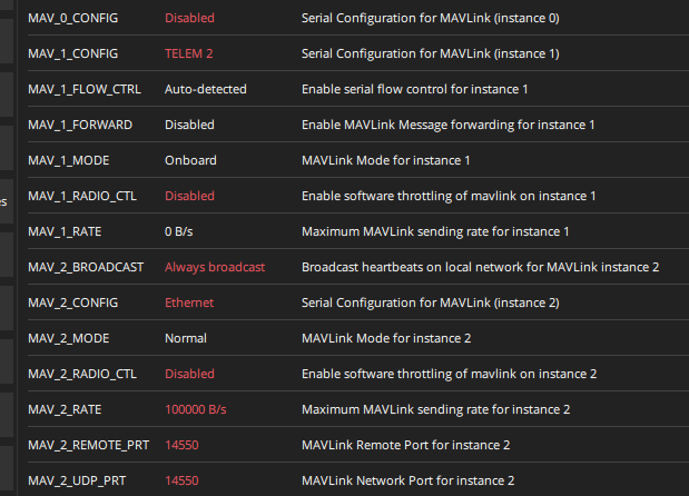

It appears I am unable to verify the serial connection between the Holybro Jetson and Pixhawk (6X).. I followed the work flow documented here: Holybro Pixhawk Jetson Baseboard | PX4 Guide (main) . After executing the telemetry.py script, there is basically no response, it gets hung while ‘Waiting to discover system on serial:///dev/ttyTHS1:921600… ‘.
user1@ubuntu:~$ python ~/MAVSDK-Python/examples/telemetry.py
INFO:mavsdk_server:MAVSDK version: v3.10.2 (mavsdk_impl.cpp:32)
INFO:mavsdk_server:Waiting to discover system on serial:///dev/ttyTHS1:921600… (connection_initiator.h:20)
Here is my px4 mavlink setup:
I’ve tried to reflash my board and followed the setup work flow strictly and have not been successful. Any guidance, insights or help would be greatly appreciated!
