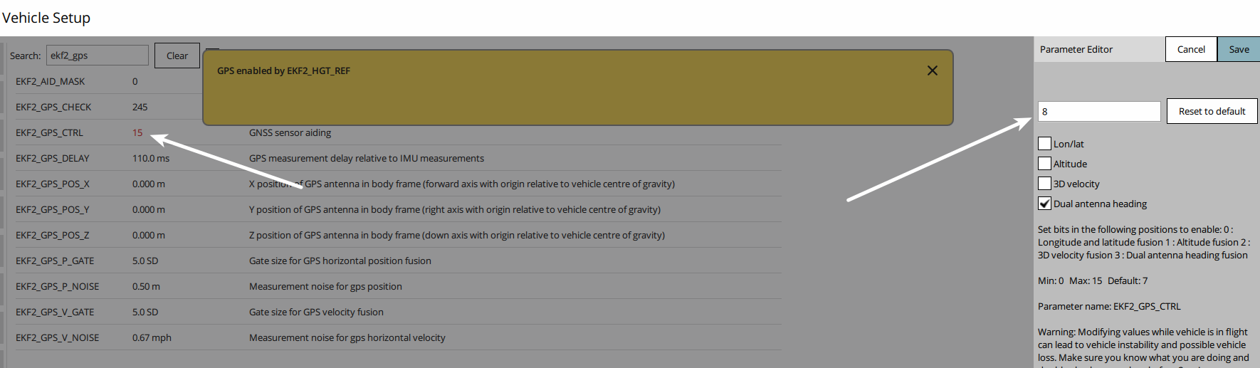

I am trying to use [H-RTK Unicore UM982 (Dual Antenna)](https://docs.holybro.com/gps-and-rtk-system/h-rtk-unicore-um982/overview) GPS Antenna to fix the yaw issues I were having due to the higher values of EMF.
**Here are the details of my setup:**
**Firmware:** PX4 1.14.0rc
**AutoPilot:** Holybro Pixhawk 6C
**Airframe:** Quadrotor x (Generic Quadcopter)
**Issues:**
- Unable to set the value of “EKF2\_GPS\_CTRL” to “Dual Antenna Heading” (8).
- Unable to arm the drone while in “Position” mode, upon pressing the “arm” button from remote, the GPS red light becomes flashing red in fast and a beep came. No error on QGC screen. Drone is arming if I arm it in the “Altitude” flight mode.
I can successfully set the value of the below parameter as asked in the [documentation](https://docs.px4.io/main/en/gps_compass/rtk_gps_holybro_unicore_um982.html#px4-configuration), but getting a message while trying to set the value of “EKF2\_GPS\_CTRL”.
- [SER\_GPS1\_BAUD](https://docs.px4.io/main/en/advanced_config/parameter_reference.html#SER_GPS1_BAUD) → 230400
- [GPS\_1\_PROTOCOL](https://docs.px4.io/main/en/advanced_config/parameter_reference.html#GPS_1_PROTOCOL) → 6: NMEA
- [GPS\_YAW\_OFFSET](https://docs.px4.io/main/en/advanced_config/parameter_reference.html#GPS_YAW_OFFSET) → 90
Whenever, I try to set the value of “EKF2\_GPS\_CTRL” to “8” (Dual Antenna Heading), the value automatically goes back to “15”.
