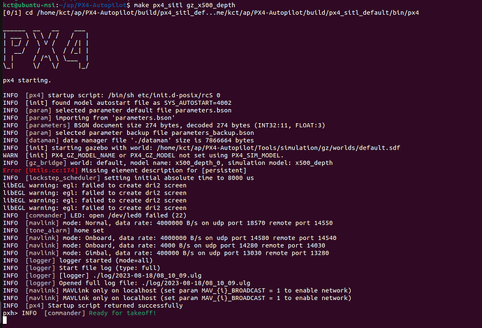

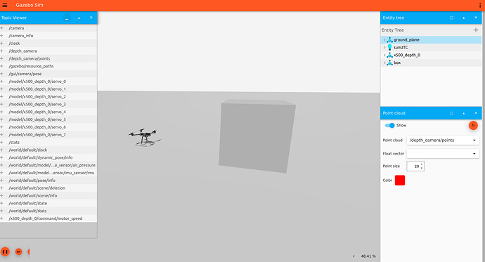

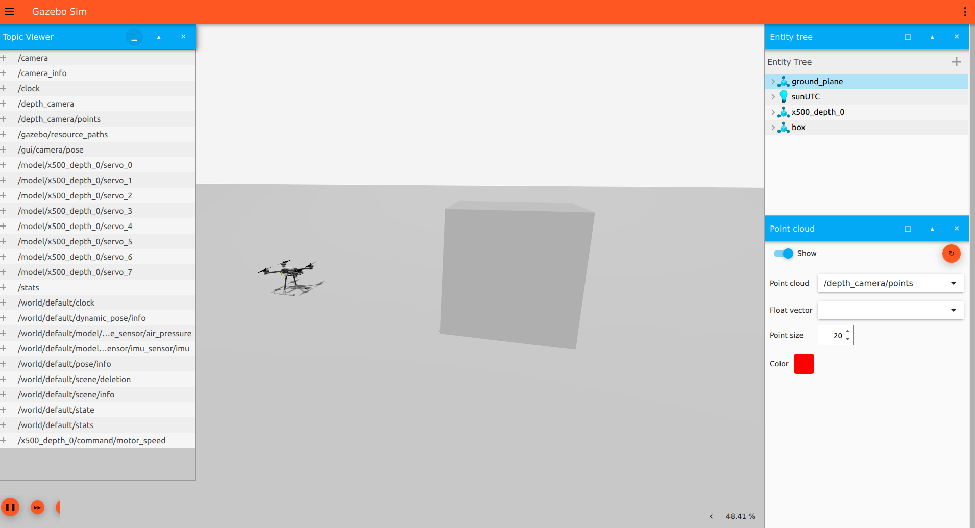

I would like to simulate point cloud readings in the environment on a quadcopter and tried to use the gz\_x500\_depth vehicle for software in the loop.
I’m able to see the topics /depth\_camera and /depth\_camera/points, but I’m unable to display the pointcloud in gazebo. Am I missing some steps?
Here are my screenshots for reference (I also added a box in the default world):
 ![Screenshot from 2023-08-18 16-11-52](https://discuss.px4.io/uploads/default/original/2X/0/05bd08a76558d0df70991f58908290cc32f7333c.png)
 ![Screenshot from 2023-08-18 16-15-34](https://discuss.px4.io/uploads/default/original/2X/6/63b335f0b5f8aad1b704eca942c0425f50714156.png)

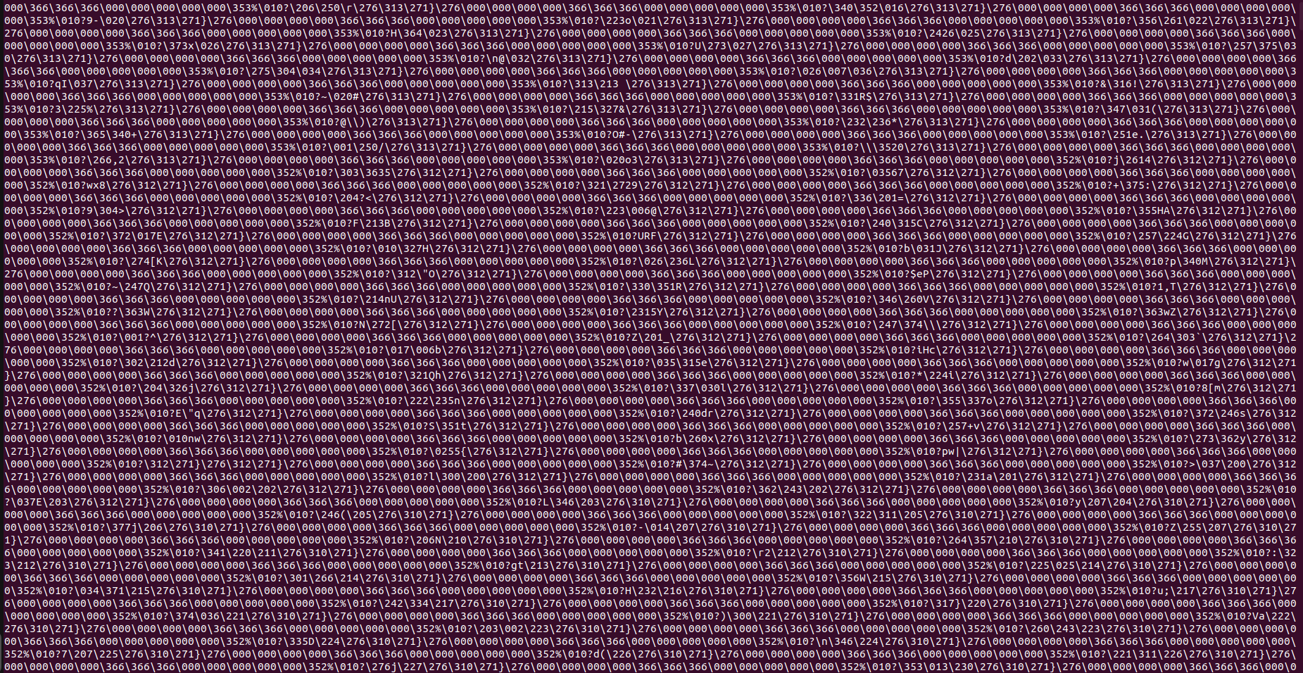

The command “gz topic -e -t /depth\_camera/points” shows a bunch of numbers:
 ![Screenshot from 2023-08-18 16-14-53](https://discuss.px4.io/uploads/default/original/2X/9/910eb3bd567e0bcdb9933673204806391d497219.png)
I’m using Ubuntu 22.04 Jammy Jellyfish, Gazebo Garden v7.5.0 and the latest PX4-Autopilot code downloaded today. I’m not using ROS in this setup, just Gazebo.

I realised that we need a Float\_V message to specify the colour gradient of the points in the point cloud for it to show up
