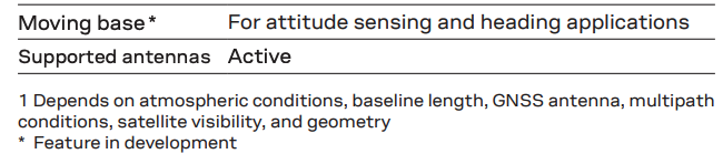

@dakejahl I just tried on x20p with HPG 2.02 FW. There are no CFG-MSGOUT-RTCM_3X_TYPE4072_0_UART1 keys and it NAKs if you try to send them. It looks like current firmware only supports static base RTK.
There is a * in the X20P data sheet saying feature in development
And they just released X20D.
So I think we need to wait for a FW update for this on X20P :frowning:
I also had a go with it and the option for RTCM_3X_TYPE4072_0_UART1 and RTCM_3X_TYPE4072_0_UART2, and greyed out in u-Center 2. It is non working.
