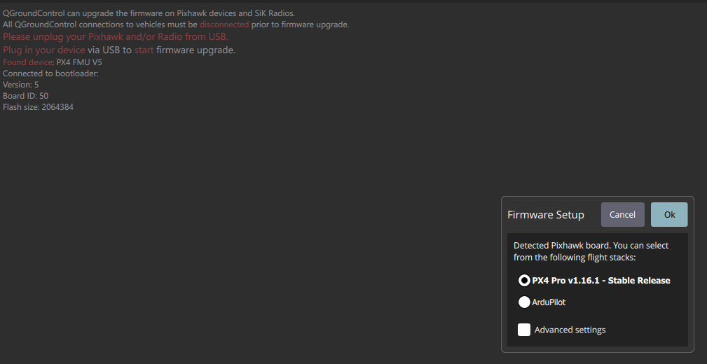

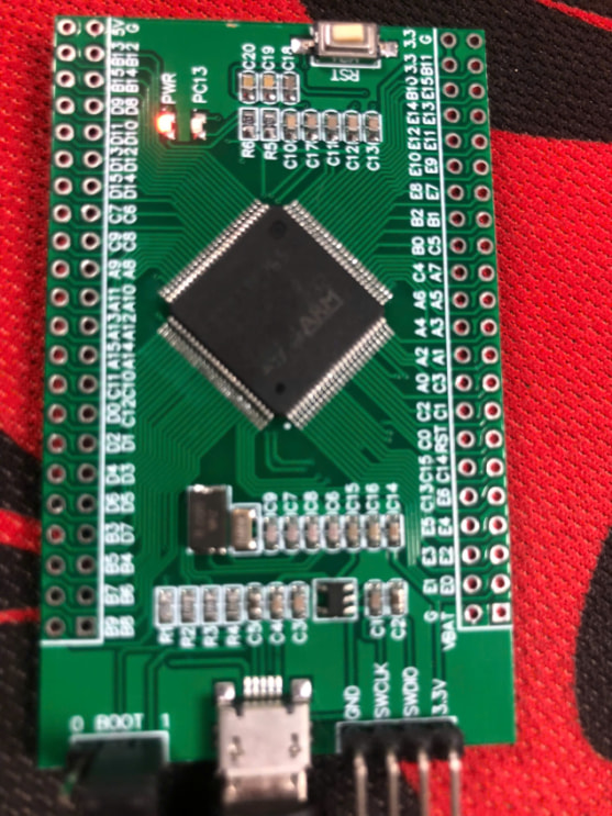

hello, i have stm32f765vit6 board. The board uses an external crystal of 8mhz, I edited the bootloader configuration and qgc recognized it. However, the fw configuration step is based on fmuv5. I edited STM32_BOARD_XTAL to 8000000ul and PLL as shown

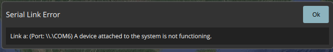

to ensure 48 MHz clock for OTG and 432 MHz. When connecting to qgc, I get Serial Link Error Link a: (Port: \.\COM6) A device attached to the system is not functioning. Can anyone help me?

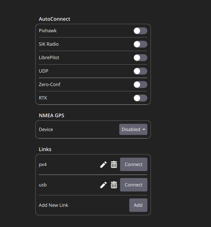

I encountered a similar problem and fixed it by disabling all auto-connect in the COM links section. This might be due to a faulty USB port. Once you’ve disabled the COM port error, try flashing the firmware to see if you can access the setup menu. If not, it’s because Mavlink isn’t available on the USB port. You can use the telemetry port to connect and access the setup menu. I’m working on a similar board to yours and experiencing an SD card writing error. If you successfully set up and use the SD card, could you please give me some help? It would be great if we could collaborate.
If you have a telemetry port, you can manually connect using TTL to connect to that COM port, and QGC should work. I think the COM port error is most likely due to a faulty USB port that can’t transmit MavLink, preventing QGC from connecting.
