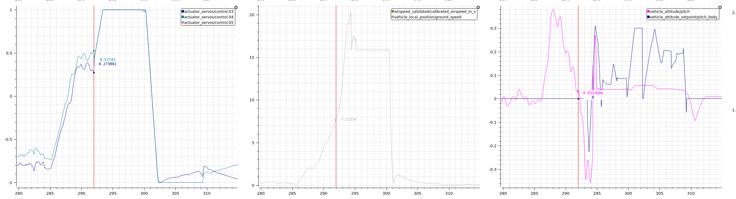

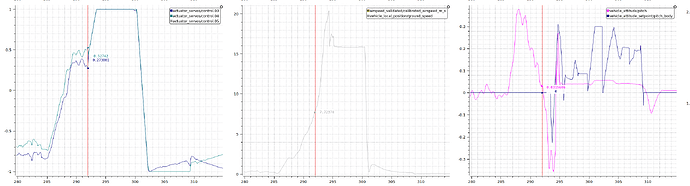

I’m currently working on tuning the VTOL transition for my Heewing T2 Cruza VTOL, which is a tri tiltrotor. I’m encountering serious stability issues during the transition phase from multicopter to fixed-wing.
In real flight, the drone pitched down aggressively right after initiating the transition and crashed into a field. I’ve attached the flight logs from this crash for reference.
I’m experiencing very similar behavior in simulation using the PX4 “tiltrotor” model in the Gazebo library. During transitions, the vehicle consistently drops several meters before recovering, showing the same nose-down tendency.
I experimented a bit in simulation and found that extending the transition time to more than 10 seconds and setting `VT_TILT_TRANS` to a high value (e.g., 0.7 or above) seems to reduce the severity of the dive, but these adjustments feel more like a workaround than a real solution.

The cause of the pitch dip is a stall that occurs when exciting the transition.
You’re not using an airspeed sensor on your VTOL, do you? If you would, the transition would be only considered done after reaching the transition airspeed (9m/s in your case). Without airspeed present, there is a simply time based check: transition is complete after VT\_F\_TR\_OL\_TM (6s).
 ![image](https://discuss.px4.io/uploads/default/original/3X/8/9/89297208e2e14886192987f62d406de3b6da2867.png)
You can either add an airspeed sensor (recommended!), or increase VT\_F\_TR\_OL\_TM to 8s at least, or make the tilt ramp faster (reduce VT\_F\_TRANS\_DUR).
