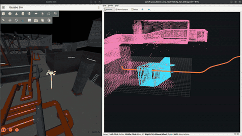

I fly an autonomous navigation stack on PX4 SITL v1.17 in Gazebo Harmonic over
uXRCE-DDS: ROS 2 Jazzy plans and publishes trajectory setpoints in offboard
mode, and the vehicle’s position comes from my own estimator through
`/fmu/in/vehicle_visual_odometry`, with GNSS and the magnetometer off. Over
the last weeks three PX4-side findings each cost me a flight before I
understood them, and none of them was in my planner. Posting them in case they
save someone else the same weeks, and because I would like to be corrected
where I am wrong.
The stack is open source and simulation-only:
> **[GitHub - formiat/px4-ros2-drone-nav](https://github.com/formiat/px4-ros2-drone-nav)**
> Contribute to formiat/px4-ros2-drone-nav development by creating an account on GitHub.
![11_room_crossing](https://discuss.px4.io/uploads/default/original/3X/2/9/2900a9eddc61acfcee01a492163614ff62abdeb1.gif)
_(GIF: the setup in flight, in an industrial room 58 m short of the goal. Left
is Gazebo, right is RViz: the pink cloud is the obstacle memory the planner
searches, the cyan fan is the stereo depth of this frame, orange is the
trajectory PX4 is flying in offboard mode and the magenta sphere is the goal.
The position PX4 fuses comes from a visual-inertial filter on those same
images; there is no GNSS and no lidar on this airframe.)_
The whole flight: [https://www.youtube.com/watch?v=OUuAj2WNKzs](https://www.youtube.com/watch?v=OUuAj2WNKzs)
