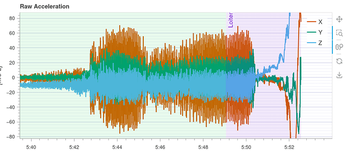

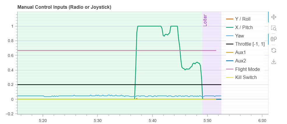

Your vibrations in X(roll) seem high even before the problem occured.
 ![image](https://discuss.px4.io/uploads/default/original/3X/b/d/bd9190ba49f7662e8a8a48e5ea02d8a6ea874056.png)
Seems like you pitched max, going almost 20m/s. started to decelerate, got into a oscillation which could not be fixed by the controller.
Have you PID tuned the drone before attempting this type of max forward flight?
I’m talking roll/pitch/yaw rate controller tuning.

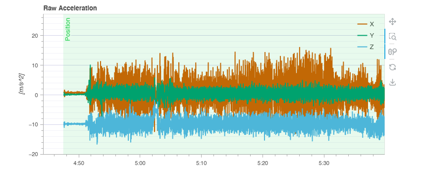

I have never tuned the PID before.
However, I have flown this aircraft many times at almost maximum speed without any issues. This time, I noticed that it crashed after flying only a short distance ☹
Here is a flight log from a previous flight of this quad: [https://review.px4.io/plot\_app?log=4b20438c-bc5a-4d22-9058-12718730def1](https://review.px4.io/plot_app?log=4b20438c-bc5a-4d22-9058-12718730def1)

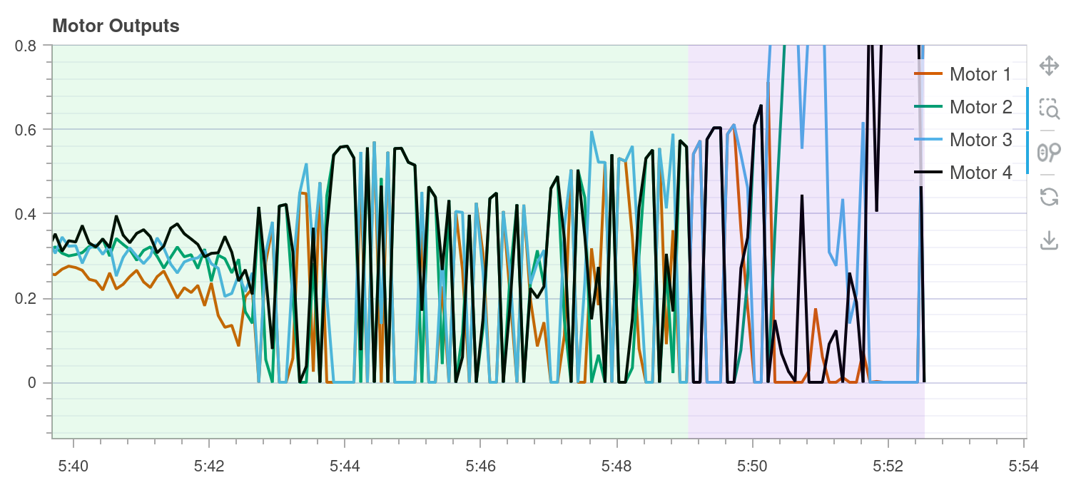

Around 5:43 something seems to change and it suddenly twitches/oscillates a bunch!
The motor outputs suddenly become much more extreme:
 ![image](https://discuss.px4.io/uploads/default/original/3X/a/3/a30995b87e162ba9b089d882dc93425d617d1ae2.png)
Same with accels:
 ![image](https://discuss.px4.io/uploads/default/original/3X/6/6/6621062045b2fd575ad0ef9c7251cb1f2181d0f1.png)

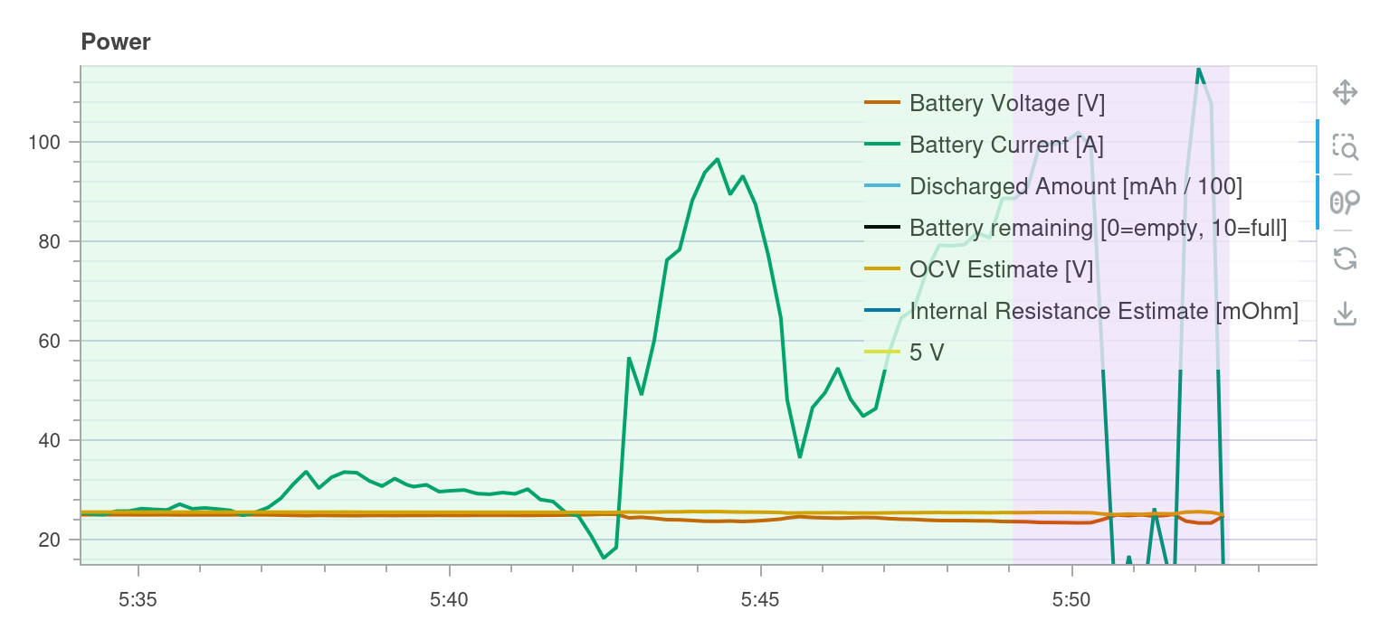

And current use goes from ~30 A to ~80 A!
 ![image](https://discuss.px4.io/uploads/default/original/3X/6/3/6337b485b524b896810cb40c75bad29aef307675.png)
I haven’t quite figured out what changes at that moment, or what triggered it. The log doesn’t indicate an event.
What did you see/hear/feel at that time? Any hints what might have changed?

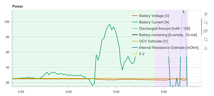

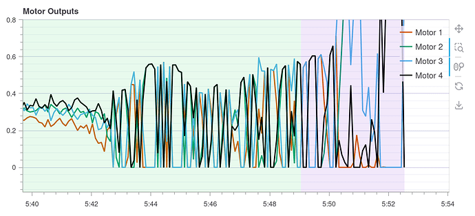

I’m also wondering that at around 5:43, the aircraft had already been flying forward for about 5–6 seconds, so it should have been stable at that point, shouldn’t it?
 ![image](https://discuss.px4.io/uploads/default/original/3X/4/a/4a5749ea9bc53df47814658d513dc3950987c00c.png)
