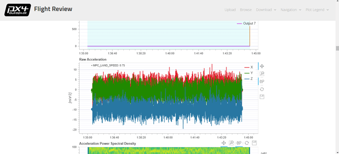

The vibration is high . Note the Z graph overlapping with the X- Y plots .
Just out of curiosity , what is output actuator 5 in your quadcopter ?
Motor output 4 through 7 are not controlling or connected to anything. I was curious about this too, because we are configured as a Quad X frame. I took a look back at some logs from our previous firmware, base on v1.11.2, and we’ve always been outputting 8 channels even though only output 0 through 3 are being used.
Good point on the vibration as well. With this airframe, I normally see higher vibration than I’d like, but some units are worse than others. If you look at the spectral density, most of the vibration is coming from higher frequencies, above 80 Hz, which should be directly from the motors/props. I’m not sure if you have insight on this but it has been an open question has been, are we using the vibration isolated IMU or non-vibration isolated IMU for our primary sensors? And does that matter in a multi-EKF configuration? (these are CubeOranges)
