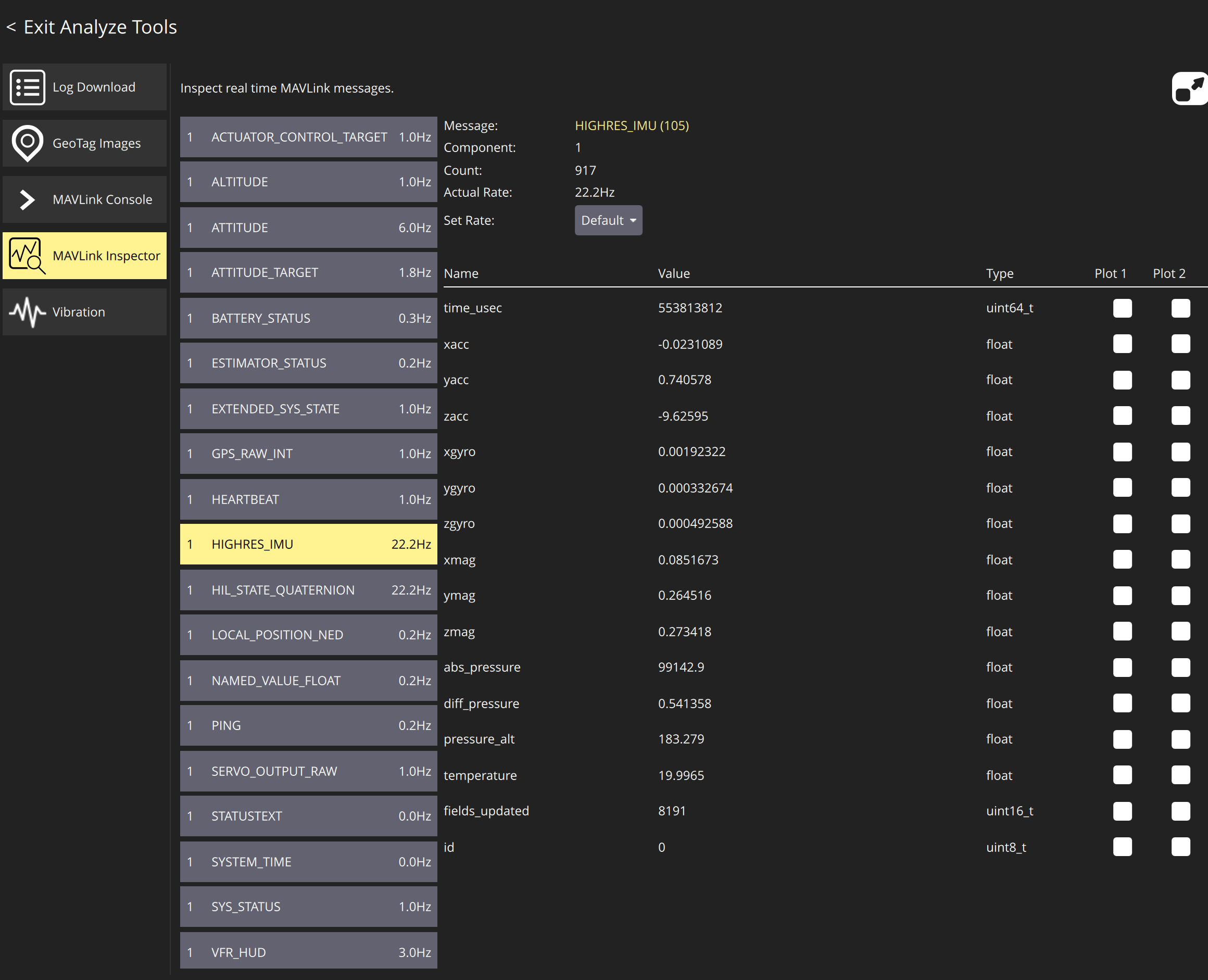

Hi @JulianOes , thanks your reply. I solved the problem when i stopped sending HIL_QUATERNION.

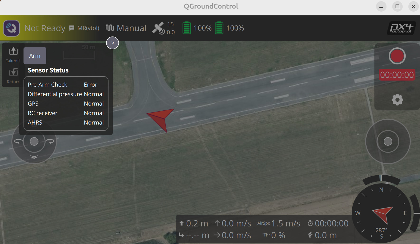

But i really appreciate if u comment this problem again with Simulink. Now here is another problem with 1.11 version, it says prearm-check error and i cant switch to position mode.
But i couldnt find what is the problem, i did what is written in 1.11 documentation about prearmcheck parameters CBRK_IO_SAFETY 22027, COM_PREARM_MODE = 2 and other combinations.
I check ekf2 and its not started but sensors are okay. You can see pxh outputs below

pxh> ekf2 status
INFO [ekf2] local position: invalid
INFO [ekf2] global position: invalid
INFO [ekf2] time slip: 41493 us
ekf2: update: 97173 events, 3961033us elapsed, 40.76us avg, min 30us max 6557us 60.122us rms

pxh> listener sensor_combined
TOPIC: sensor_combined
sensor_combined_s
timestamp: 1045203847 (0.000524 seconds ago)
gyro_rad: [0.0019, -0.0001, -0.0001]
gyro_integral_dt: 4743
accelerometer_timestamp_relative: 0
accelerometer_m_s2: [0.0221, 0.7370, -9.6318]
accelerometer_integral_dt: 4743
accelerometer_clipping: 0
pxh> listener sensor_mag
TOPIC: sensor_mag
sensor_mag_s
timestamp: 1085635864 (0.001481 seconds ago)
timestamp_sample: 1085635857 (7 us before timestamp)
device_id: 197388 (Type: 0x03, SIMULATION:1 (0x03))
x: 0.2600
y: -0.0987
z: 0.2732
temperature: 19.9992
error_count: 0
is_external: False
