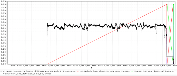

Hey there everyone!
I’m flight testing a quadcopter using a pixhawk2.1 cube running Px4.
We started using the auto land feature this week and for some reason, the vehicle always does something strange at the end.
It will appear to almost land (just barely making ground contact), then throttle up the motors again and translate slightly to one direction before finally landing.
I was wondering if anyone had any tips for diagnosing that or could help me root cause it?
Flight log of an example: [https://logs.px4.io/plot\_app?log=b48e48f9-56c4-45cc-8205-6c3b6cf7c1ec](https://logs.px4.io/plot_app?log=b48e48f9-56c4-45cc-8205-6c3b6cf7c1ec)
Thanks!
**Author:** ![Nicolas](https://discuss.px4.io/user_avatar/discuss.px4.io/nicolas/32/4467_2.png) [@Nicolas](https://discuss.px4.io/u/Nicolas)\
**Post date:** [February 9, 2018, 9:24am UTC](https://discuss.px4.io/t/short-hop-after-auto-landing/5672/2 "2018-02-09T09:24:20Z")
This could be the land detector. When you land it falls out of land detected state and then detects it again.
 ![](https://discuss.px4.io/uploads/default/original/2X/e/eb748817c7033749d3e47a6f857bfa2a08eade73.png)
Make sure you follow the tuning guide here: [Redirecting... Page moved](https://dev.px4.io/en/tutorials/land_detector.html)
Namely your hover thrust setting is at the default 0.5, while the log shows that your actual hover thrust is 0.6 - 0.65.

Thanks for the response Nicolas!
Curiously, adjusting the hover throttle up seemed to make the hop higher. Adjusting it down seemed to make the hop go away, so we’re still digging into why.
I’ll report back here once we’ve root caused it, but if anyone else has any ideas I’d appreciate the help.
