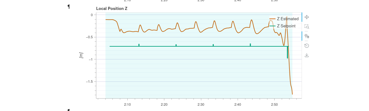

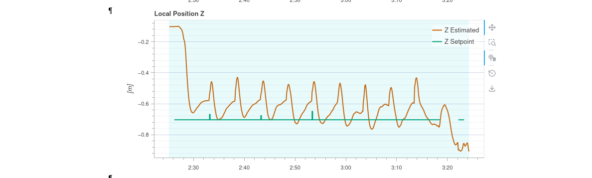

Yeah the hover thrust estimate uorb topic was never published but I checked it before flight and I think it only starts publishing during flight so I can’t say for sure if it worked during flight. I’m on release/1.16
MC_HOVER_Thrust_estimator was working before flight though,
You can check one of my logs from here, it’s in the same condition for hover thrust estimate
