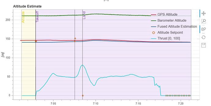

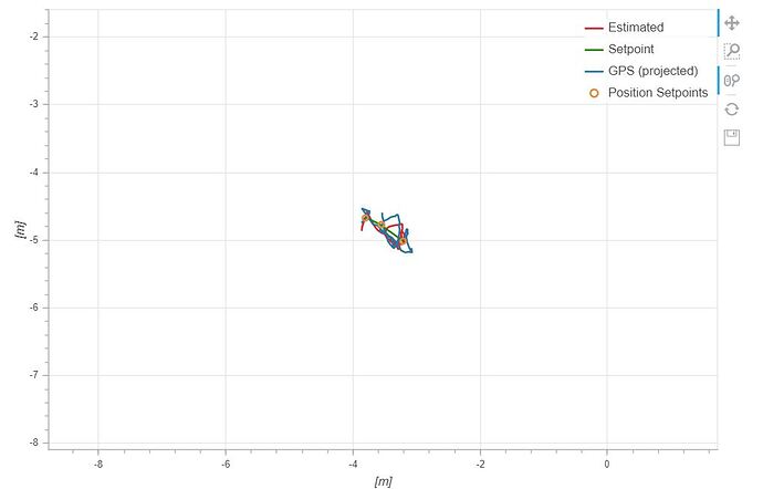

**Author:** ![FlyingToTheSpace](https://discuss.px4.io/user_avatar/discuss.px4.io/flyingtothespace/32/6784_2.png) [@FlyingToTheSpace](https://discuss.px4.io/u/FlyingToTheSpace)\
**Post date:** [August 9, 2020, 3:32am UTC](https://discuss.px4.io/t/quadcopter-skyrockets-when-i-publish-mavros-setpoint-raw-global/18051/3 "2020-08-09T03:32:24Z")
To, Jaeyoung-Lim
 ![Capture](https://discuss.px4.io/uploads/default/original/2X/2/2d60c834064833127554f9978680803bd8e17fba.jpeg) ![Capture2](https://discuss.px4.io/uploads/default/original/2X/3/358d40960e0a8011249913dd250879c330bd7b95.jpeg)
Following is the link that contains the full flight log.
[https://drive.google.com/file/d/1eKVmC-SF-JhIeSd8FjLq6Y5hLxGD8iVl/view?usp=sharing](https://drive.google.com/file/d/1eKVmC-SF-JhIeSd8FjLq6Y5hLxGD8iVl/view?usp=sharing)
Please let me know if there are any problems!
Thank you

**Author:** ![Jaeyoung-Lim](https://discuss.px4.io/user_avatar/discuss.px4.io/jaeyoung-lim/32/10829_2.png) [@Jaeyoung-Lim](https://discuss.px4.io/u/Jaeyoung-Lim)\
**Post date:** [August 9, 2020, 7:54am UTC](https://discuss.px4.io/t/quadcopter-skyrockets-when-i-publish-mavros-setpoint-raw-global/18051/7 "2020-08-09T07:54:27Z")
@FlyingToTheSpace So as suspected, the vehicle never went into offboard mode, and was just trying to takeoff
