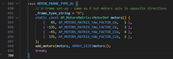

**Author:** ![emarcphera](https://discuss.px4.io/user_avatar/discuss.px4.io/emarcphera/32/21146_2.png) [@emarcphera](https://discuss.px4.io/u/emarcphera)\
**Post date:** [March 9, 2026, 8:15pm UTC](https://discuss.px4.io/t/quad-drifts-randomly-in-position-hold-px4/48559/14 "2026-03-09T20:15:26Z")
Hi, i think you meant CAL\_MAG0\_ROT as Pitch 180 right? If the orientations are detected correctly during the compass calibration routine then your rotation parameters are most likely correct, especially if it works in ardupilot. I did notice after setting CAL\_ACC2\_PRIO and CAL\_GYRO2\_PRIO to High , the post filtered gyro and accel values do look better to me, and consistent with moments in your previous flights where the estimator had this imu selected, these are good inputs for the estimator to have in general. I’ve never personally used ardupilot, but i’m assuming you chose frame class as quad and frame type as 3, i did skim through ardupilot’s src code and it’s setup for this configuration looks more simple than the H-frame config in PX4:
snippet in ardupilot’s AP\_MotorsMatrix.cpp:
 ![image](https://discuss.px4.io/uploads/default/original/3X/a/3/a3f23bceca4d3aa9c5fd2b01218f9650ba223b5a.png)
I could be missing something but it looks like this is all ardupilot does.
The H-frame config for px4 that you chose looks to be vehicle-specific
possibly this:
