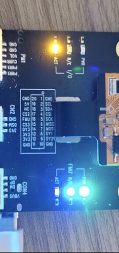

Dear all:
Recently I designed a new PIXHAWK V6C flight controller as standard, using a STM32H743 FMU processor and a STMF103 IO processor.
I tested both I/O-PWM-OUT and SBUS-IN and found that neither was useful, and then I found that both were set up on IO processors. So I burned the px4\_io-v2\_bootloader.bin through the IO debug interface, and then the yellow light on the I/O side kept flashing.
 ![fcc445fcccff2885bd7d884f36206e1a_compress](https://discuss.px4.io/uploads/default/original/3X/3/d/3d0d41902b7c879e5eb312d5de863ad8f7465623.jpeg)
By consulting the relevant information, I need to open a parameter called “SYS\_USE\_IO”, but I can’t find this parameter in QGC, and when I enter the relevant command in the MAVLINK console, the output is as follows:
> NuttShell (NSH) NuttX-11.0.0
> nsh\> ver all
> HW arch: PX4\_FMU\_V6C
> HW type: V6C005005
> HW version: 0x005
> HW revision: 0x005
> PX4 git-hash: 6ea3539157ca358c70a515878b77077af7d4611d
> PX4 version: Release 1.16.0 (17826047)
> OS: NuttX
> OS version: Release 11.0.0 (184549631)
> OS git-hash: 886acbbdb4f061e5c0ce1a76afbcfa7cb7df9849
> Build datetime: Aug 6 2025 15:07:26
> Build uri: localhost
> Build variant: default
> Toolchain: GNU GCC, 9.3.1 20200408 (release)
> PX4GUID: 0006000000003934393331335102001c0035
> MCU: STM32H7[4|5]xxx, rev. V
> nsh\> px4io status
> INFO [px4io] PX4IO Not Supported
> nsh\> px4io start
Now I have no clue about this problem, I hope someone can help if they encounter a similar problem, thank you!
