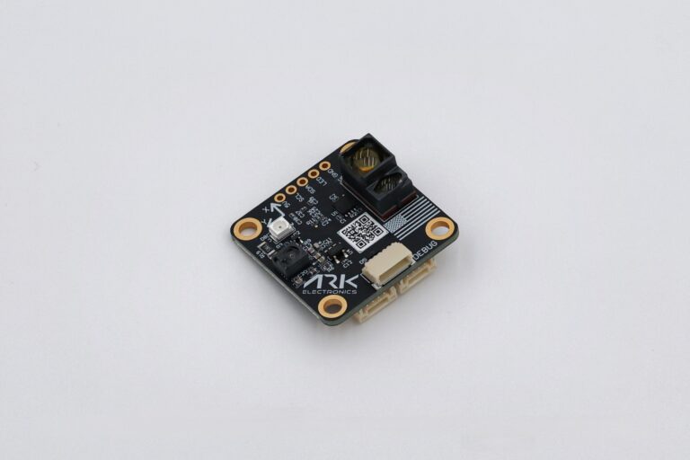

New ARK Flow MR is out:
> **[ARK Flow MR – ARK Electronics](https://arkelectron.com/product/ark-flow-mr/)**
