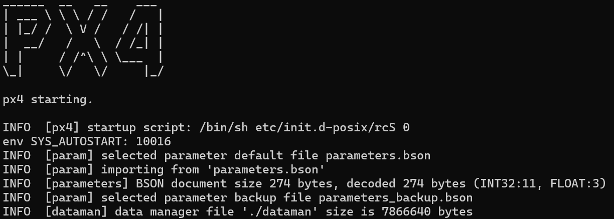

My situation was the following:
I am working on a SITL Simulation of a quadcopter using Matlab and PX4. At some point in the process, I have to send a uORB message from one Simulink instance (lets call it ‘Controller’) to another instance (lets call it ‘Plant’). The issue was quite unique in the sense that, running this specific setup is standard (like the [Monitor and Tune PX4 Host Target Flight Controller with Simulink-Based Plant Model](http://mathworks.com/help/releases/R2025b/uav/px4/ref/simulator-plant-model-example.html) example from Matlab), but on one of the computers I use to work on this problem I had the unique problem of this communication not being sent from the controller instance, to the plant instance.
### Investigation
On any other computer I tried, this setup would just work. The interesting thing is then, it is not a Matlab issue as far as I can see, however I’ve also comminated this to the aswel just in case. The specific issue boiled down to the following. In WSL (Windows Subsystem for Linux) I ran the the following command through the terminal while running the simulation:
`sudo tcpdump -ni any 'udp and (port 14580 or port 14540)'`
which allowed me to see the communication that occurred on the simulation ports (see [Simulation (PX4)](https://docs.px4.io/main/en/simulation/) for more information on this), here the interesting line is:
`lo In IP 127.0.0.1.14580 > 127.0.0.1.14540`
which is wrong. It should connect to some IP adress that the PX4 instance that automatically pops up when running "_Monitor and Tune"_ in Matlab:
 ![image](https://discuss.px4.io/uploads/default/original/3X/4/b/4b03e268c77ddb8db1e352f9aa5af312acbe8231.png)
The lines:
`INFO [init] PX4_SIM_HOSTNAME: 172.xx.xxx.x`
`INFO [simulator_mavlink] using TCP on remote host 172.xx.xxx.x port 4560`
Tells you the IP that it should be connected to, it should look like:
`eth0 Out IP 172.yy.yyy.yy.14580 > 172.xx.xxx.x.14540`
(I am not an expert in IPs and protocols, so I hope it is clear that 172.xx.xxx.x is the same as above, and the one with y’s is a different one, I am unsure if they can be the same, in my case they weren’t).
### The solution
Essentially what happens is that, some where in some configuration or setup script or something went wrong. The issue is that in the following directories (I am posting with nano so you can get to code that needs change):
`~/PX4-Autopilot$ nano ~/PX4-Autopilot/build/px4_sitl_default/etc/init.d-posix/px4-rc.mavlink`
and
`~/PX4-Autopilot$ nano ~/PX4-Autopilot/ROMFS/px4fmu_common/init.d-posix/px4-rc.mavlink`
there is a line (same line for both)
`mavlink start -x -u $udp_offboard_port_local -r 4000000 -f -m onboard -o $udp_offboard_port_remote`
which is missing `-t 172.xx.xxx.x` for both. So the solution was to go into both directories and change that line to: `mavlink start -x -u $udp_offboard_port_local -r 4000000 -f -m onboard -o $udp_offboard_port_remote -t 172.xx.xxx.x`
this fixed the issue and now it works every time.
