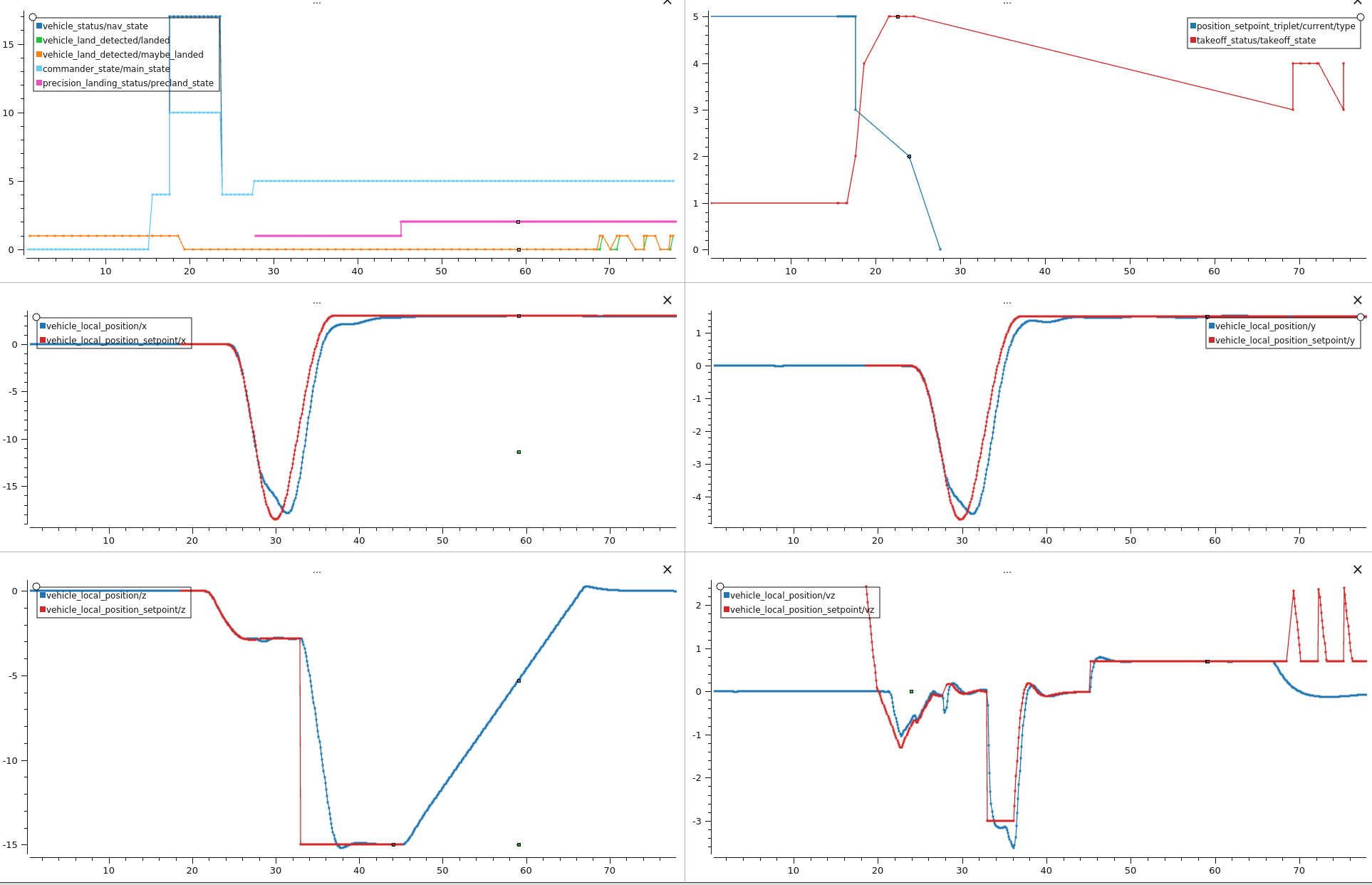

> \*\*Test data / coverage\*\*
> Testing is a bit tricky, as MAVSDK currently does not have the IR\_beacon message implemented and it's therefore not possible to create SITL tests. What I did is send the land\_target message from within PX4 and run manual tests.
> The following log shows how RTL is executed and the drone lands on a target at (x,y) = (3,1.5)
> !\[image\](https://user-images.githubusercontent.com/3762382/148576044-5b96082d-8844-4e91-bb03-a78f767d7b82.png)
> source: https://logs.px4.io/plot\_app?log=30855969-ae58-48a9-b06e-b33599a202eb
> Here we see the configuration where precision landing is required, but the target not visible. The drone will wait and "search" for the target where the time marker is located in the graphs. After the configurable timeout of 10 seconds is reached, the drone proceeds with the usual landing as instructed by Navigator:
> !\[image\](https://user-images.githubusercontent.com/3762382/148576452-210e39d8-1a56-493f-906d-7956799d1b35.png)
> source: https://logs.px4.io/plot\_app?log=f8da0f50-69e3-40f2-a687-d0520e74a6db
