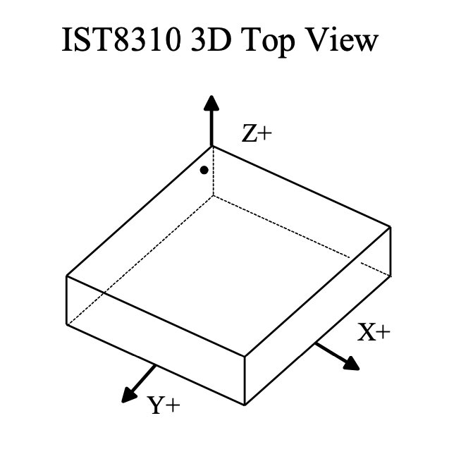

> The other thing to note here is that I'm changing the rotation convention to something that makes more sense (consistent with the other new drivers) and finally killing the copied "convention" from the original 3dr compass/gps.
> \<img width="327" alt="Screen Shot 2020-03-12 at 10 20 56 PM" src="https://user-images.githubusercontent.com/84712/76583516-c37c9e80-64af-11ea-836c-a5e3eca30375.png"\>
> The old driver kept z as is (down is up?) and swapped x & y.
> The "new" convention I'm going with is to always respect what's obviously up (-z in this case), keep X as an anchor, and then flip Y as necessary to maintain the right hand rule. https://github.com/PX4/Firmware/pull/14184#issuecomment-588273190
> The downside is having to update the rotations everywhere. The upside is it's quite a bit more intuitive to set it properly per board.

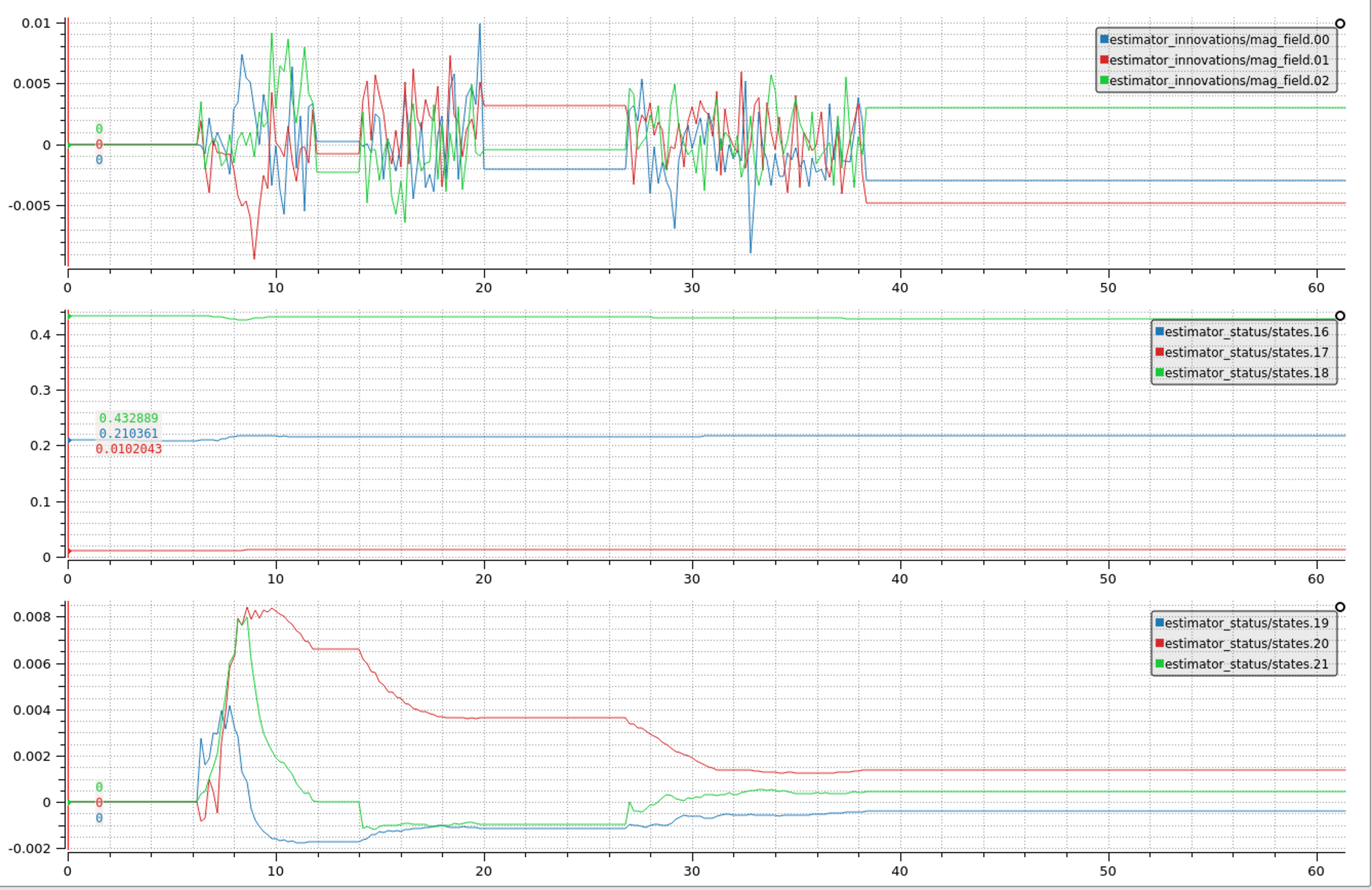

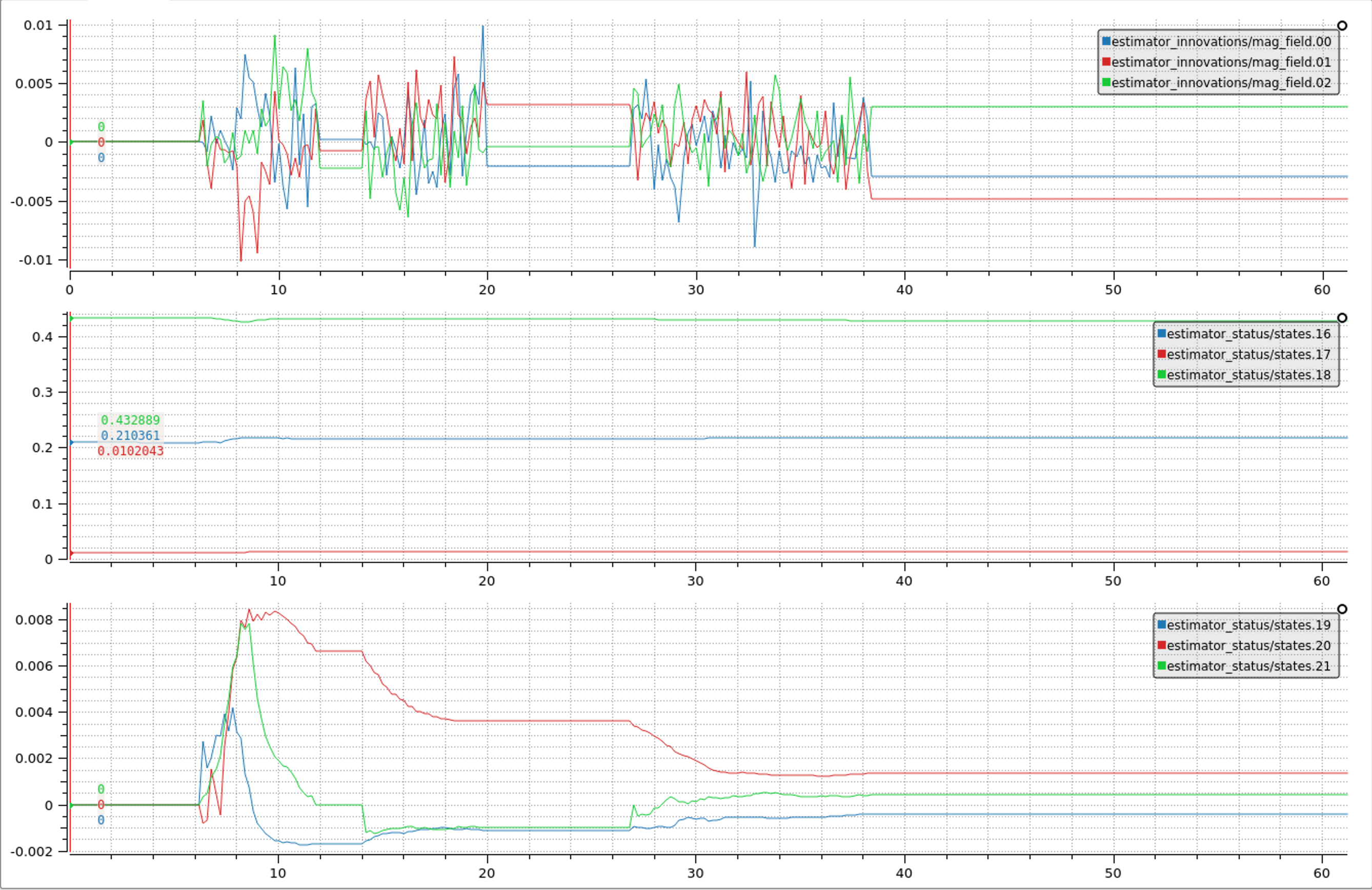

> Comparison of mag fusion innovations and field estimates before and after the change:
> Before:
> \<img width="1338" alt="Screen Shot 2020-07-30 at 2 59 46 pm" src="https://user-images.githubusercontent.com/3596952/88882463-5bb7cc00-d275-11ea-93d3-faef5fff6cea.png"\>
> After:
> \<img width="1338" alt="Screen Shot 2020-07-30 at 3 00 37 pm" src="https://user-images.githubusercontent.com/3596952/88882500-75591380-d275-11ea-9bb9-167c477afffa.png"\>

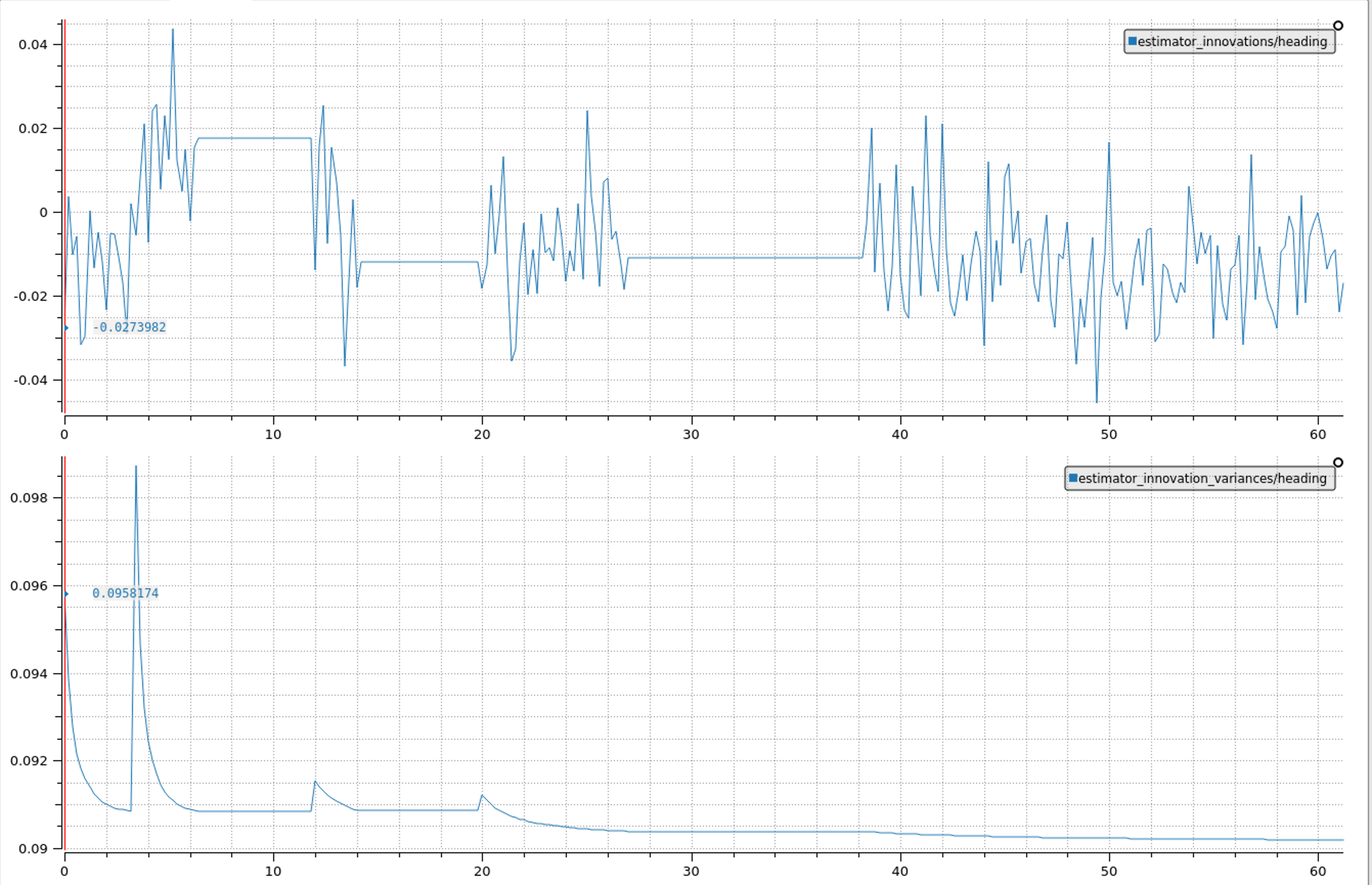

> Comparison of yaw innovations and innovation variances before and after the change:
> Before:
> \<img width="1333" alt="Screen Shot 2020-07-30 at 3 35 12 pm" src="https://user-images.githubusercontent.com/3596952/88884616-56a94b80-d27a-11ea-93cb-c18fd5893e3f.png"\>
> After:
> \<img width="1341" alt="Screen Shot 2020-07-30 at 3 33 40 pm" src="https://user-images.githubusercontent.com/3596952/88884504-1a75eb00-d27a-11ea-8cd9-6132b02e160d.png"\>
