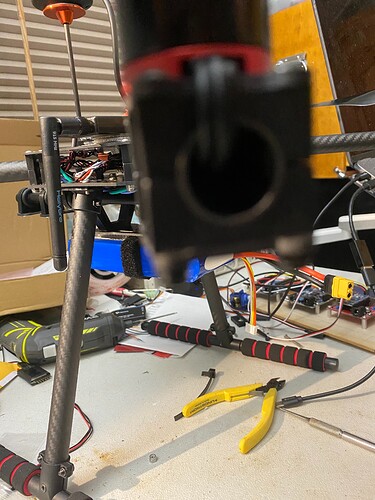

Hello everyone, this is my first drone build and first crash. Is there something obvious in here? During my flights that day it seemed to be intermittently slightly losing power then regaining normal flight. This was my first flight adding extra weight (2 cameras) to try and get some inflight footage.
My first flight (with the power “surges”) added 25.7 oz. then I removed the heavier camera and left the smaller one on which only weighed 5.6 oz. Previously I hadn’t experienced any surges like this.

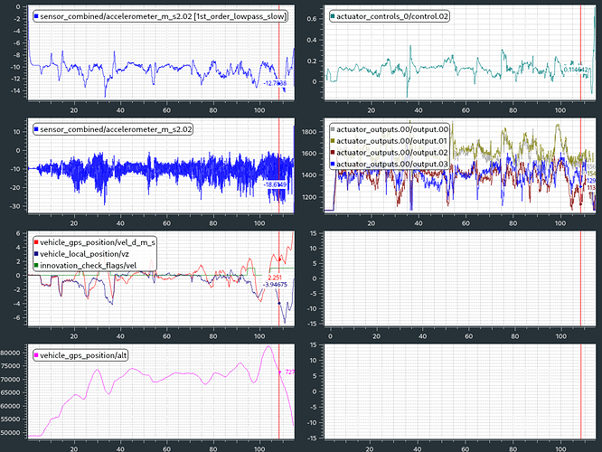

If you look at the first chart, the Fused Altitude Estimation shot up so the drone cut thrust to bring itself back down. This should normally follow the baro and gps pretty closely, but it does not.
Do you have some other altitude sensor on board?
I also noticed that the weight is not well distributed motors 1 and 2 have to work harder than 3 and 4.

ok hello one thing i can see from your pics that is totaly wrong is the ziptie over the flight contrloler get it off and recalibrate every thing all you need to hold this on is the 4 soft mounts that come with the px4 hope this helps

As @jimdgit said, the altitude drop is due to the estimated altitude diverging. The divergence is driven by the accelerometer that has a tendency to have an increasing (negative) bias during high vibration periods: you can see that in the low-passed acceleration plot (top left) the the value goes more negative, even if the drone goes down in reality.
Regarding the imbalance, since those motors are in diagonal, it means that the problem isn’t due to an off-centered weight but by a constant yaw torque disturbance (you can see the offset in yaw control signal; top right plot). This is usually due to wrongly tilted motors. Having this constant torque offset often degrades the roll/pitch stability and could cause the large vibrations you have.

I have the exact same air frame and have a similar problem with diagonal motors.
Since there is nothing on the frame I came to the same conclusion. Plus I could not figure how diagonal motors will do that.
I suspected bad motors because they are dirt cheap motors and the alignment looks as good as the other 2. I’d be interested to know your opinion
 ![bokeh_plot (1)](https://discuss.px4.io/uploads/default/original/2X/0/026cf8ed41999c6a39f6c9040e8586273abbe3d5.png)

Dang A slight adjust of the motors made a big difference. @BlackIce35 sight down the plastic motor block and align to the frame mounting blocks. They were only a tiny bit off.
 ![bokeh_plot (2)](https://discuss.px4.io/uploads/default/original/2X/0/0575b7f8ec9a2a92ba7c1c7f438557f6040e72dc.png)

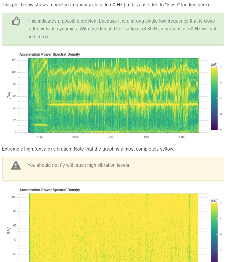

I noticed another chart of my log that shows just how much vibration I have going on. Here are good examples, bad examples, then my chart. [From the PX4 doc page on vibration](https://docs.px4.io/v1.9.0/en/log/flight_review.html#vibration)
 ![Good vibration](https://discuss.px4.io/uploads/default/original/2X/8/8f1550c4db65abc41dfd35db216a2f0a92b89bfd.jpeg) ![Vibrations](https://discuss.px4.io/uploads/default/original/2X/4/4cd7246841d753d6307246684aa5c330eb5539ef.jpeg) ![Vibrations2](https://discuss.px4.io/uploads/default/original/2X/5/50adbc19d3a0a7d5a72748a4c7ff630fc6487826.jpeg)
**And my chart below** :
 ![My Log](https://discuss.px4.io/uploads/default/original/2X/3/30daa7229a9779de27872afce5b10508c36f9df8.jpeg)
I’ll have to work on cleaning this up to some reasonable levels.

Like I said sight down the motor mount blocks - the plastic pieces that hold the motor mount to the rod and align to the rod mounting blocks on the frame.
The picture looks off because of the wide angle lens but this is how I did it:
 ![drone](https://discuss.px4.io/uploads/default/original/2X/4/4dc7b9a2ef7f578dda8b4a12632f8b799328bdcc.jpeg)
