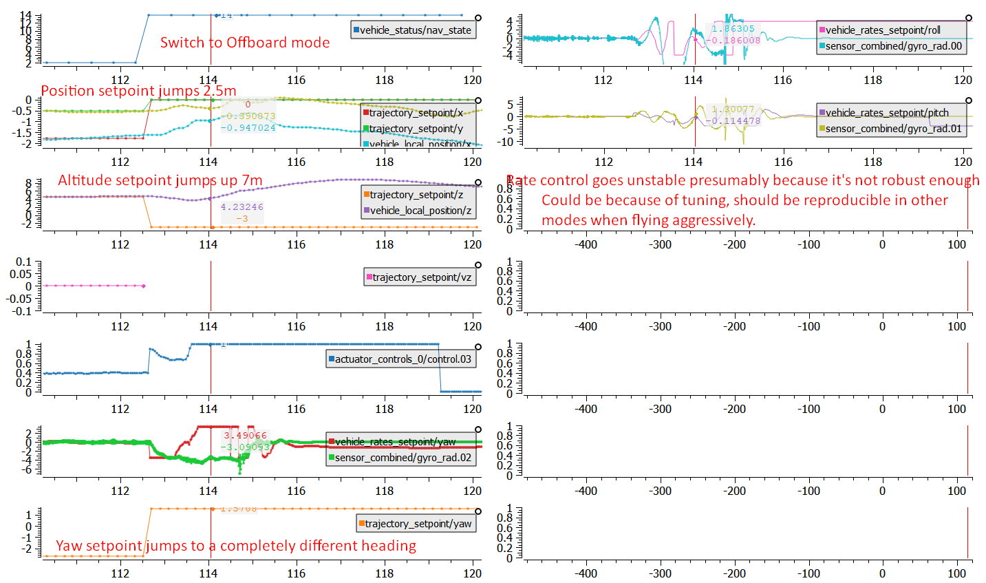

Analysis from Matthias:
 ![image](https://discuss.px4.io/uploads/default/original/2X/0/039d9963c797986b35b52e737c0999e1bb513154.png)
> Try to find the rate control issue in Stabilized/Manual mode by flying aggressively. If found try to tune such that it does not get unstable in this case.
When switching to offboard initialize the setpoint with the current vehicle state and then start moving it gently when you were able to take over.
