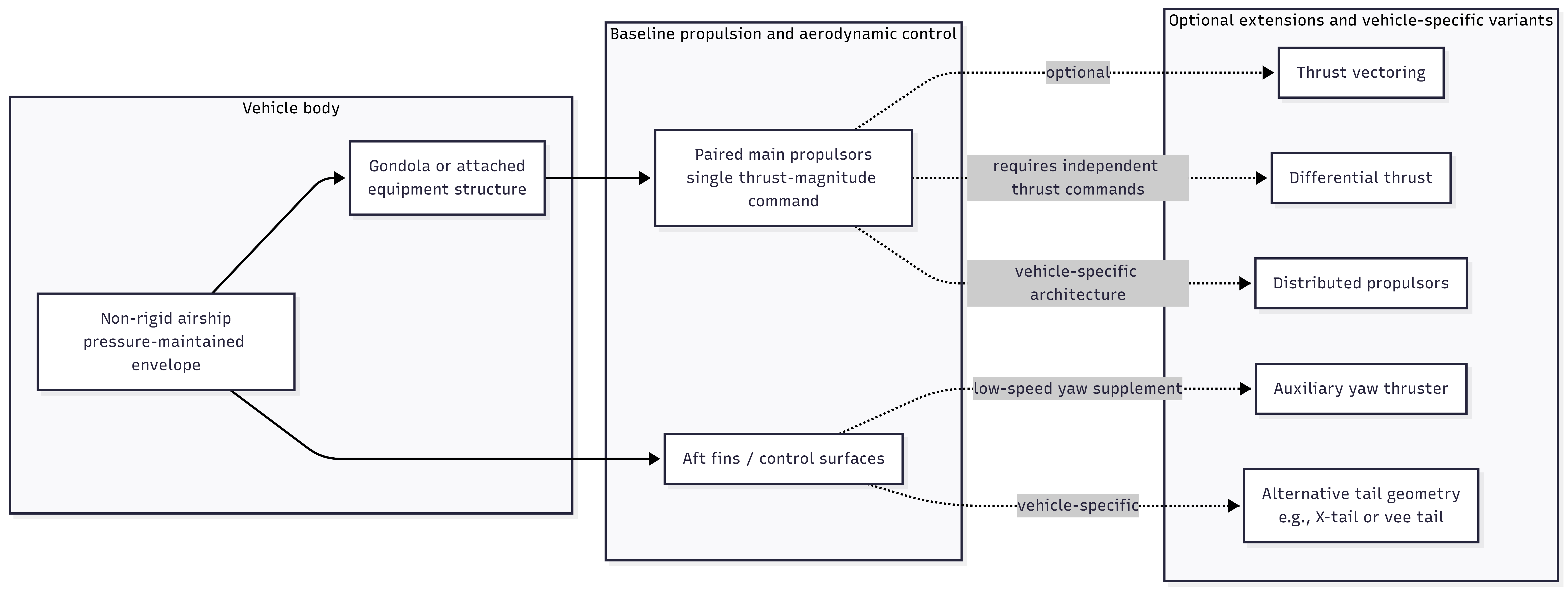

Update: I created a small reference repository for the non-rigid airship baseline I am using as background:
> **[GitHub - linearust/non-rigid-airship-reference: Technical reference material on non-rigid airship...](https://github.com/linearust/non-rigid-airship-reference)**
> Technical reference material on non-rigid airship configuration and motion-control actuator concepts.
Before proposing generic airship support in PX4, I would like to sanity-check the vehicle-level baseline.
The simplified concept is:
- non-rigid airship with a pressure-maintained envelope,
- gondola or attached equipment structure,
- paired main propulsors, initially treated as a single thrust-magnitude command,
- aft fins / control surfaces.
Examples of features I would keep outside the initial baseline unless needed for a specific vehicle include:
- thrust vectoring,
- differential thrust,
- auxiliary yaw thruster,
- vehicle-specific tail geometry, including but not limited to X-tail or vee-tail,
- distributed propulsors.
 ![Non-Rigid Airship Control-2026-06-15-101040](https://discuss.px4.io/uploads/default/original/3X/2/1/215e18fbf7ba9b1f4fee8d4f50038bd9c9a96553.png)
Feedback welcome: does this look like a reasonable baseline to discuss before implementation?
