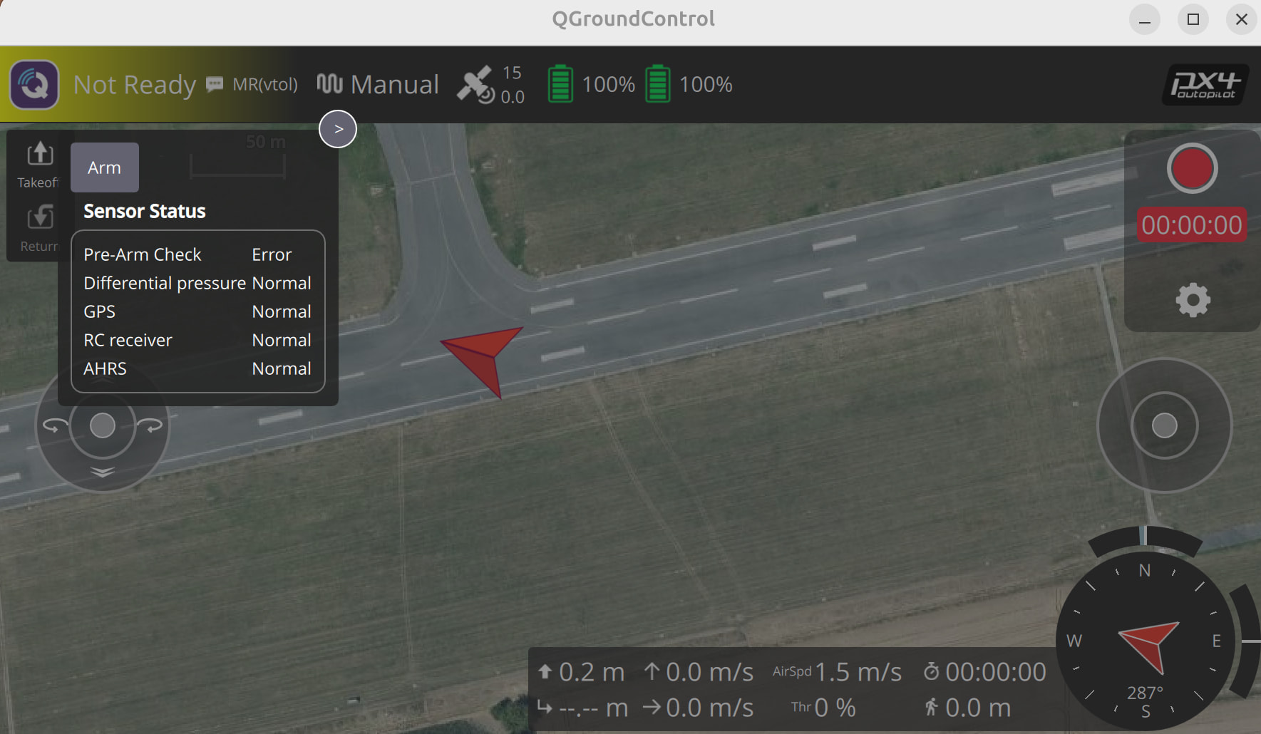

Hi, problem with 1.11 version, it says prearm-check error and i cant switch to position mode.
But i couldnt find what is the problem, i did what is written in 1.11 documentation about prearmcheck parameters CBRK_IO_SAFETY 22027, COM_PREARM_MODE = 2 and other combinations.
I check ekf2 and its not started but sensors are okay. You can see pxh outputs below

pxh> ekf2 status
INFO [ekf2] local position: invalid
INFO [ekf2] global position: invalid
INFO [ekf2] time slip: 41493 us

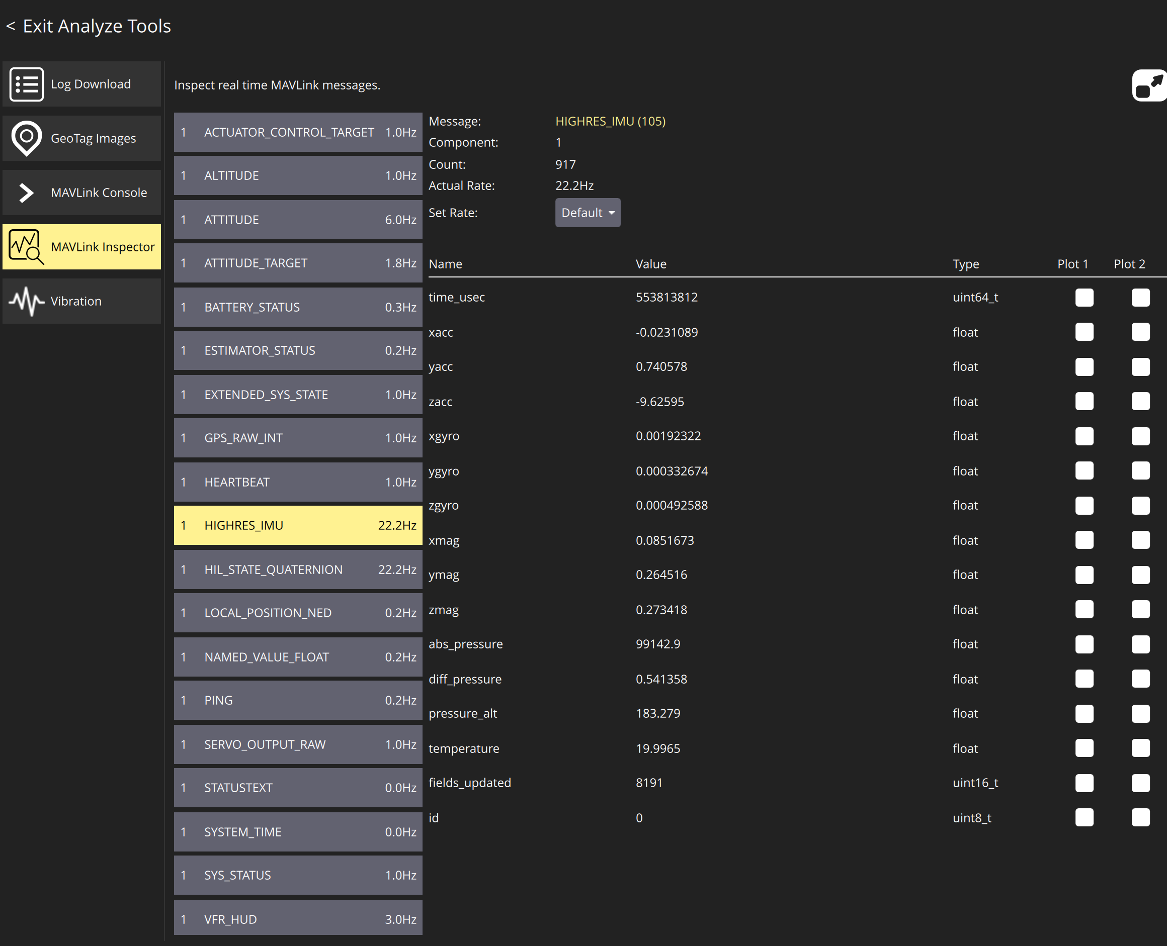

pxh> listener sensor_combined
TOPIC: sensor_combined
sensor_combined_s
timestamp: 1045203847 (0.000524 seconds ago)
gyro_rad: [0.0019, -0.0001, -0.0001]
gyro_integral_dt: 4743
accelerometer_timestamp_relative: 0
accelerometer_m_s2: [0.0221, 0.7370, -9.6318]
accelerometer_integral_dt: 4743
accelerometer_clipping: 0

I suggest to use something newer, like 1.15.4 or 1.16.0 because the pre-arm checks have improved a lot since. They were tricky to debug back then and often sorta silently failed.
