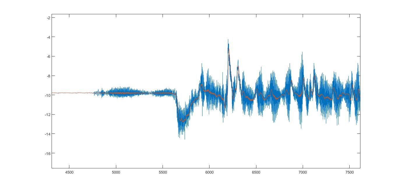

I also used a filter to process the acc raw data. And the result is attached.
 ![](https://discuss.px4.io/uploads/default/original/1X/92cbad2dae348925a21200fcb963f0641d48c76d.jpg)
The red one is filtered data, with blue one raw.
My problem was whether this red one is good to use in the position estimator module? Since both the ekf2 and inav use the acc to predict the state. Large deviation make lead to bad prediction and I am not sure if the correction step could pull the estimation back to the good value.
Oh, and any filter would have a delay effect, does it matter?
I will try the new pull and test.
Thank you very much.
