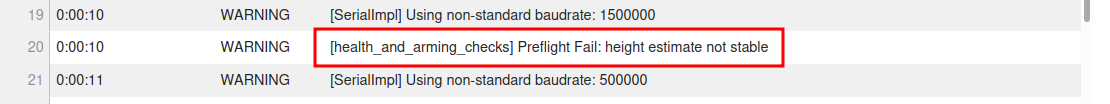

Hi, the crux of the problem is this
When you connect Pixhawk 2.4.8 to a computer in QGround control, everything works (ready for flight, engines start) when you disconnect Pixhawk 2.4.8 from the computer, it starts flashing red and when you turn on the stick in the ARM, it emits a beep while continuing to flash red. What could be the problem, where to dig Thanks!

I cleaned the logs, set the parameter, and after rebooting (connecting/disconnecting from the PC) in three files
**Post date:** [December 9, 2025, 1:47am UTC](https://discuss.px4.io/t/pix-2-4-8-qgroundcontrol-please-help/48067/4 "2025-12-09T01:47:39Z")
1
 ![image](https://discuss.px4.io/uploads/default/original/3X/0/c/0c86afa3fd9df840cb915b05baa88e5de8ee14f5.png)
2
not sure 🤷‍♂️
3
![image](https://discuss.px4.io/uploads/default/optimized/3X/0/1/01524436534f972bfdd79831e01366e037a8e043_2_690x55.png)
Not sure why that happens. I would probably try a more recent PX4 version like 1.15.4 or 1.16.0.
