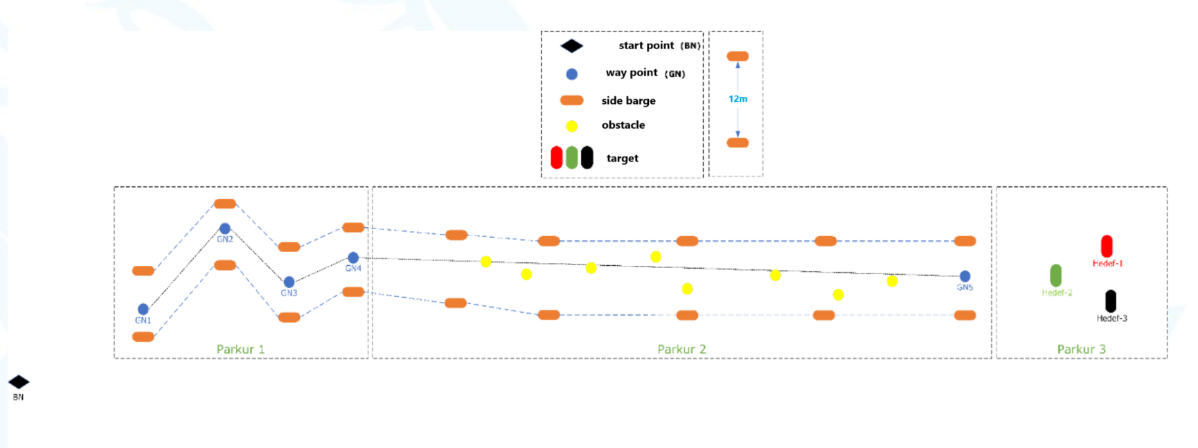

My team and I are developing an unmanned surface vehicle (USV) for a university competition. Our USV is a catamaran equipped with a Jetson Nano for processing. The total budget for our vehicle, including all components, is $1900.
Competition Task
The goal of the competition is to autonomously navigate through a parkour with various obstacles. The USV must:
  • Detect and classify obstacles,
  • Plan a route around them,
  • Complete the parkour as quickly as possible.
I have attached a file with the parkour details for better context.
