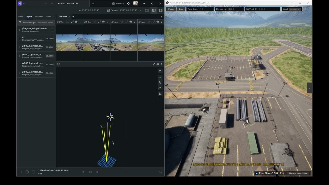

I recently tested Foxglove as a live viewer for PteroSim camera streams over ROS 2.
Demo:
[![](https://img.youtube.com/vi/03gtvPmMSF8/maxresdefault.jpg "4 Drones stream with PX4 and ROS2 to Foxglove") ](https://www.youtube.com/watch?v=03gtvPmMSF8)
We flew four x500 quadcopters, each running its own PX4 instance, in a 2.5 m orbit around a shared center. The vehicles were pointing inward, so each gimbal camera could see the other three.
The cameras were running at 768×480 and 30 FPS. PteroSim encoded the video to H.264 using NVENC and sent it over RTP/UDP.
ROS 2 Humble was running in WSL2 on Ubuntu 22.04 with mirrored networking. A small Python bridge forwarded the H.264 stream without decoding it and published it as `foxglove_msgs/CompressedVideo`. Vehicle poses were published through `/tf`, and `foxglove_bridge` exposed everything to Foxglove on Windows.
We initially tried sending raw `rgb8` images through DDS. At this resolution, each frame was around 1.1 MB, and with the default Linux UDP buffers we were losing around 40–50% of the messages.
H.264 worked much better for this setup.
We also ran into a DDS discovery issue. Fast DDS, which is the default in ROS 2 Humble, did not discover the nodes correctly with WSL2 mirrored networking. Switching to Cyclone DDS fixed it.
With all four video streams running at the same time, we were getting around 27 FPS per camera on average, compared with the 30 FPS target.
The test was done on:
- Intel i9-14900HX
- RTX 4090 Laptop GPU 16 GB
- 64 GB RAM
- Windows 11 + WSL2
- ROS 2 Humble
Has anyone else tried a similar multi-vehicle camera setup with PX4 and ROS 2?
