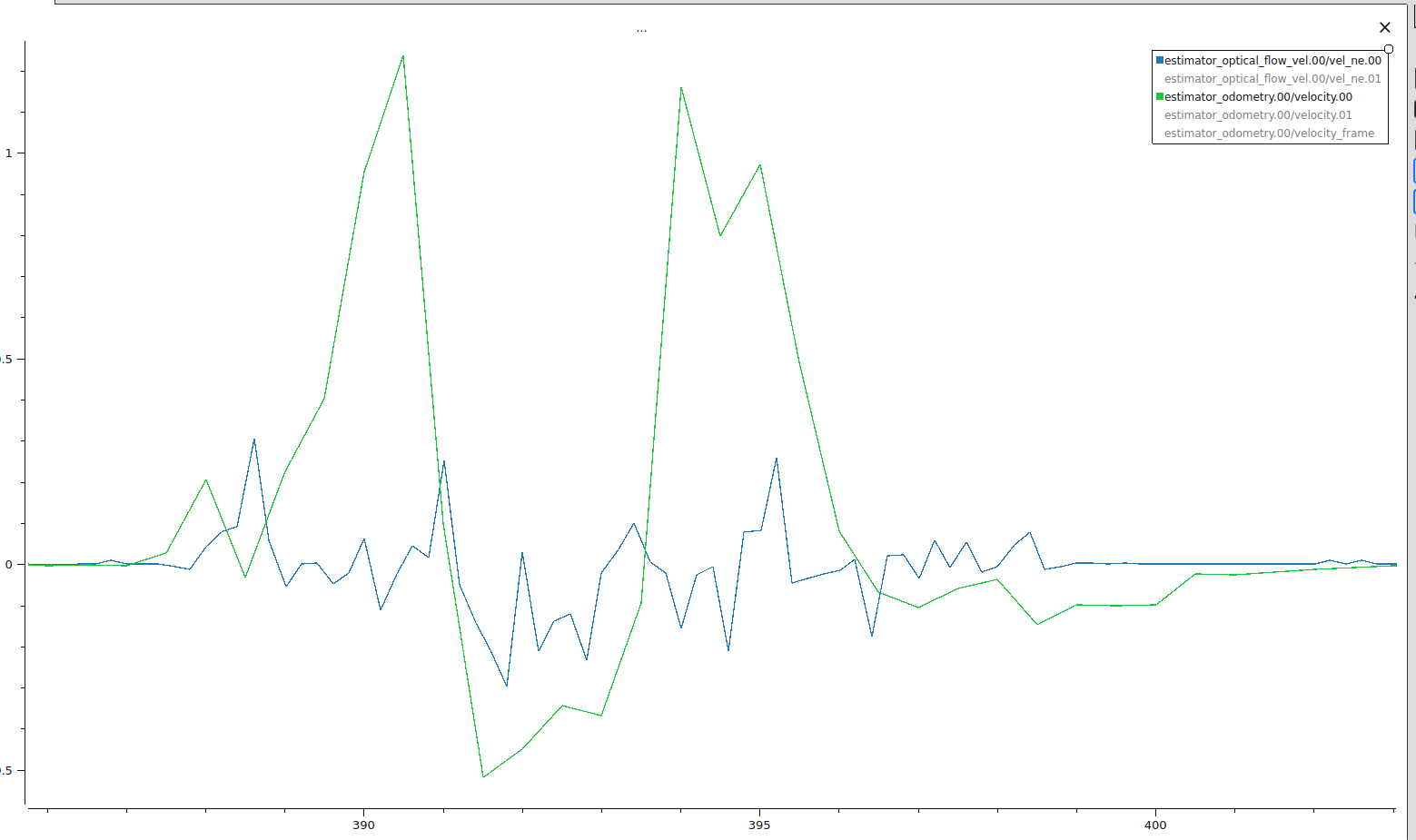

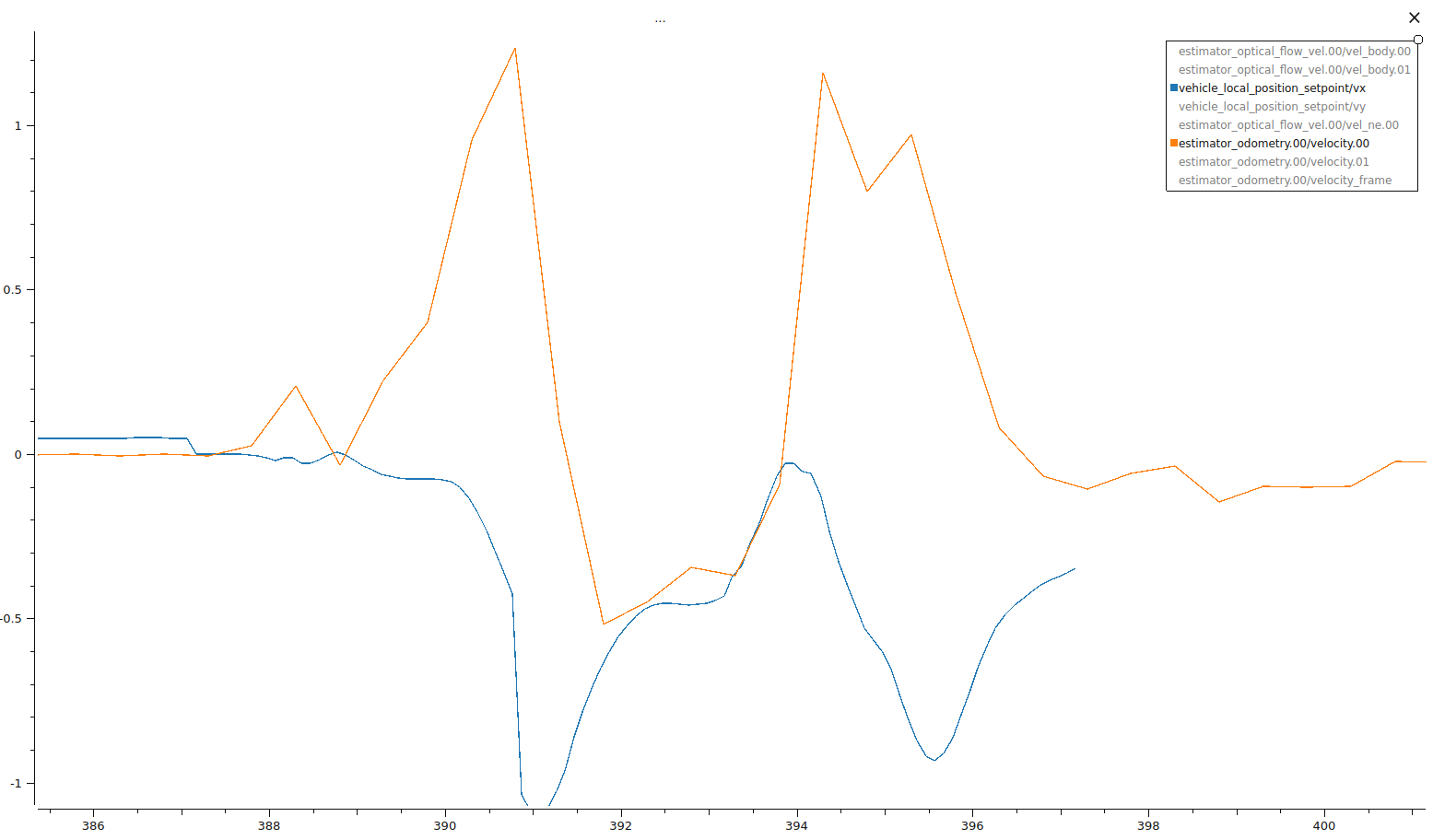

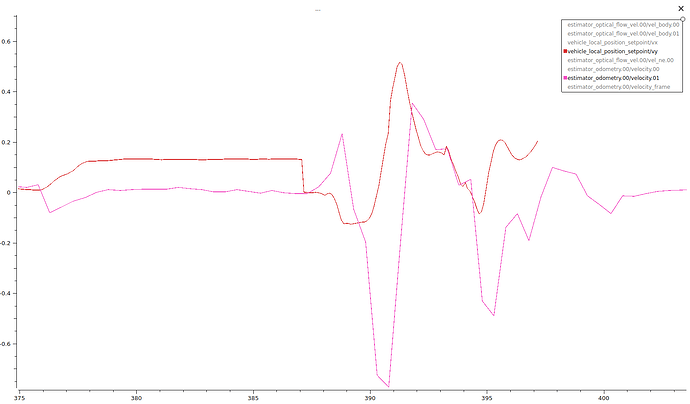

I am experiencing what seems to be large instabilities in the velocity estimators. Velocity estimates and setpoints appear to be fighting each other. For both x and y estimates, when the vehicle estimates it’s moving significantly in one direction, the setpoints immediately get set to the opposite direction. The velocities and setpoints appear to be somewhat oscillating as shown in my plots? If they are oscillating then its oscillating larger than then the room causing crashes. Currently, the drone initially goes forward and to the left, then the setpoints bring it back to backwards and to the right. The drone does not seem to know it has reached the setpoints until it crashes into a wall.
Flight Review: [https://review.px4.io/plot\_app?log=009075a3-6b5d-44c6-a97a-f46dc67feeee](https://review.px4.io/plot_app?log=009075a3-6b5d-44c6-a97a-f46dc67feeee)
- I’m running this indoors with only optical flow sensor, no GPS.
- I’m using the Holybro H-Flow optical flow sensor
- Using offboard mode.
- For the logs, flight begins around 385 seconds and crashes around 395 seconds.
Questions:
- The current theory is that the optical flow sensor isn’t picking up enough features to accurately estimate the velocity, probably due to a smudge or a scratch on the lens. I’ve seen [other posts](https://discuss.px4.io/t/optical-flow-oscillations/36455/5) describe taking off the glass covering to the camera of the optical flow sensor as a possible solution. Is this worthwhile to do or would I just be breaking an expensive sensor?
- For the optical flow sensor, how much does the quality metric correspond to optical flow performance? What range should it be in to be considered functional?
- Is there any parameters I can set to mitigate this optical flow issue?
- What else can I look to in order to trouble shoot this?
x velocity vs setpoints:
 ![Screenshot from 2025-12-12 11-37-18](https://discuss.px4.io/uploads/default/original/3X/5/b/5b8262b40ccefe21d1b9a0aa74f42557fcbd4e4e.png)
y velocity vs setpoints:
 ![Screenshot from 2025-12-12 11-38-42](https://discuss.px4.io/uploads/default/original/3X/4/c/4c501137ae07bda402b19b3f77df5c5ca1203c01.png)

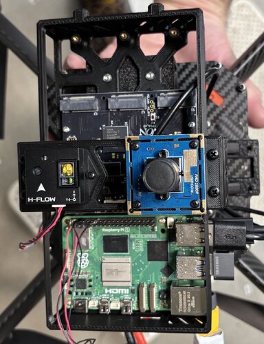

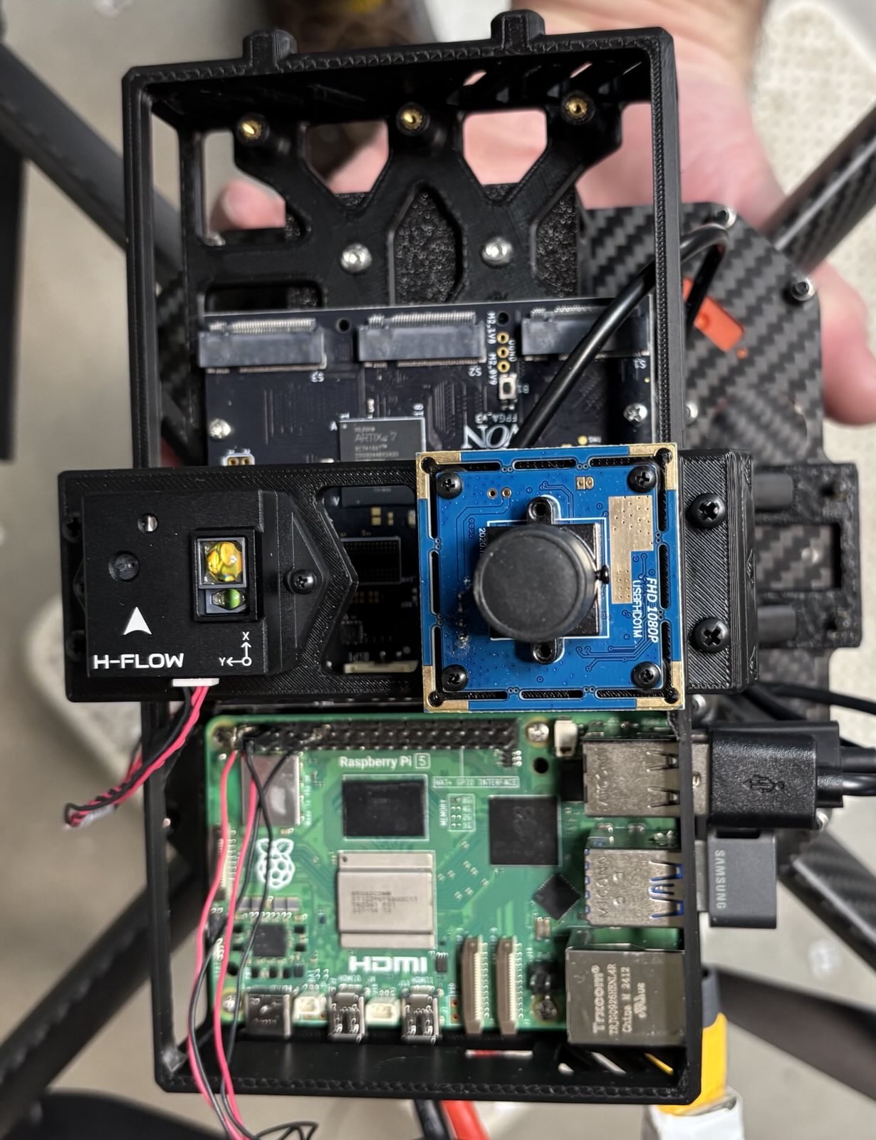

Have you verified the orientation is set correctly?
**Author:** ![Isaac\_Ahlgren](https://discuss.px4.io/user_avatar/discuss.px4.io/isaac_ahlgren/32/20447_2.png) [@Isaac\_Ahlgren](https://discuss.px4.io/u/Isaac_Ahlgren)\
**Post date:** [December 15, 2025, 4:31am UTC](https://discuss.px4.io/t/large-velocity-divergences-with-optical-flow-velocity-estimates-and-setpoints-oppose-each-other-causing-crashes/48110/3 "2025-12-15T04:31:08Z")
I appreciate the response!
Yes. Currently, the h-flow has an arrow on the sensor indicating the direction it should be facing, it is facing the same direction as the arrow for my orange cube plus.
**Post date:** [December 15, 2025, 3:53pm UTC](https://discuss.px4.io/t/large-velocity-divergences-with-optical-flow-velocity-estimates-and-setpoints-oppose-each-other-causing-crashes/48110/4 "2025-12-15T15:53:04Z")
(picture for proof, up is forward for the controller)
 ![IMG_5327](https://discuss.px4.io/uploads/default/original/3X/c/f/cfffb7d8b37e5227a89fe1ec02ec5f7a98bcfc76.jpeg)

Looks as if the optical flow velocity is uncorrelated with estimated velocity. Also does not seem to correlate to any specific direction as well, which shouldn’t be the case.

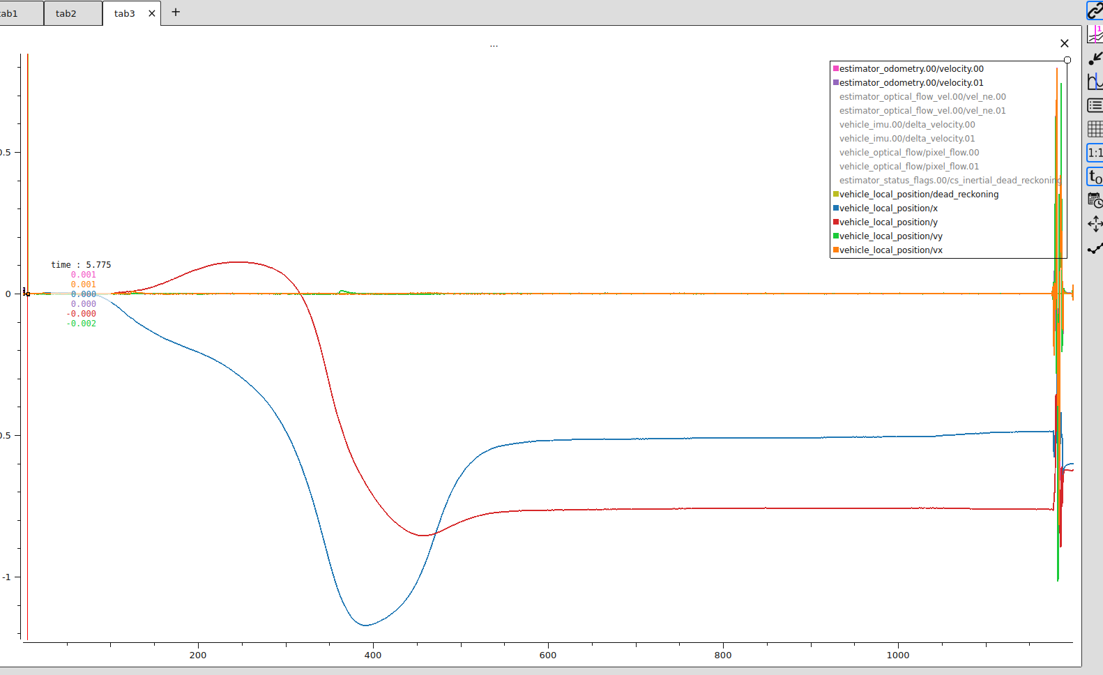

**Post date:** [December 16, 2025, 5:55pm UTC](https://discuss.px4.io/t/large-velocity-divergences-with-optical-flow-velocity-estimates-and-setpoints-oppose-each-other-causing-crashes/48110/8 "2025-12-16T17:55:13Z")
Maybe a hint or not, but the divergence of the x and y position before the test are pretty extreme as well without any fluctuations to the velocity. It’s not even in inertial dead reckoning.
