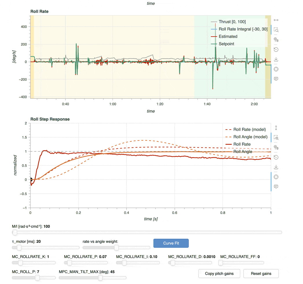

Hi everyone,
Sharing a cool tool we’ve built at Altitude R&D: PID-Wise. Upload a .ulg (PX4 v1.12+) and get step response and curve fitted model with interactive PID tuning — see the effect of a gain or filter change before you flash it.
Supports standard multicopters and ArduPilot .bin (4.0+).

Still early days — genuinely want feedback, bugs, and edge cases. Happy to here your first impressions.
![pid-wise](https://discuss.px4.io/uploads/default/original/3X/1/1/11312a7e94502435ff10b52842420a618635364d.gif)

**Post date:** [October 3, 2026, 4:32pm UTC](https://discuss.px4.io/t/introducing-pid-wise-interactive-pid-tuning-from-a-logfile/49449/2 "2026-10-03T16:32:08Z")
Looking at the full animation rather than a single frame changes the interpretation a bit. The fitted roll model appears to match the measured step response reasonably well after fitting (`M/I ≈ 1179`, motor time constant ≈ `12.4 ms` in the shown fit).
The larger excursions in the flight trace also appear to contain substantial commanded rate changes, so I would be cautious about interpreting those peaks as rate-controller instability from this plot alone.
What I would check next is whether the fitted model remains consistent across several clean excitation intervals and different thrust levels. If the identified `M/I` or effective motor time constant changes substantially with operating point, a single fitted model may hide that dependency.
It would also be useful to compare the rate setpoint, measured angular velocity, actuator/control-allocation output and saturation status around one clean excitation.
If the ULog is available, that would make it possible to distinguish model-fit error from actuator saturation or an operating-point-dependent response.

Hello and thanks for your review.
Motor saturation is already displayed as orange box over the plot, as shown in the following figure. The idea is to select a portion free from saturation for curve fitting.
Regarding operating points at different thrust level, are you thinking of adding a payload to the vehicle? In the case the M/I might change slightly by the added mass and therefore added inertia.

Hi Romain,
Thanks for the clarification. I had not accounted for the orange saturation regions already shown in PID-Wise. Excluding those intervals from the fitting process makes sense.
Regarding the operating point, I was not necessarily referring to adding payload.
I was thinking primarily about different collective thrust levels on the same vehicle, with unchanged mass, inertia and hardware configuration.
Even without a payload change, the effective relationship between motor commands, rotor speeds and generated torques can vary with the operating point.
For that reason, I would be interested in whether the fitted M/I coefficient and motor time constant remain reasonably consistent when you select several clean, unsaturated excitation intervals at different collective thrust levels.
A simple comparison could be:
- Select low-, medium- and high-thrust intervals from the same flight.
- Exclude saturation and major transients unrelated to the excitation.
- Fit the model independently in each interval.
- Compare the identified parameters and, ideally, their ability to predict responses in the other intervals.
If the fitted parameters remain stable, that would support using a single model across those operating points. If they differ significantly, it could reveal an operating-point dependency or a limitation of the identification model.
Adding payload would be a separate experiment because it can also change the vehicle inertia.
I think this could be an interesting validation feature for PID-Wise, especially when assessing how representative a selected fitting interval is of the wider flight envelope.
