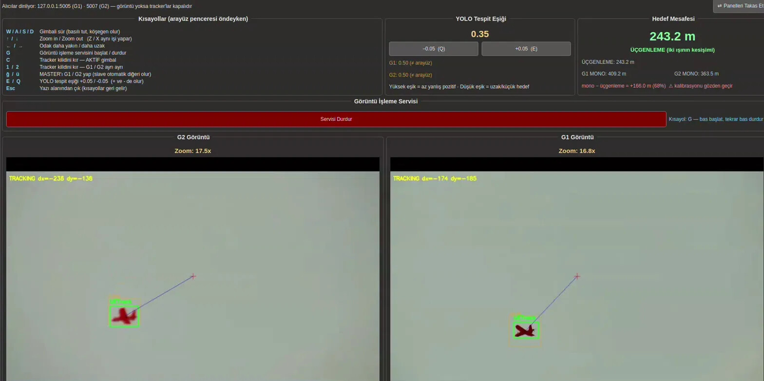

PX4 Intercept flight mode make this possible from end-to-end. 2 gimbal camera on ground with high zoom rates searching the area and when a threat detected, ground station start calculating target global position by using their own local position. Here system architecture shown
 ![image](https://discuss.px4.io/uploads/default/original/3X/1/1/1166d2caff62dc3c870111a060f2d2fcd0a90ef7.jpeg)

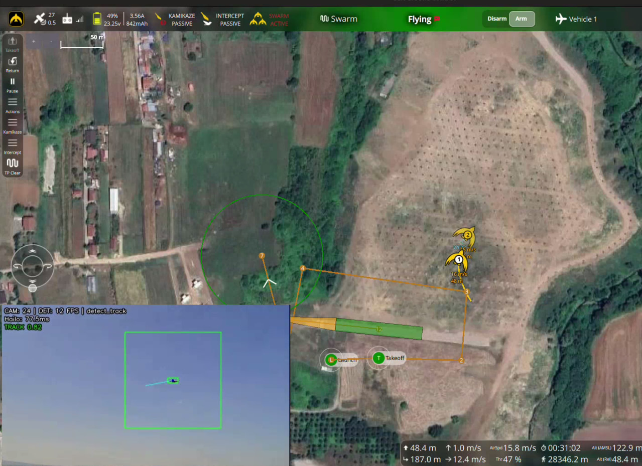

This GUI showing detected target and required states about it. When both of the gimbals detect target GCS (modified QGroundControl) start publishing target position over an LTE mesh to interceptor air vehicles. And until interceptors see the target on their onboard gimbals navigating with position coming from GCS.
 ![image](https://discuss.px4.io/uploads/default/original/3X/e/3/e3906a112fd3ae8d16b40a45d24326d7aefff27d.jpeg)

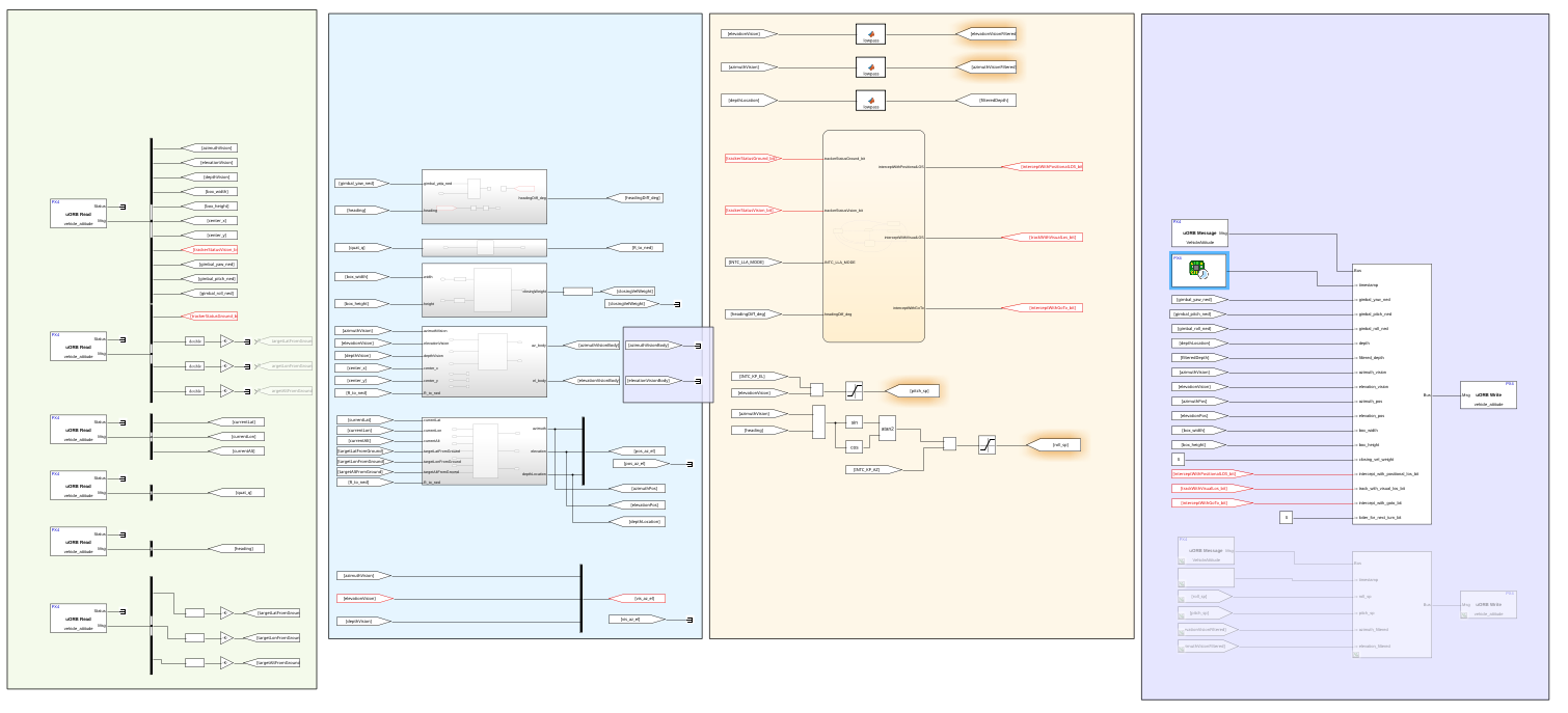

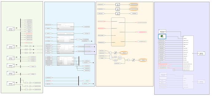

Intercept flight mode consumes image processing outputs from MMC and calculates guidance commands. Some parts of Intercept mode implemented directly on PX4 stack like all other modes. And logic state-flow part implemented in simulink and integrated with PX4 by using code generation.
This model manage desired tracking source and type by using ground and air gimbal tracker status bits.
 ![image](https://discuss.px4.io/uploads/default/original/3X/9/e/9e915bc70a63c5f3b8779ec0223d8439ed2706c0.png)
And second part of the Intercept flight mode implemented with its own navigator, pos control, mode management layers just like other flight modes. And consumes management decisions from simulink model and start intercepting the target.

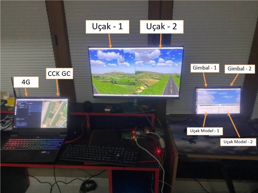

First of all development process we have build simulation environment that contain all flight instruments in a HITL environment
- FCC
- MMC
- 4G/5G LTE system
- Identical model of SIYI Gimbals SDK (one air two ground gimbal)
- Nonlinear dynamic model of air vehicle.
 ![image](https://discuss.px4.io/uploads/default/original/3X/a/0/a073f120dc38e502ec31d2f39e306578b5649845.jpeg)

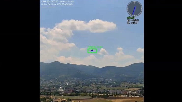

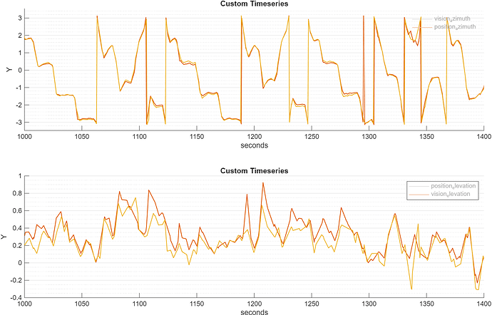

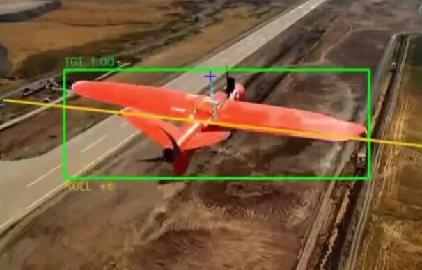

Image processing is seperated completely from flight management like a black box. FCC only listen desired image processing outputs and runs intercept mode. As we said seperating MMC and FCC tasks properly results very clean architecture.This is exactly where that separation becomes valuable. To verify image processing outputs sign convention for navigation calculations we conducted test flights with known target. By comparing real sensor data (position, speed, roll angle etc.) from target and image processing outputs verified that intercept flight mode will take proper data from MMC. (Also by using an intermediate verification intercept flight mode operated in shadow mode to see what it calculating.) You can see a video here our plane following the other plane in swarm flight mode (May be we can share swarm mode in another post) and resulted los vectors calculated from image processing and directly calculated from target location.
Image processing outputs verification flight : (After 1.11m)
[![](https://img.youtube.com/vi/eshash-lMUY/maxresdefault.jpg "PX4 Swarm Intercept Flight Mode over 4/5G mesh") ](https://www.youtube.com/watch?v=eshash-lMUY)

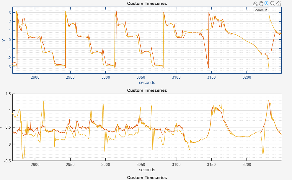

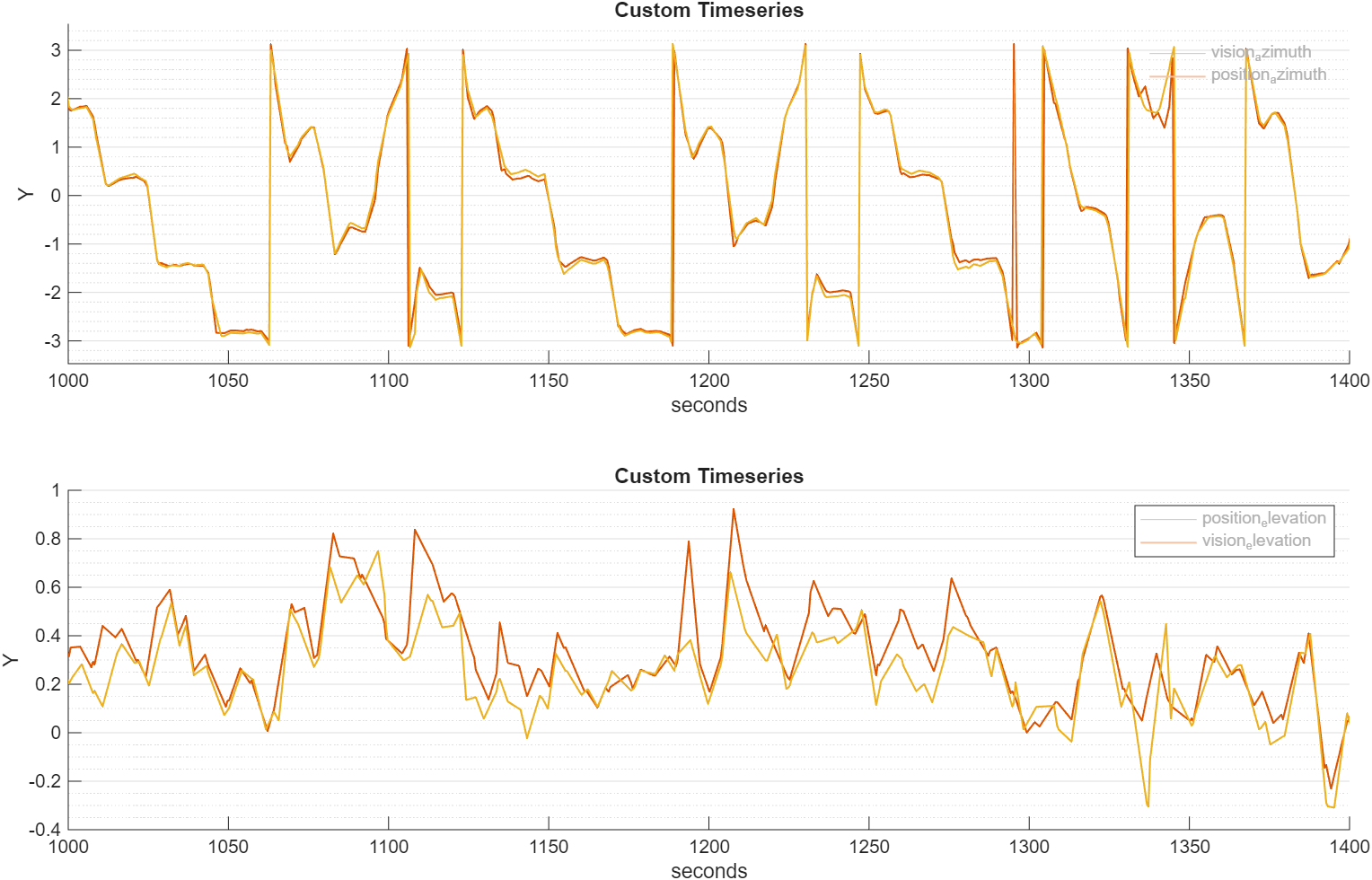

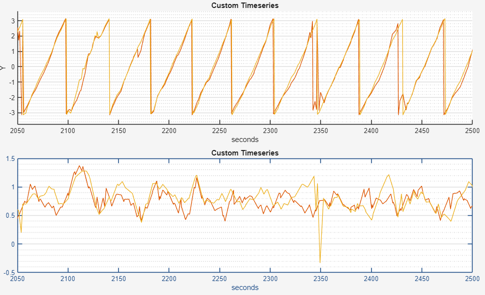

And here you can see calculated los vector comparisi between image processing and direct target gps location. So you can verify that image processing producing correct direction into target. Some filtering process to smooth the result of course needed.
**Loiter following**
 ![image](https://discuss.px4.io/uploads/default/original/3X/a/0/a0cd609ccaa51f2b4eebb3abcca51df5766b21b4.png)
**Square following**
 ![image](https://discuss.px4.io/uploads/default/original/3X/3/2/32dcaa1a09dfd92bbcbd52e7e62249cf0c4a11e7.png)
**Figure eight following**
 ![image](https://discuss.px4.io/uploads/default/original/3X/2/9/298ab89f6cab513051abd34a7441c67822d793ea.png)
