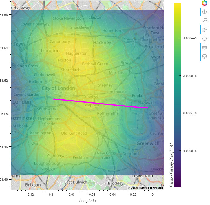

I am working on an open-source application in conjunction with a university. Its main function is to produce risk maps based on census data, transient road data and other sources. From there specific weather and flight conditions, as well as aircraft parameters, can be implemented and a “fatality risk per hour” map can be produced.
In the app, this map is used to feed into pathfinding algos and find optimum paths with the least fatality risk for drones to go along. I wondered whether this might be something that can be implemented into QGroundControl and if anyone had any tips on how to get started with it. The Source code can be found here: [GitHub - aliaksei135/seedpod\_ground\_risk: Ground Risk model for UAS flight path analysis and risk-aware pa](https://github.com/aliaksei135/seedpod_ground_risk) . Looking forward to getting it implemented as a future in QGround Control as hopefully it can be used to inform on safe areas to fly in your area!

Could you describe with screenshots, what’s the output of the ground risk algorithm. Are these colored polygons or rectangles (vector data)? Or is it pixel oriented maps?

Hi there, apologies for the late reply, I have been on leave.

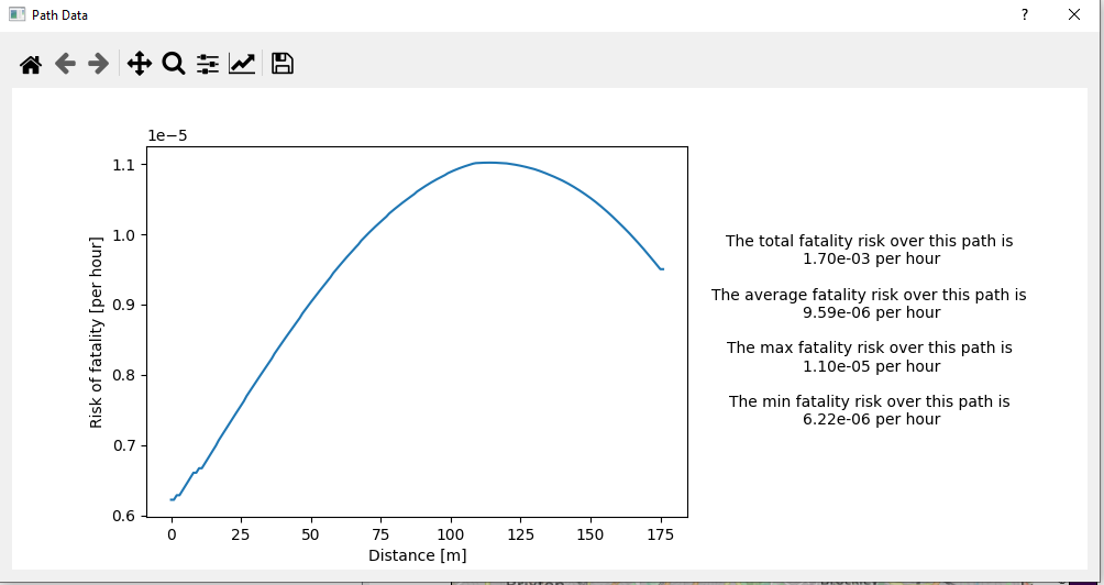

It takes the form of a translucent colour-mapped layer that can be placed over the original map. There is an example shown below. The main aim for me is to get that risk map displayed along with some statistics about the journey. If a UAV’s track can be produced on this system (I am new to QGroundControl!) then that GEOjson file can be put in and a “risk per hour” calculated for that journey.
I’ve attached an image below of a risk map and a path found through London. It also shows a list of statistics about said journey. Obviously the current system is still in production however I would really love to be able to impliment it into QGC!

So the ground risk output shown above is a pixel based graphic, that needs to be overlayed to the map.

**Display Ground Risk Graph and Calculation**
To display the calculation of the ground risk I would just send the coordinates of the planned mission to your server, and send back the risk data as sequence of lon,lat,risk.
A local risk calculation within QGC would only work if you choose Solution 2 above (Overlay risk map in QGC) because then you can access the clean risk tile, and get the risk value from that tile.
