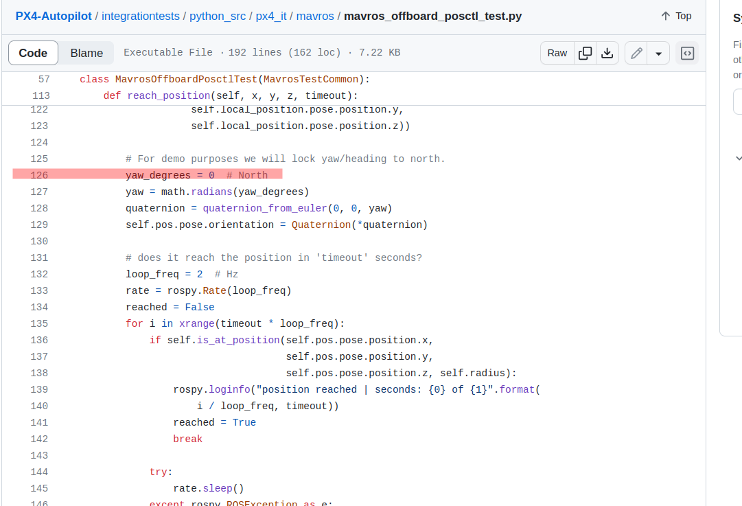

I use the offboard control code ([mavros\_offboard\_posctl\_test.py](https://github.com/PX4/PX4-Autopilot/blob/d1266c856fbd759cbc6cf583c5221aab49962b30/integrationtests/python_src/px4_it/mavros/mavros_offboard_posctl_test.py)) to take off.
In simulation, the drone heads to the positive x-axis.(North).
I can change the heading by changing the line 126. There is no issue.
 ![image](https://discuss.px4.io/uploads/default/original/2X/b/ba079c3cb4e2ee5b9661cd52c1028b5e626355e1.png)
However, in the real world, **the take off motion** only heads to the East.
No matter how I change the line 126, drone will head to East first and then head to the degree which I set.
How to eliminate this redundant behavior?

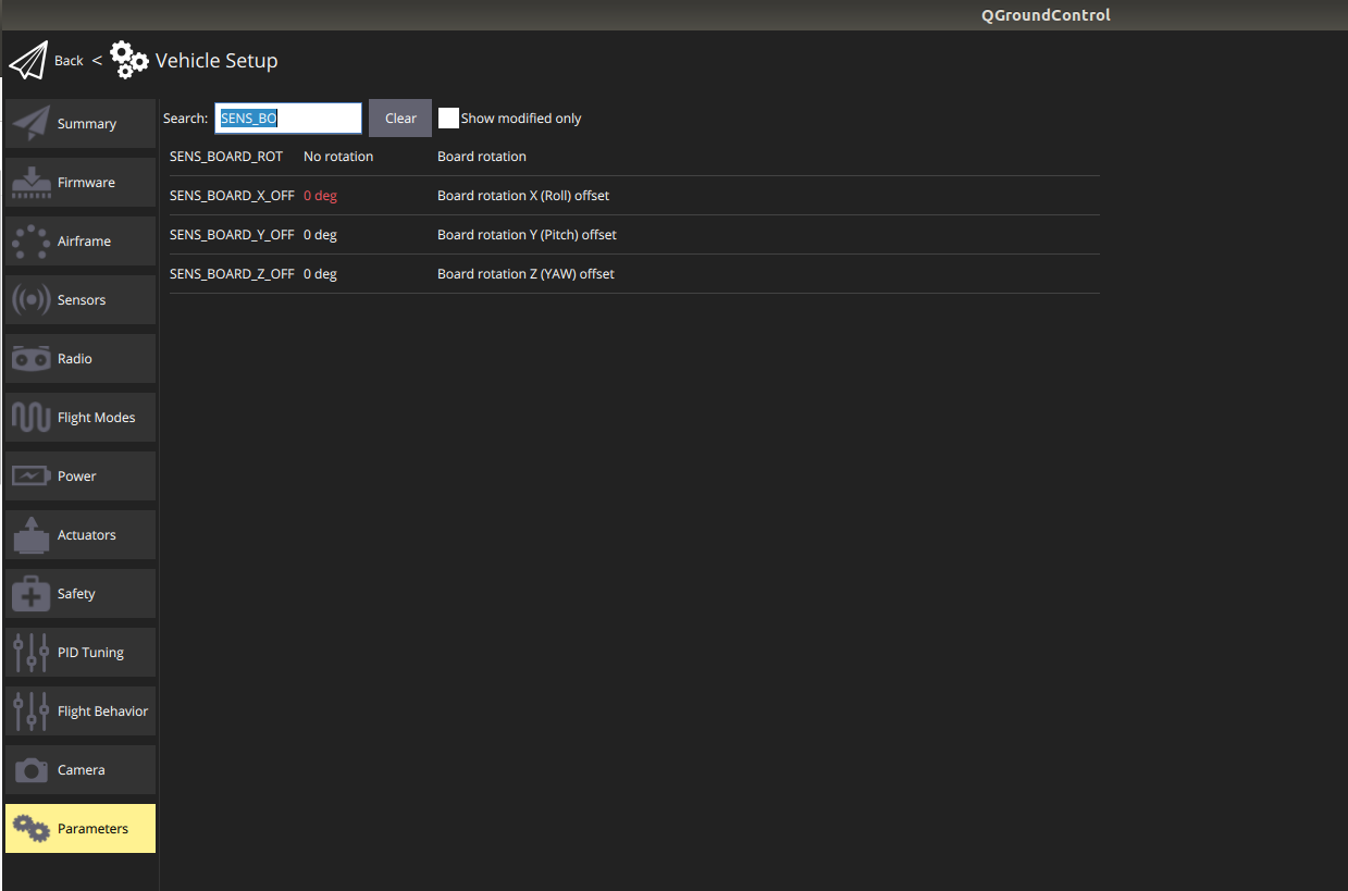

I tried to adjust the **SENS\_BOARD\_ROT** and it create a lot of vibration.
In the simulation, Iris drone even cannot take off, so I am worried to test this parameter in real world.
 ![image](https://discuss.px4.io/uploads/default/original/2X/c/c75967cf204d084f1a608ededc1a9005a04121f2.png)
there are some reference the information:
