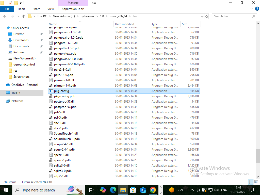

If the system cannot find GStreamer, it will show this error: **missing: PKG\_CONFIG\_EXECUTABLE**.

![Screenshot (79)](https://discuss.px4.io/uploads/default/original/3X/6/f/6f0419a9f59124409d229d7050ec8591733d4e64.png)
this one is present or not in your folder?
**Author:** ![bylla\_anusha](https://discuss.px4.io/user_avatar/discuss.px4.io/bylla_anusha/32/17961_2.png) [@bylla\_anusha](https://discuss.px4.io/u/bylla_anusha)\
**Post date:** [March 13, 2025, 10:24am UTC](https://discuss.px4.io/t/hope-someone-can-help-me-failed-to-compile-qgc-master-on-windows-10-with-qt-6-8-2/44174/13 "2025-03-13T10:24:49Z")
- Apply the Changes:
- Click **OK** in all windows to confirm the changes.
- Make sure to close and reopen any command prompt or terminal windows for the changes to take effect.
- **Verify the Update:**
- Open a **Command Prompt** and run the command:
pkg-config --version
You should see the version number, confirming that `pkg-config` is correctly set up. clean and rebuild.
After ensuring that `pkg-config` is available and configured correctly, try running your CMake build again. If the issue was related to `pkg-config` not being found, it should now be resolved.
